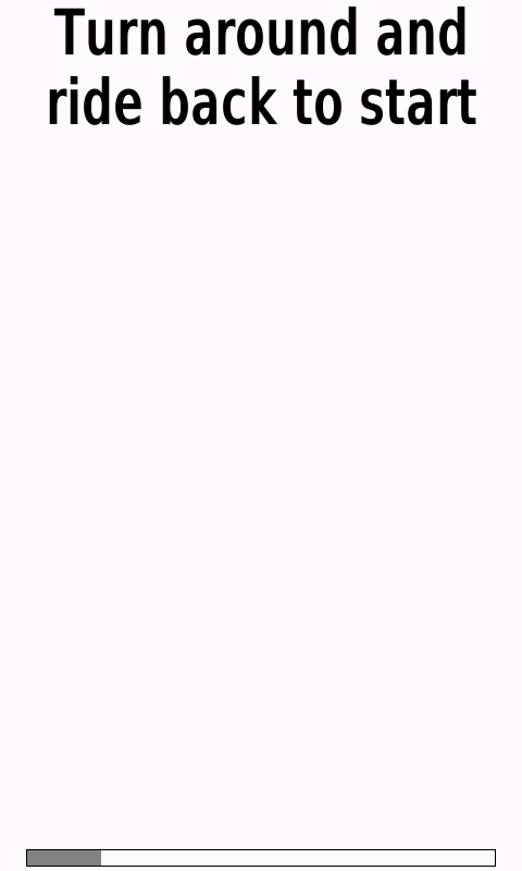

Here's what it should look like (according to Garmin's simulator - I don't have a real Edge-1050 to try it on):
Clearly there's plenty of space for a bigger bar, so I'll tweak things to increase the size on bigger screens - but I'm guessing it doesn't look like this on the actual device.
Can you send a picture? No need to force a cal ride, just a picture of the "searching" screen will do since the bar is identical in both cases. So just turn on the Edge when the AeroPod is turned off, and it should show you a screen with "Searching" at the top, and the bar at the bottom.

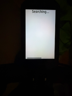

I just fired up the Garmin and opened the screen for the AP/IQ.
See attached. I have not run the calibrate as you suggested just the search is showing and the bar progresses across the Botton while doing the search
What happens after the AP is found might be a different story and where the sizing shifts around. Maybe this is some software auto format or auto-size phenomena?

- Picture - 1.png (97.76 KiB) Viewed 16739 times
Re: New Garmin ConnectIQ app for PowerPod and AeroPod
I think it's just that the 1050 has a similar sized screen to the 1030, but much higher resolution, so the bar ends up being much smaller. I'll adjust the bar height based on the screen size.
For the 1050 in full screen mode, the biggest font should work for everything, but I can see that it does in fact use a smaller font for some of the longer messages - even though they fill less than half the screen. I'll see if I can improve the font selection...
Since the instructions have to fit on many different sized screens - from the fr230 up to things like your edge-1050 - I have heuristics that try to pick the largest font that will let the text fit into the given area. So yes, longer messages can end up with smaller font sizes.lorduintah wrote: ↑Sat Apr 04, 2026 3:02 pm And as far as the text - I think is changes font size during the cal ride and changes again at the end of the first 50%.
I just uploaded v1.0.2, which should give more consistent font sizing, and also increases the height of the progress bar on bigger screens.
