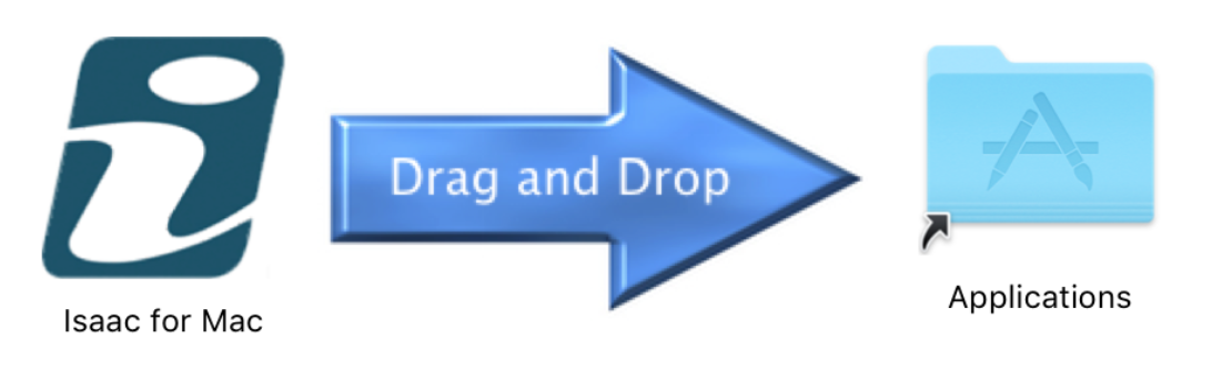

2) Double click on the download. A pop-up window will appear
3) Drag-drop the Isaac for Mac icon into the Applications icon
Screen Shot 2017-04-12 at 6.52.28 AM.png (197.73 KiB) Viewed 13261 times

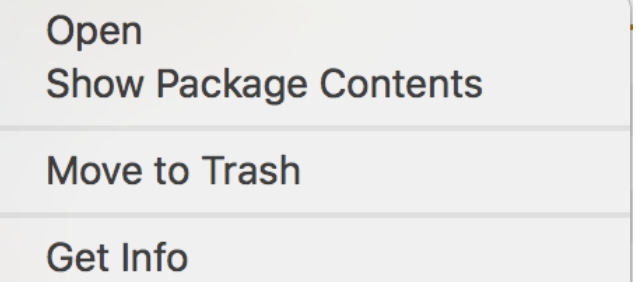

5) HOLD DOWN THE "CONTROL" key on your keyboard, then click on the Isaac icon. A new pop up window will appear
Screen Shot 2017-04-12 at 6.58.19 AM.png (69.55 KiB) Viewed 13261 times
6) Now, move your mouse over the "Open" option. The word "Open" will be highlighted
Screen Shot 2017-04-12 at 6.59.45 AM.png (59.76 KiB) Viewed 13261 times
7) Now, click on "Open" to start the installation process

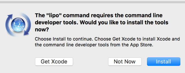

9) If, during your driver install, you see this message, click the "Not Now" button:
Screen Shot 2017-04-12 at 7.06.04 AM.png (91.67 KiB) Viewed 13261 times
