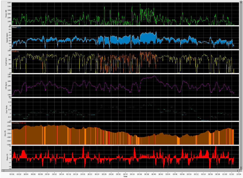

Here is the file, have a look at 24 to 39 minutes, this was riding north west into a north/north west 5-8kph wind.
Re: Analyze Wind?
1) Until minute 24 you were riding solo. Your ride file indicates a small tail wind; if this is incorrect you might want to do a new calibration rideWobblydrow wrote: ↑Thu Aug 01, 2019 6:01 am iBike_07_30_2019_0534_30_km.ibr
2) From minute 24-41 you were in a peloton. Wind speed was less than bike speed.
3) Even when drafting the total opposing wind speed is greater than zero. I graph total wind speed (as opposed to ground wind speed).
4) Yes, in calm ground wind conditions the blue wind speed should hover around white bike speed.

So when drafting and the wind effect comparison is used, and shows (say) net minus 25, it doesn't mean a 25 kph tailwind, it means the bike has an effective net benefit equivalent to 25kph tailwind.
I guess I wanted to know how to read that wind effect comparison correctily
Re: Analyze Wind?
Correct.Wobblydrow wrote: ↑Thu Aug 01, 2019 6:01 pm So when drafting and the wind effect comparison is used, and shows (say) net minus 25, it doesn't mean a 25 kph tailwind, it means the bike has an effective net benefit equivalent to 25kph tailwind.
