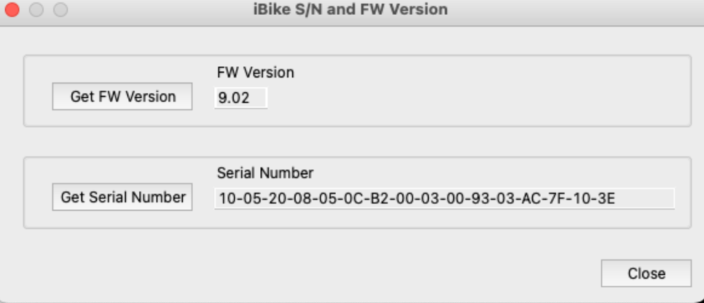

I did not see any attachments to your original posting.
Connect your unit to Isaac, and go to Device/SN an FW version...
Post a screen shot of the response

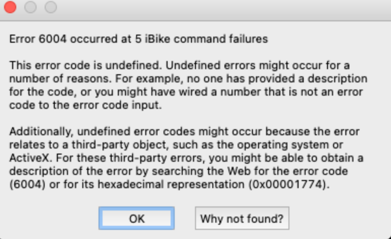

Re: Intel Mac Users: how to install Isaac 5.1 macOS Catalina, Monterey, Big Sur, and earlier
Posted: Sun Mar 05, 2023 2:10 pm
by Slickwhite
Apologies and thanks for responding so quickly
Screenshot of the error message and device /SN and FW version attached
Screenshot 2023-03-05 at 19.04.39.png (127.98 KiB) Viewed 127493 times
Screenshot 2023-03-05 at 19.05.05.png (60.55 KiB) Viewed 127493 times
Kind regards,
David.
Posted: Mon Mar 06, 2023 11:22 am
Slickwhite wrote: Sun Mar 05, 2023 2:10 pm Hi John,
Screenshot of the error message and device /SN and FW version attachedScreenshot 2023-03-05 at 19.04.39.pngScreenshot 2023-03-05 at 19.05.05.png
Kind regards,
David.
Use the command Device/Erase All Ride files to get rid of the files stored in your PP.
Do a new, short ride, and try downloading it. Let me know if that works.

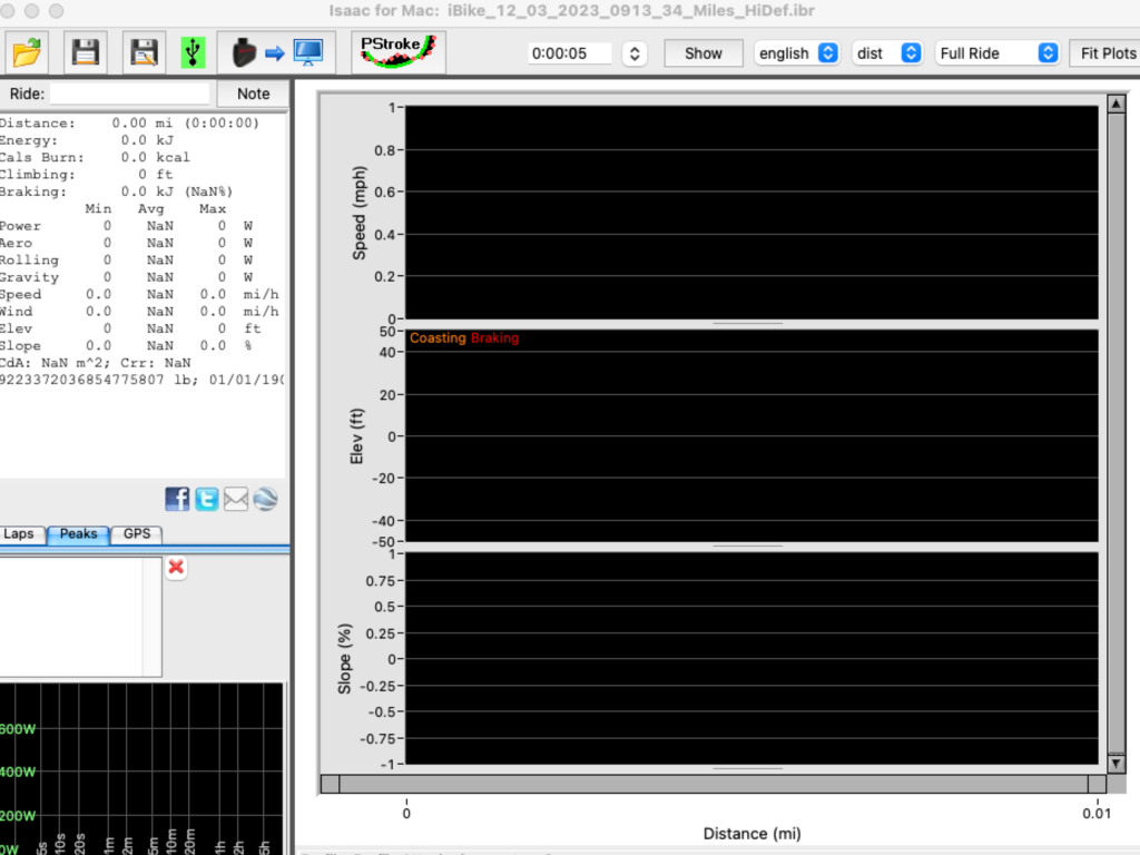

I did as instructed and performed a hard reset. After my ride I attempted to download the ride file and the error 6004 reoccured. I then tried to download the ride manually. The ride starts to download but s briefly flashes up the download window before disappearing. The ride appears as attached.
Screenshot 2023-03-12 at 17.13.09.png (153.74 KiB) Viewed 127339 times
I decided to downloaded Isaac for windows and downloaded Parallels and went for another ride. The ride downloaded without an issue. Not sure what's going on but a least it works with the windows version of Isaac.
