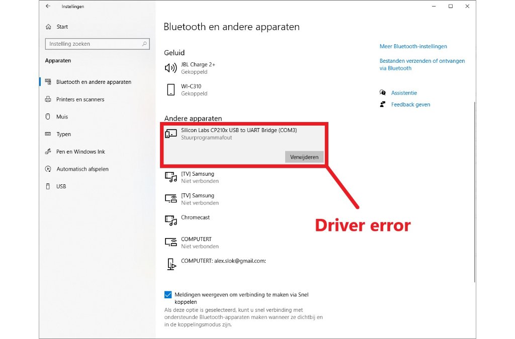

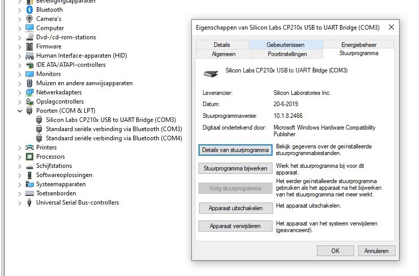

I have the same problem as the topic starter, but on a Windows 10 machine with Isaac 5.1.0. It looks like there is a problem with the SiLabs drivers. I made some screenshots (text on the pics is in Dutch).

I solved the issue myself. It seemed that Bluetooth devices on my system confiscated the COM ports that Isaac wanted to use. It may just be a workaround, but I disabled Bluetooth for the time working with Isaac and enabled it afterwards.
