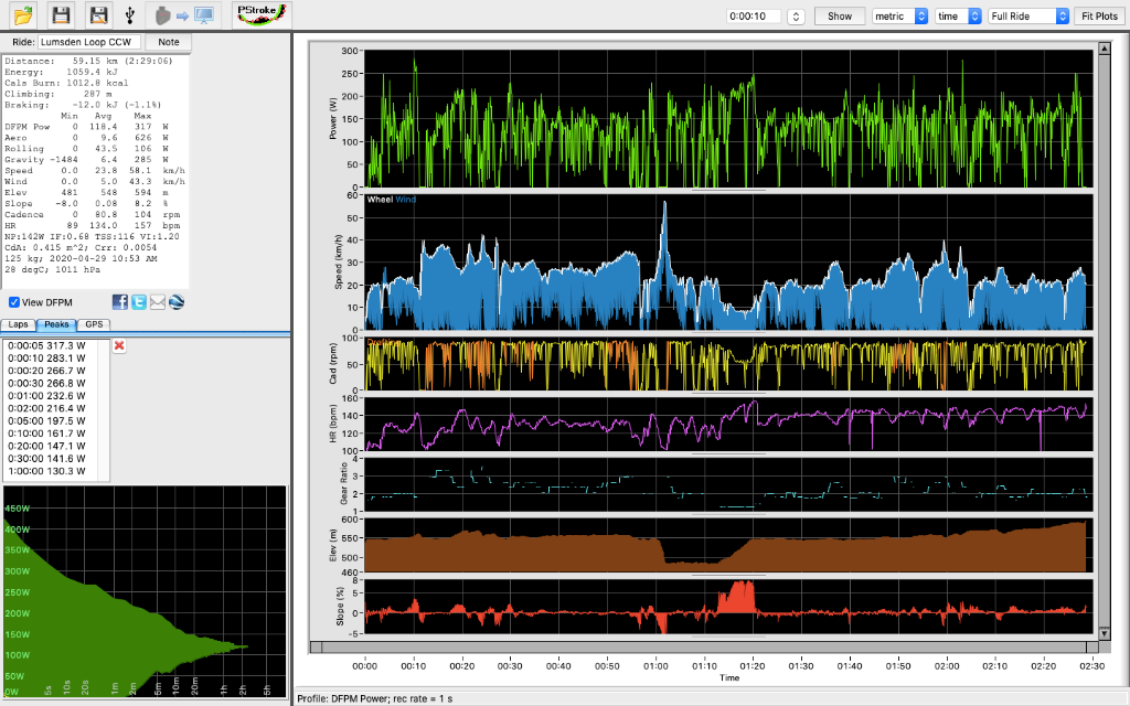

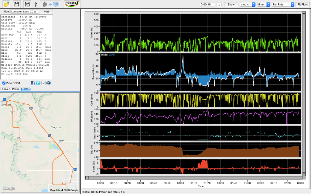

After all these years, I still have the "icicles" problem with my iBike Pro, i.e. wind graph always showing a tailwind when the actual ride is a tailwind/crosswind/headwind situation. Utilizing "Analize Route", I can usually correct it and bring my average power within 10-15 watts of my Stages DFPM. The same was true when I had access to a Powertap wheel. The iBike calculated watts measurably different no matter what I did with my Profile(s). I borrowed a much later generation Newton and experienced the same thing. The only way I could get a precise and consistent watt measurement out of the two iBike head units was to use the "Check Calibration" feature on an out-and-back ride and use my DFPM(s) as the reference for my Profile(s).
Whether or not the aforementioned problem on the Gen 3 iBike Pro is a blocked wind sensor or internal instrument error - I do not know.

BruceK wrote: Fri May 01, 2020 1:36 pm my Profile(s).
Your wind sensor data is wacky. Analyze Route tries to approximate the wind speed, which is what brings your watts closer.
Your unit is almost 10 years old and has original-generation analog sensors in it. It's impossible to tell what is going on with your particular unit, but most definitely it will not function well if wind readings are not correct.
