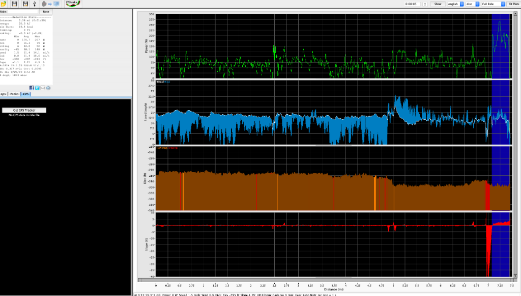

Attached is a ride ending at a high power after having hit a bump in the road.

Yes, what you are seeing is the effect of the suspension on power readings. When you hit a bump your PP momentarily is knocked out of its usual position, causing power changes.
The best way to minimize this problem is to lock-out your suspension.
If you are using your ride files for training purposes, after the ride you can highlight the "bumps" and remove them from the ride file:

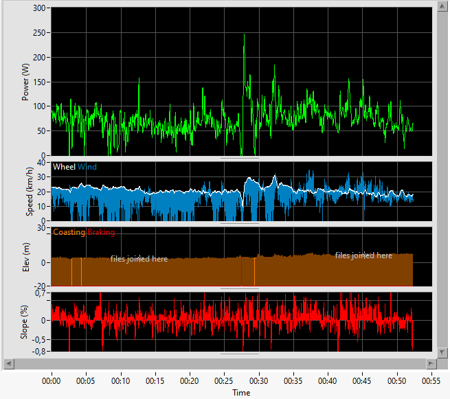

After deleting the 4 most spurious peaks from todays ride, I now more clearly see a remaining odd power peak when breaking at 27 minutes.
Is it my real acceleration in this case?
I suspect it comes from the suspension generated semi-slope values too.
If so, the Powerpod seems being of no practical use to me as fitted to my handle bar.
Re: high power at road bumps
Nope, that is a real power spike, caused by you accelerating from 10 to 30 km/h.

jonao wrote: Sat Aug 24, 2019 2:38 pm today's ride iBike_08_24_2019_1146_34_km.ibr
Your unit is not calibrated; you have a default value of wind correction in your ride file. Load the attached profile into your device.
I deleted the first 5 minutes of your ride, then used a trick to fix your calibration: the "Analyze/Analyze Route" command.
After applying the Analyze Route command it's obvious where your position changed.
Screen Shot 2019-08-24 at 3.52.43 PM.png (150.71 KiB) Viewed 331012 times
I deleted 3 small sections, each about 4 minutes long. You have plenty of data for your training analysis!
Screen Shot 2019-08-24 at 3.56.26 PM.png (167.02 KiB) Viewed 331011 times
