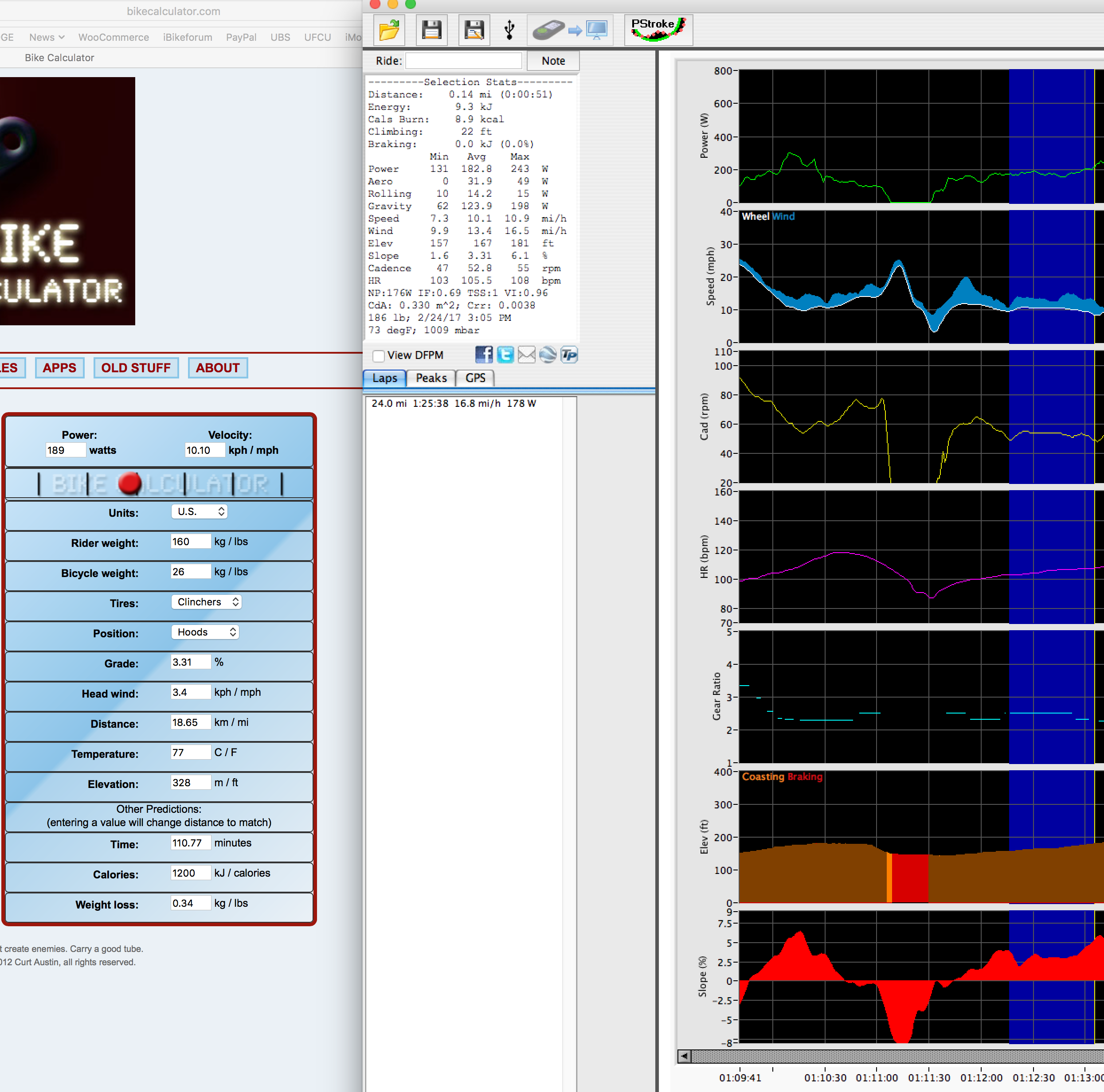

1) Hill climb, time 1:12:30. Slope 3.31%, bike speed 10.1 mph, headwind 3.4 mph, rider weight 186 pounds. On hills, gravity watts dominate. If bike/rider weight is correct, then Newton watts should be solid. PT: 148.9, Newton reading: 182.8, bikecalculator: 189W. Newton is correct.
Climb PT
Climb PT
Climb Newton
Climb Newton

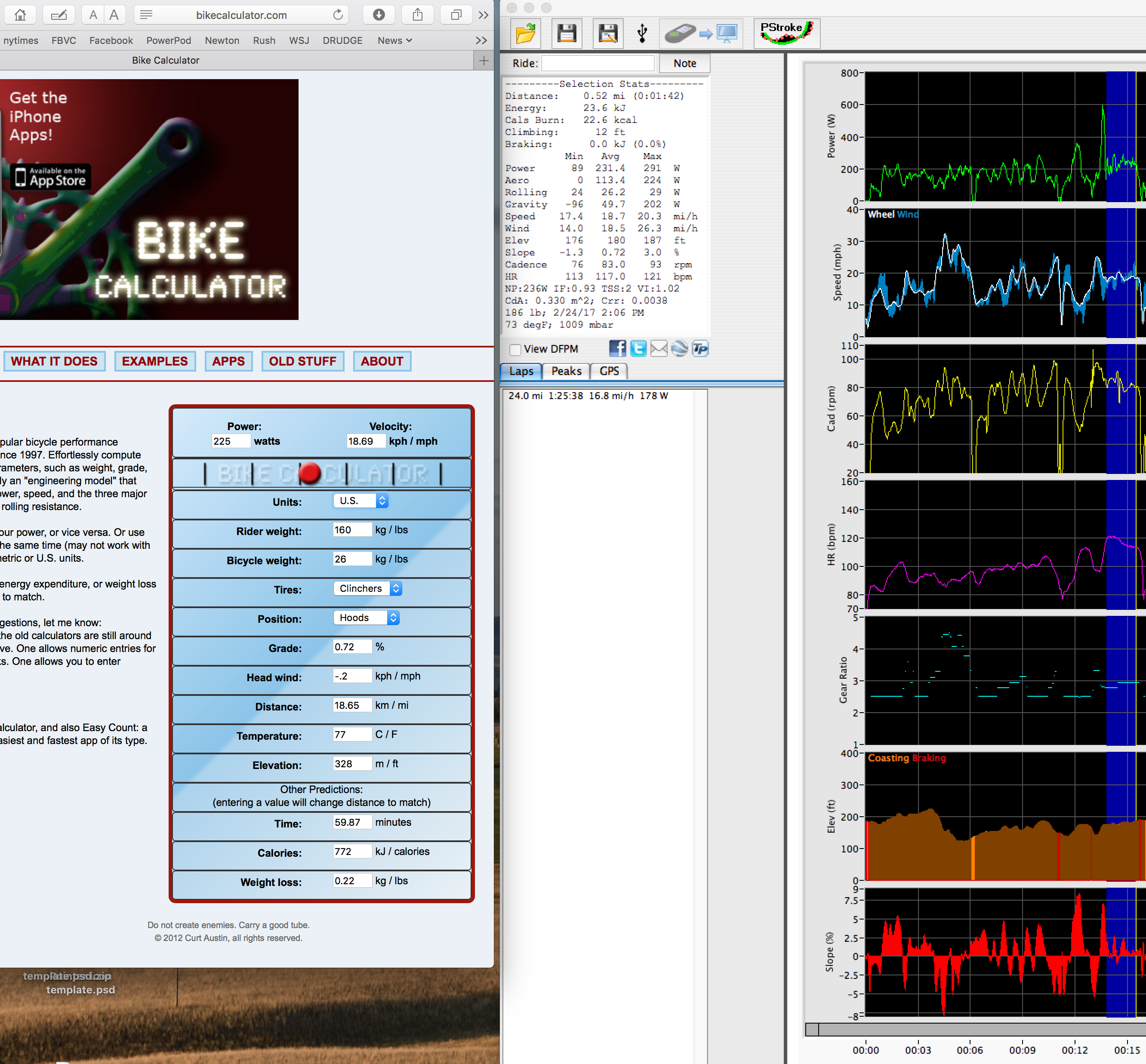

2) Flats. I picked a 1 min 42 segment around the 15 minute mark: 0.72% slope (pretty flat), bike speed 18.7 mph, wind speed -0.2 mph. In this section, wind force dominates. If wind speed and CdA are correct, then Newton watts should be solid. PT: 157.5W. Newton: 231.4W. Bikecalculator: 225W. Newton is correct.
Flats PT
Flats PT
Flats Newton
Flats Newton

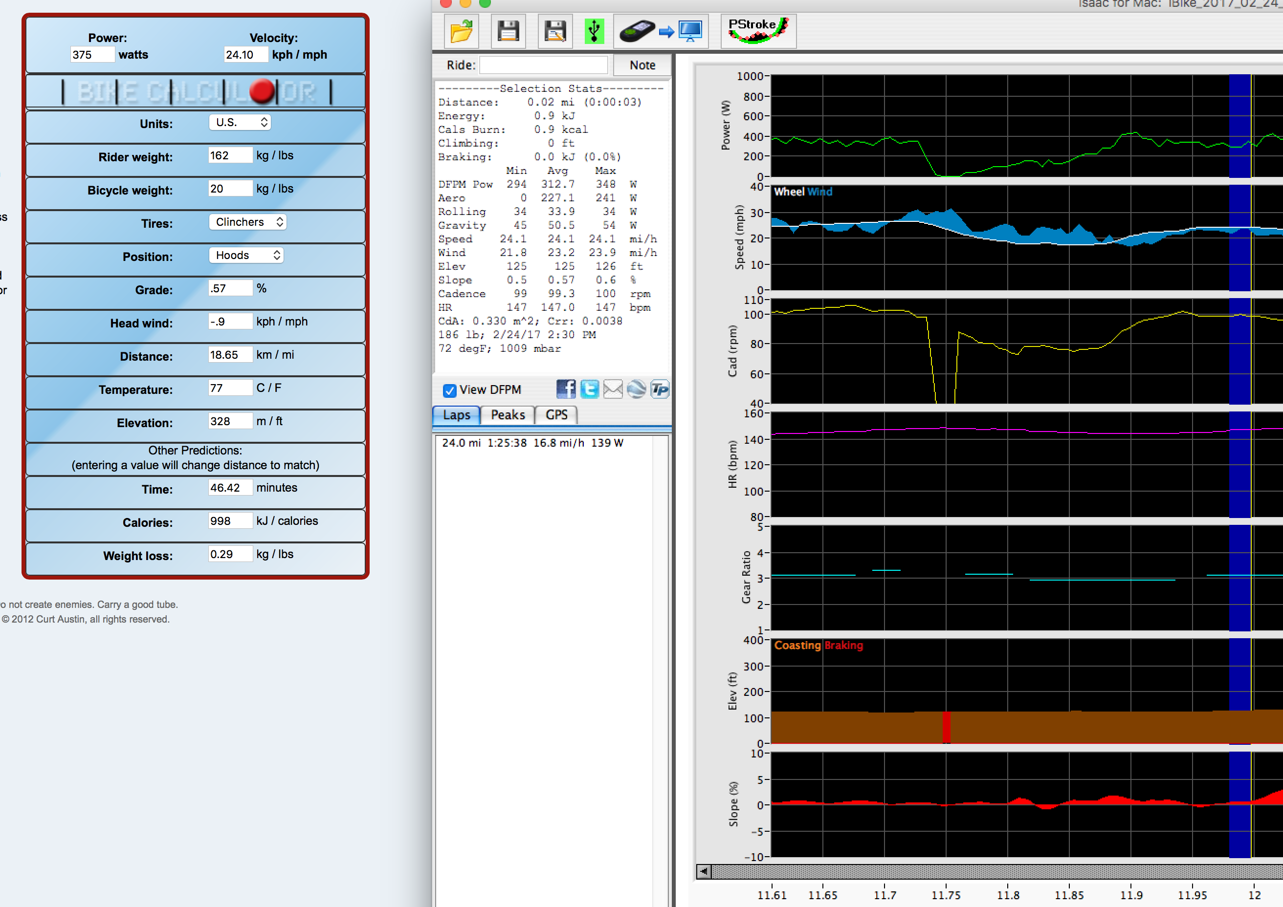

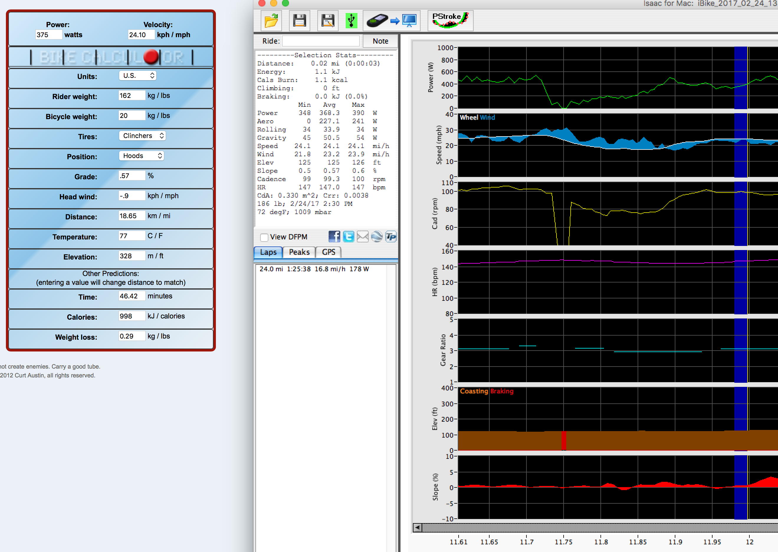

3) Sprint. This is where both acceleration and wind are important. I picked the second sprint, around mile 12. Bike speed 24.2 mph, wind speed -0.9 mph, slope 0.57%. PT: 312W. Newton 368W, bikecalculator 375W. Newton is correct
Sprint PT
Sprint PT

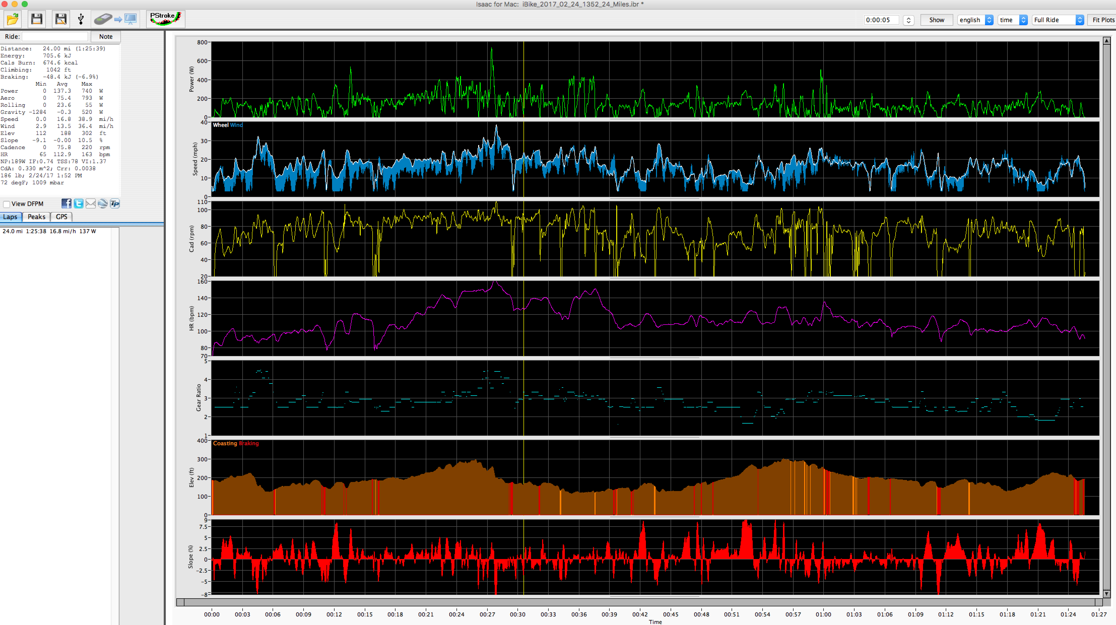

Another way to "bludgeon" the Newton data to fit the PT is to lower the net wind speed. This drives down watts. I found that if the average wind speed for the ride was -3.5 mph, then the overall watts were close. But then, the ride file wind looks "funny" and doesn't seem possible. And note that, with this wind measurement adjustment, on the hills the Newton still reads high (accelerometer measurements dominate).
Ride file with artificially adjusted wind speed
Screen Shot 2017-02-25 at 7.30.01 AM.png (955.51 KiB) Viewed 39272 times
In sum, I don't find any reason to question the validity of the Newton measurements. I strongly suspect that the PT was out of calibration for this particular ride.
