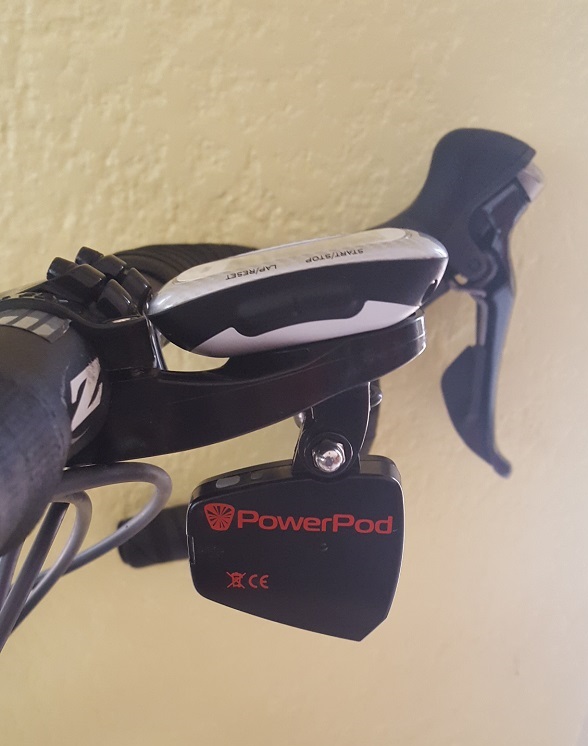

One concern though: I'm using profile 2 and I noticed that the wind scaling is set at 1.240 for the out-front mount; is that right? I've read here that it supposed to be 1.7
I'm also using my own mount which doesn't extend out as much (my head unit is a Garmin Edge 500) Is that the correct wind scaling? Sorry, but total noob here, just started using the PP.
I've attached my latest ride for your info (and if you can take a look and see if the numbers are all in order).
Pretty impressed, so far.

Re: Wind Scaling
Was this a group ride or a solo ride?
If a group ride, please do a short out and back solo ride.

Re: Wind Scaling
I used the command Analyze/Check Calibration... to correct your profile.
Load this profile into your PowerPod and you'll get much more accurate readings.
- powertothepeople.ibp
- (507 Bytes) Downloaded 325 times
