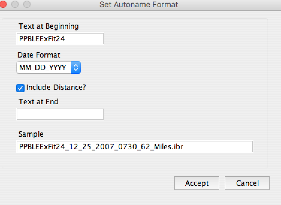

One final question regarding dates. Is it possible to change the format of the date used to create the file names? I'd like to use the more logical Japanese dating system YYYY_MM_DD, which has two major benefits: numerical sorting really works, and no ambiguity about months and days confusion between US and UK/Euuropean date formats - 01_04 1st April or 4th January?

Yes, you can do this. In Isaac go to Edit/Edit Preferences/Ride Data/Autoname Format/Date Format. Select the naming format you want!JayAy wrote:Thanks for the suggestion. Your comments got me sorted out. For whatever reason the date stamp was 01_12_2017, but I found the ride.

- Screen Shot 2017-05-12 at 1.22.27 PM.png (47.34 KiB) Viewed 4607 times

Ah just found the autoname format options on the donwnload ride data dialog.
All sorted.
