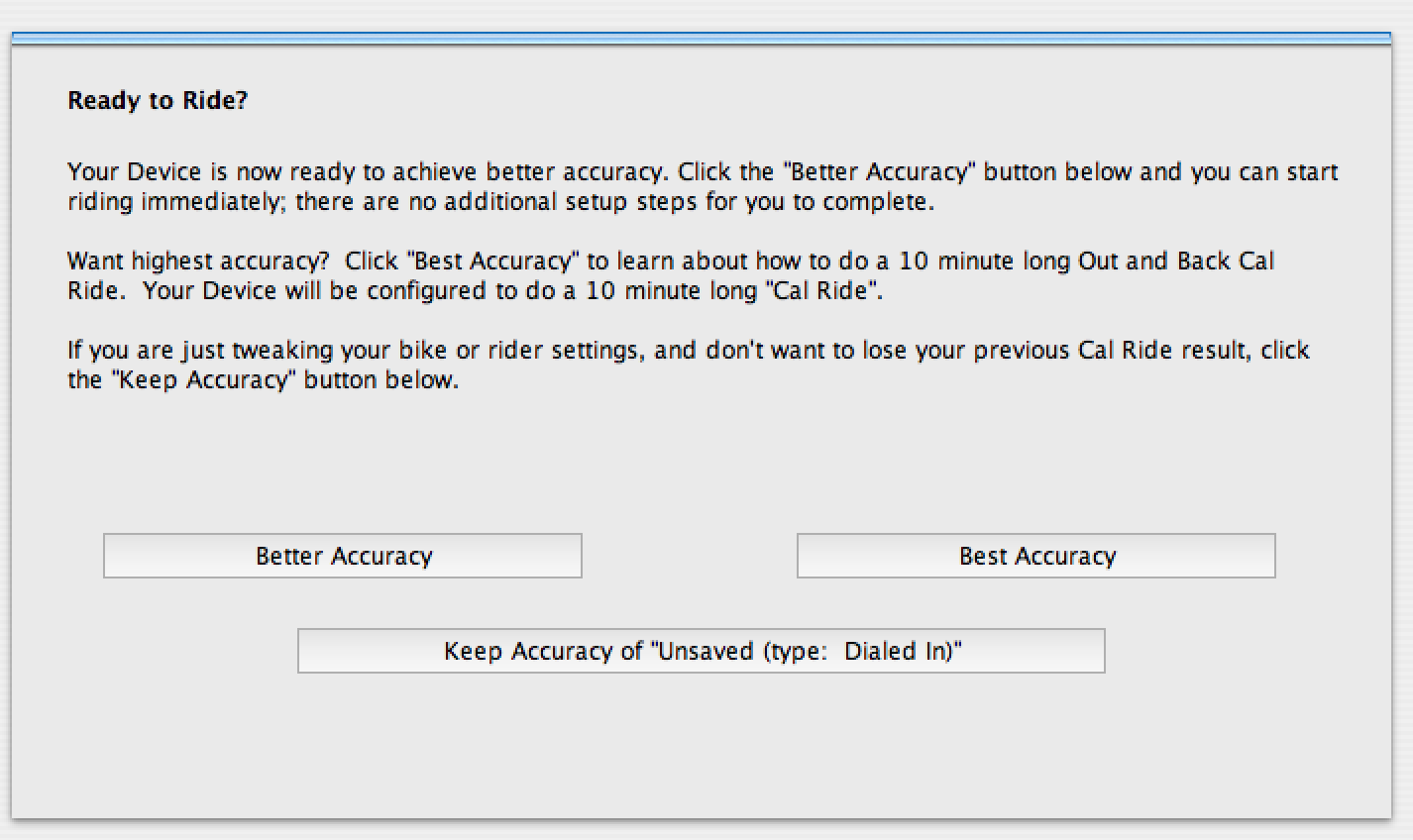

You don't have to do a new O&B ride, but you should use the "Device/Setup Device" feature in Isaac to adjust your weight.
Make sure that, when you come to the last screen of the Setup Device wizard, you select the "Keep Accuracy of..." button.

One little confussion when setting this up using the "Keep Accuracy of..."
At the beginning of the Step I am asked to choose which of the 4 slots I can get to save the profile. I noticed that if I pick my latest calibration (option 3 at moment) vs using the "unsaved" slot that the Wind Scaling varies alot. When picking the latest "non unsaved" slot which is Calibration 3, my wind scaling values transfers over which i assume is the correct one?
In any case please let me know which of the 4 slots should be used? Thanks
And from your screenshot. how do i get "Dialed In"?

When you are editing a profile, the profile that is currently in use by PP is the one that will be modified. For example, it sounds like you're using profile 3 currently. So, when you edit profile 3, at the very end you'll " Keep Accuracy of..." profile 3 (the result of your Cal Ride), but update other factors that you entered (such as weight).
