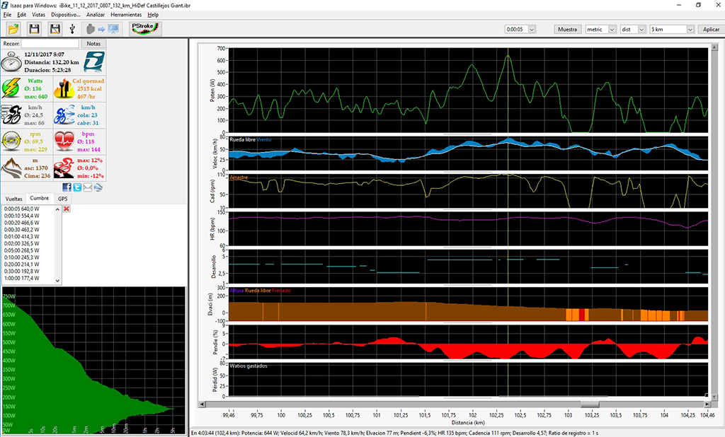

They continue to appear excessive peaks of power on negative slopes, which do not correspond to the strength in the pedals. In those cases it always shows wind readings that seem excessive to me, as it appears in the catches. Could it be a problem with the wind sensor hardware?

- iBike_11_12_2017_0807_132_km_HiDef Castillejos Giant.ibr
- (2.13 MiB) Downloaded 331 times
- Powerpod.jpg (362.48 KiB) Viewed 5187 times

Nothing is wrong with your PP sensors, and your unit appears to be properly calibrated, except that your Crr is a bit high. A corrected profile is attached.
Your CdA suggests you are riding in the drops; is this correct?
When pedaling on downhills, the PP is VERY sensitive to rider position. Any variation from normal ride position, (for example, going in to a tuck to pick up more speed on the downhill) will be reported by PP as higher watts.
I agree with you that excessively high wind speeds could also cause a problem, but this is a long course, and overall your wind speed is close to your bike speed. I don't think your unit is calibrated improperly.

Most of the time I go in the hoods. What value of Cda would be appropriate? It is currently at 0.310. I measure 1,72 cm and weight 70 kg.
I use the Crr value corresponding to the "Tire grade: Utility" Should it be lower?

What I do not understand why the Powerpod increases watts when switching from hoods to drops ... Should not the watts decrease as the position is more aerodynamic?

The more aerodynamic you are, the faster you will go for a given amount of applied power. But PP doesn't know you're more aerodynamic; it only knows you ride faster when you move from the hoods to the drops. Where does that extra speed come from? PP believes you haven't changed ride positions, so it attributes the extra speed to more power.bfermar wrote:What I do not understand why the Powerpod increases watts when switching from hoods to drops ... Should not the watts decrease as the position is more aerodynamic?

Ok, understood, but what values of Cda should I use?
I lowered it somewhat looking for better response on the negative slopes, but my normal position is on the hoods.
It seems that decreasing the value of Cda does not help in the downs, by the way of working of the PP
0,340 in hoods is ok? It is the value Isaac assigns by default for my height and my weight in hoods

Use the value of CdA that is determined by the "Device/Device Setup" wizard.
