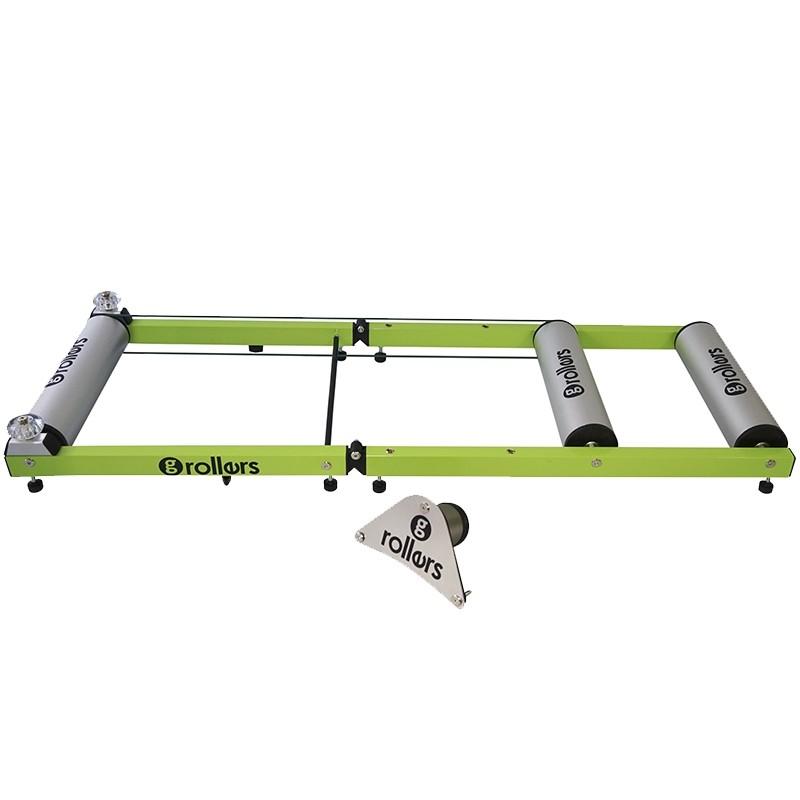

I started an indoor training and i realized that the power is very high, so, i want to know what can i do for calibrate or adjust the power pod for my rollers.
I use a rollers for a company call og rollers

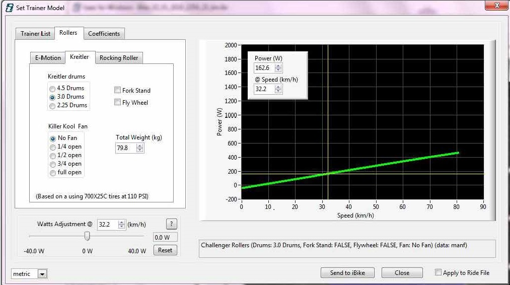

I don´t saw wich trainier profile i used, but yesterday i made a test, i modified the setting of the trainer profile and now shows some betters numbers, but i still don´t know if these are correct.
I use the next settings.
I also attach the ibr file
iBike_02_01_2018_2254_25_km Test indoor rollers.ibr
(68.27 KiB) Downloaded 290 times
Re: Indoor train with rollers - power very high
Yikes! You ride at 30 mph on rollers!!! You are a brave cyclist!!!!
The ride file looks fine otherwise...

Well, I think I'll continue with that trainer profile, just one thing, the Total Weight (kg) is my weight + the bike? Or only my Weight?
