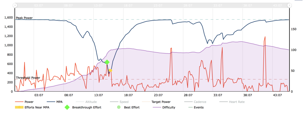

Yes, my Garmin Edge 520 syncs with Garmin Connect which then syncs with Xert, Strava, and Trainingpeaks (dropping Trainingpeaks when subscription runs out). Really love Xert. The amount of analytics and predictability is fantastic. I have attached a screen shot from a recent ride. You see how my maximum power declines until no more is left in the tank. I use it for training and racing.
Morten

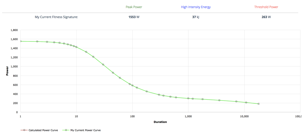

And here is my latest power duration curve.
Morten

Re: 5s power
John,
So, what do you think? What type of power averaging would work best for PowerPod, Edge 520 and Xert?
Morten
Morten
Re: 5s power
It looks like Xert is analyzing your files for various levels of power, at various levels of time effort.
If that is the case I'd set PP to 3 second averaging or less. You will likely see jumpier numbers on your Garmin (more difficult to hold interval levels) but the data going into Xert will be processed less.
