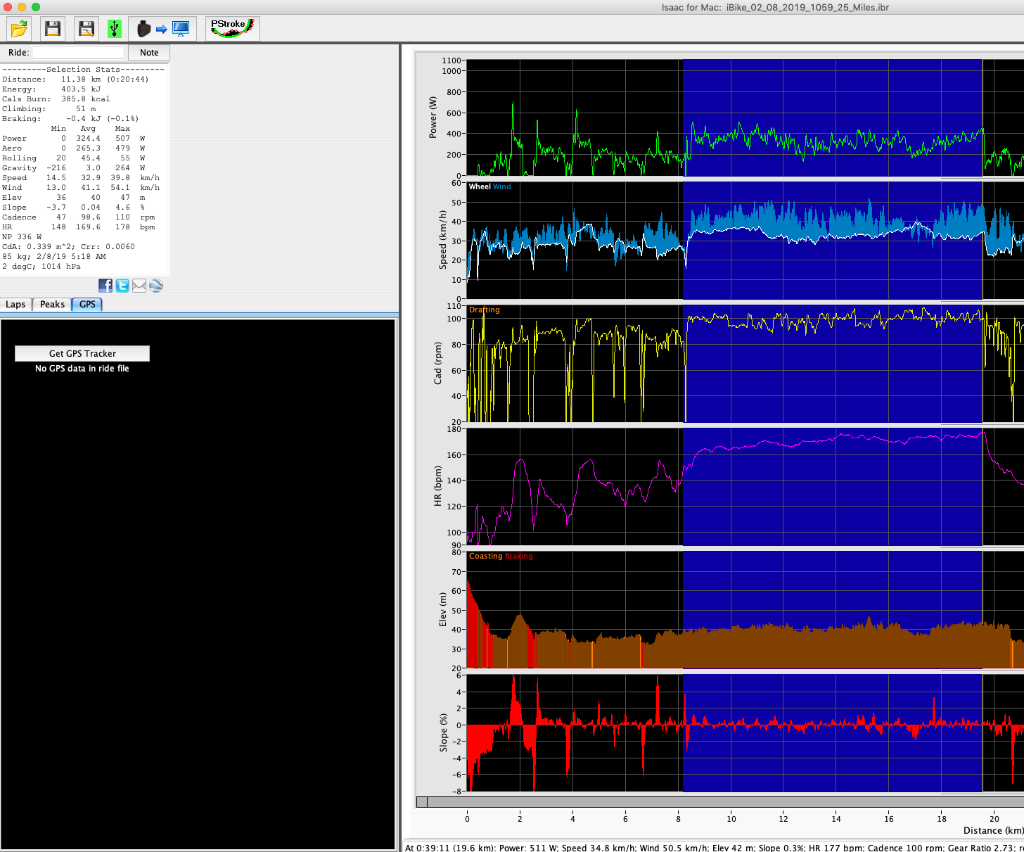

So I've done a 20-minute test, but the wind came a bit more form the side then expected. The wattage-data doesn't look really goed in my opinion since it's fluctuating a lot and I had the feeling my power was pretty constant, but the outcome looks pretty good and in line with my performance and what i expected. Hope you can shed some more light on it, I added the file.

Welcome to the world of power measurement! Power is a much more sensitive measurement than HR, bike speed, or any other factor.
In fact, your power was NOT constant during the test: even though your route was pretty level, you actually fluctuated in bike speed during the ride. Wind conditions changed, too, near the end (drafting?). Both are enough to affect significantly your moment to moment power.
So, while your HR was constant, your power actually moved around some.
But your result is fine!

Thanks for your answer! Like I said there were pretty heavy winds, mostly crosswinds, about bft 4/5. The 'drafting' part is just riding into a small village and having shelter from the wind. I am riding with the powerpod for a while now, but had it fixed during the summer and just starting training with it again. Like I said, I felt my power was pretty consistent throughout, not like it was fluctuating between 180 en 500 watts.
Since the road wasn't completely straight but meandering a bit, could it be that the different angle of the wind had an effect on what the powerpod shows? This is my Strava activity, you can see where I did the test in analysis. the wind was SSW.
https://www.strava.com/activities/2131986328
Re: Powerpod issue wind
Your HR also "meanders" in pretty much the same way...but not as much, because it is not as responsive.
I really think you are OK. It is extremely easy to get short (and significant) changes in power. This can be accelerations, wind gusts, gear changes, elevation/slope changes, and more.
At mile 8 you had a cadence spike. It looks like you changed gears. This caused a 600W spike. I would ignore that

Golden Cheetah gave you a CP(1hr) of 312W, that is pretty much equal to FTP. That is a pretty beastly FTP. If that is what you expected, you are good to go. That would put you as a Cat 2 racer per your FTP/Kg.
p.s. Change the smoothing to 30s in the profile or on your garmin, and you won't see the gnarly spikes.
