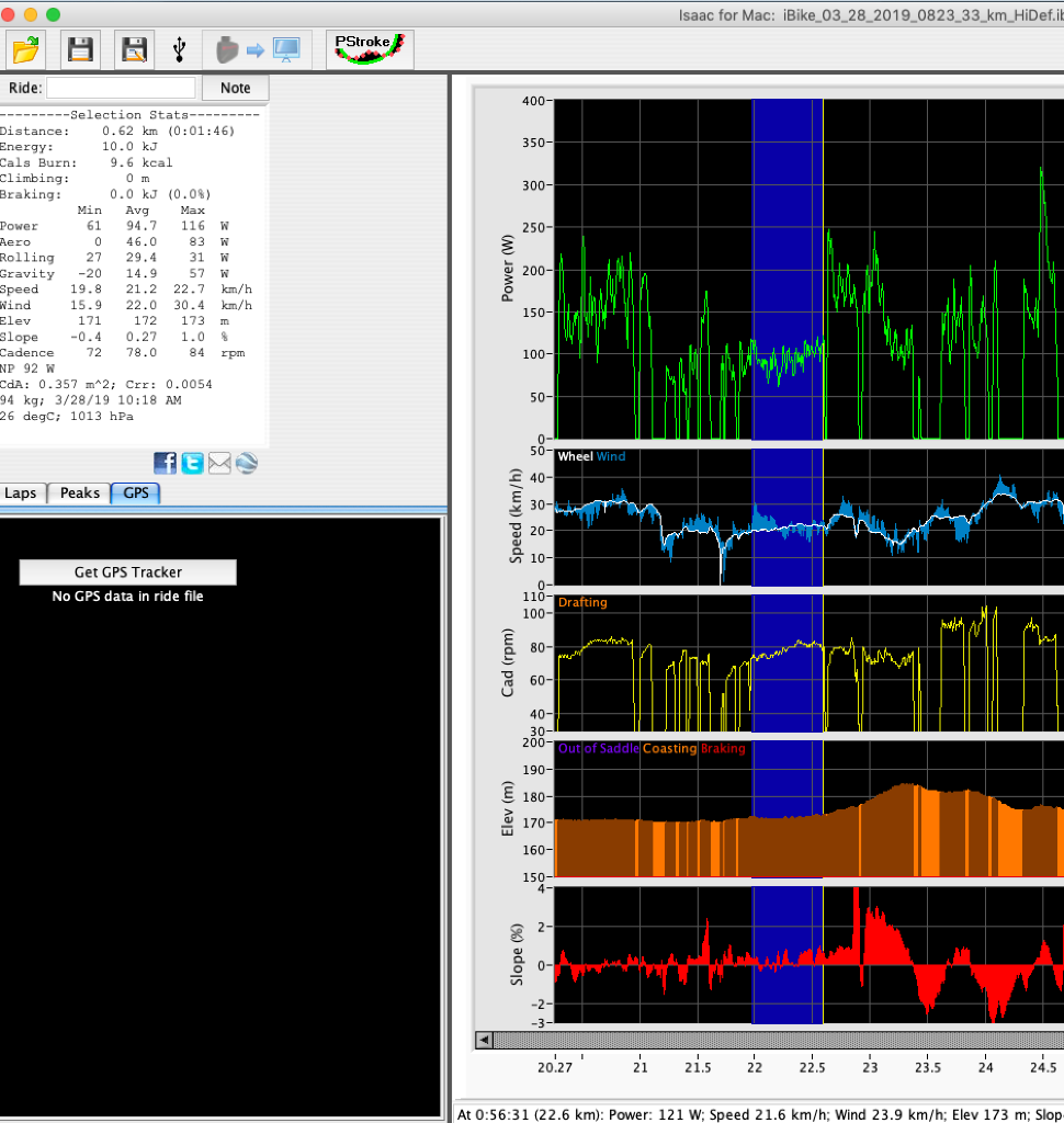

Not sure the powerpod is reading right. Can you look at this file? I am quite impressed when doing over 50kph at 50 watts

I think your unit is working just fine.
Your low power is a result of a lot of cadence changes (zero cadence).

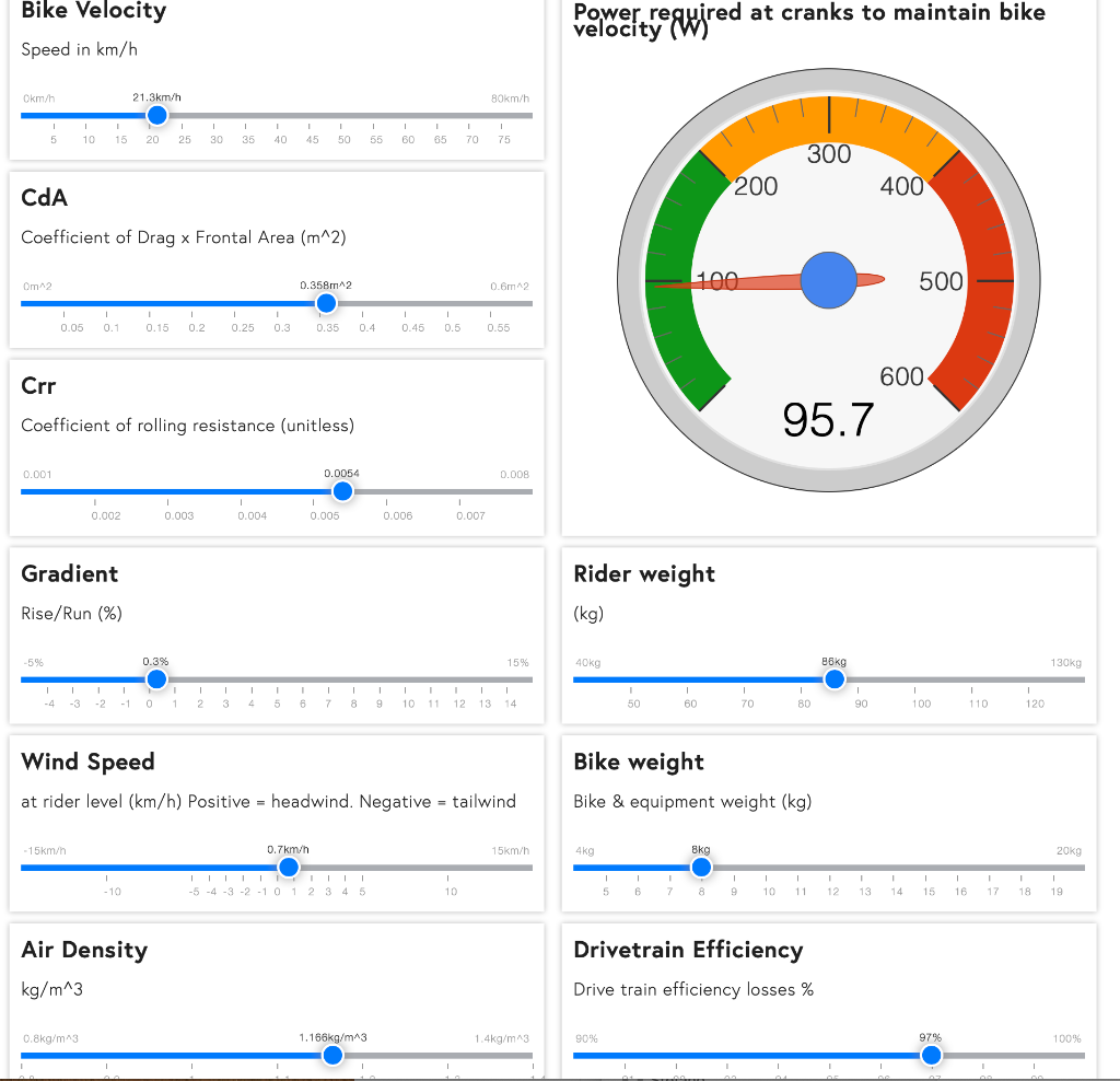

I picked a place in your ride file where I thought power might be low. I checked this against the aerocoach website.
The values are the same...
Screen Shot 2019-03-28 at 5.00.18 PM.png (181.08 KiB) Viewed 1889 times
Screen Shot 2019-03-28 at 5.02.20 PM.png (180.81 KiB) Viewed 1889 times
