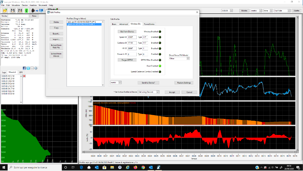

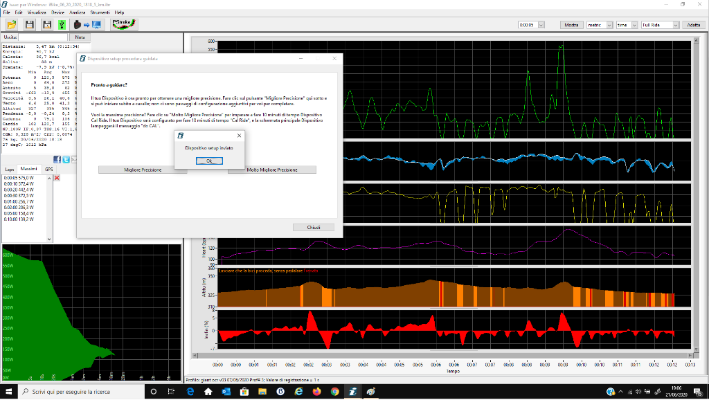

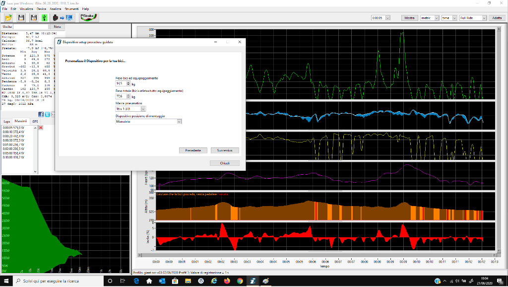

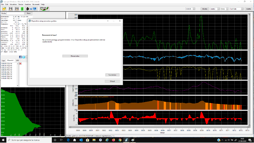

Second part

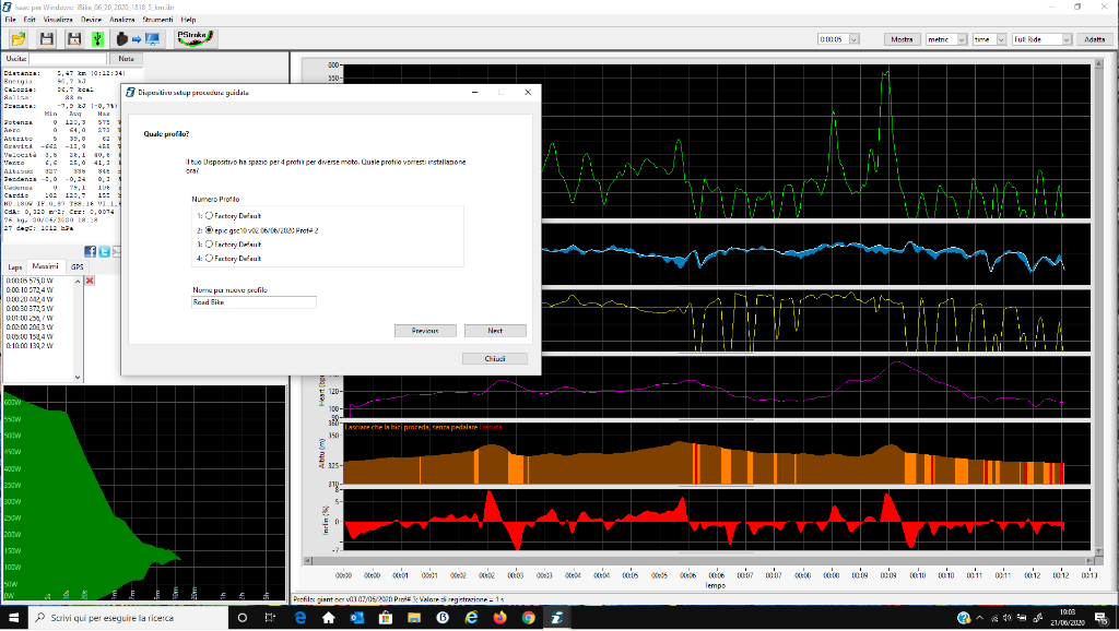

- _04 DEVICESETUP.png (154.35 KiB) Viewed 20232 times
- _05 NEWPROFILE.png (160.4 KiB) Viewed 20232 times
- _06 DEVICE SETUP2.png (149.58 KiB) Viewed 20232 times
Re: Excessive speeds causing too high powers?
However, I created the new profile, which I attach together with the last image, although of course I will not use it.
- Prof #1 20200621.ibp
- (372 Bytes) Downloaded 535 times
- _07 SETUPDEVICE3.png (159.02 KiB) Viewed 20232 times

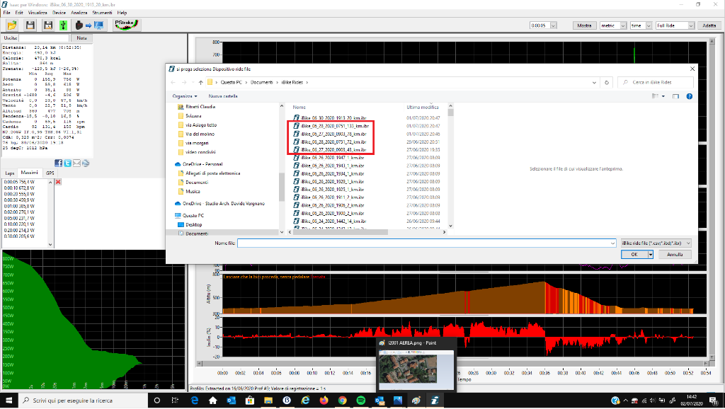

Hello John,
I'll update you on the situation. Wednesday 24 was holiday for us and I went out with the mountain bike, together with my wife (she rides an e-mtb). In order not to bore her with the tests, I only kept profile 2 in the powerpod and we made a normal tour. Everything worked out well. Only towards the end of the tour, I punctured and after the stop the garmin was no longer able to connect with the pp. I redo the search for the sensor and immediately found it. I probably disabled the connection by messing with the garmin's touch screen, while I took it off to turn the bike upside down and remove the wheel, so I didn't worry.
Subsequently, yesterday I tried to perform the tests that you recommended, starting with the road bike. I cleaned up everything in the memory of the pp, reset the profiles and I installed only the two profiles 2 and 3. I immediately noticed a strange thing: profile 3 (giant road bike) had no wireless id enabled (I attach screenshot). Furthermore,when just connected pp signaled me no files to download; after loading the profiles it showed me the files of the 24 (which should have been deleted). However, I left but the garmin did not find the pp, despite trying to turn it off and on several times. Each time, the led flashed green for a while, then turned solid green, finally turned off, as if it had found the sensors, but pp, in addition to not connecting with the garmin, did not record any new ride. Otherwise, today it made me download the files of 24 again, as if they had never actually been downloaded or deleted. Some times ago, I've done the last update of the firmware of the pp, which, I remember, was perhaps for the aeropod..Can it affect? However, I believe that Isaac is not working well. How should I proceed now? I am concerned that the PP no longer connects to the Garmin ... it never happened. All the other sensors were connected, so I don't think garmin is the problem. Do I need to redo sensor pairing, calibration and testing for profile 3? Wouldn't it be better to try to uninstall and reinstall isaac instead of continuing to test? I'm sorry but it's getting a little long, I would like to solve ...
- 14 wirelessID.png (148.31 KiB) Viewed 20186 times
We need to figure out if the problem is in firmware or Isaac.
Please erase all the ride files in your PP, then do the experiments described in the earlier posting.

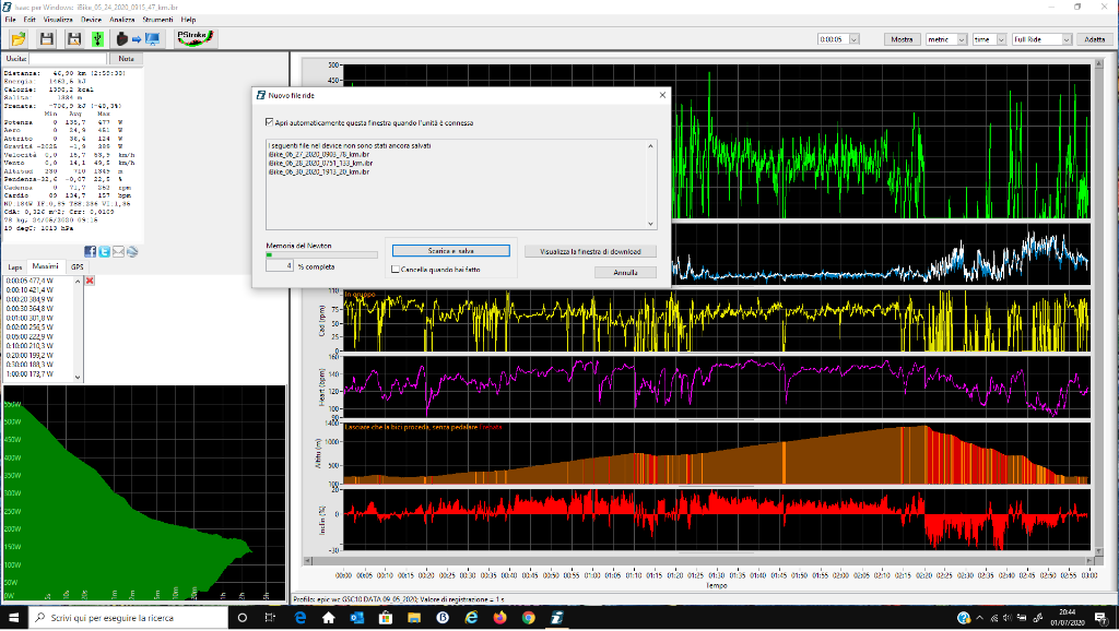

Hi John, I'm back. I was only able to go out on a bicycle on Tuesday evening. Given your last post, I cleaned up the PP, loaded the new firmware, reloaded the profiles of the two bikes and took a ride with the road bike (profile #3). The profile selection was made automatically by the pp. Speed and power correct at last!
However, I did not perform the whole test with the two bikes and the eight rides, if you deem it necessary I will do it tonight or Saturday. The only strange thing is that isaac has again signaled me some races already downloaded as new, changing this time only the file name (speed and power are correct and unchanged). I attach the screenshots (the second with the duplicated rides highlighted).
- NFW15.png (202.13 KiB) Viewed 20093 times
- NFW15 02.png (191.14 KiB) Viewed 20093 times
I think the multiple files are artifacts of the incorrect profile information used when the files were recorded with FW 714.
I suggest you erase your ride memory. This problem should disappear, too.
