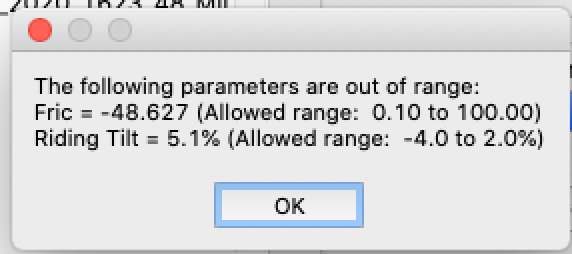

A few parameters are out of bounds so it would not load. See the attachment. What do you recommend I adjust the values to?
Dan
Dan

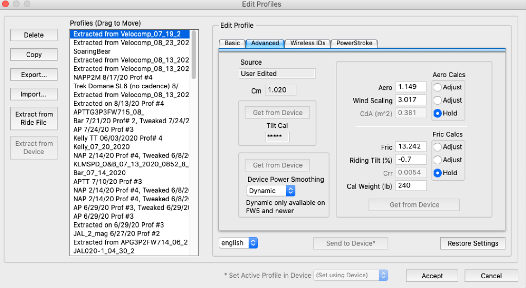

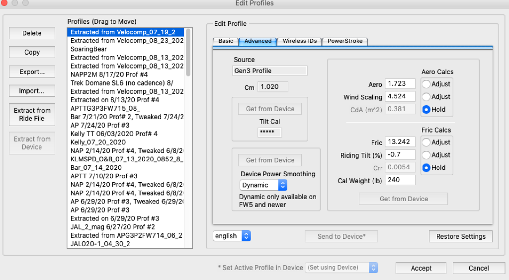

Re: PP V3 Does Not Seem Calibrate
Do the following:
1) Connect your PP to Isaac
2) Go to Edit/Edit Profiles
3) Click "Extract from Device". This will extract the profile currently used
4) Click the "Advanced" tab. You will see 4.524 as your wind scaling
5) Type 3.017 into the Wind Scaling window
6) Click Send to Device
This will put the correct wind scaling into your profile.
