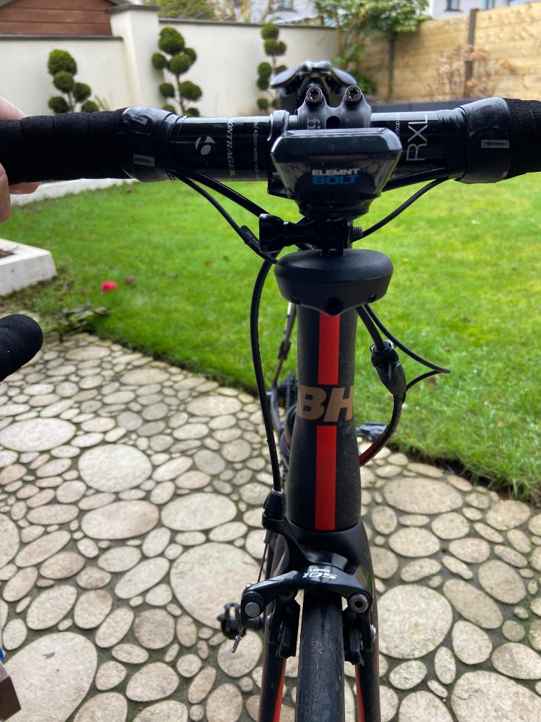

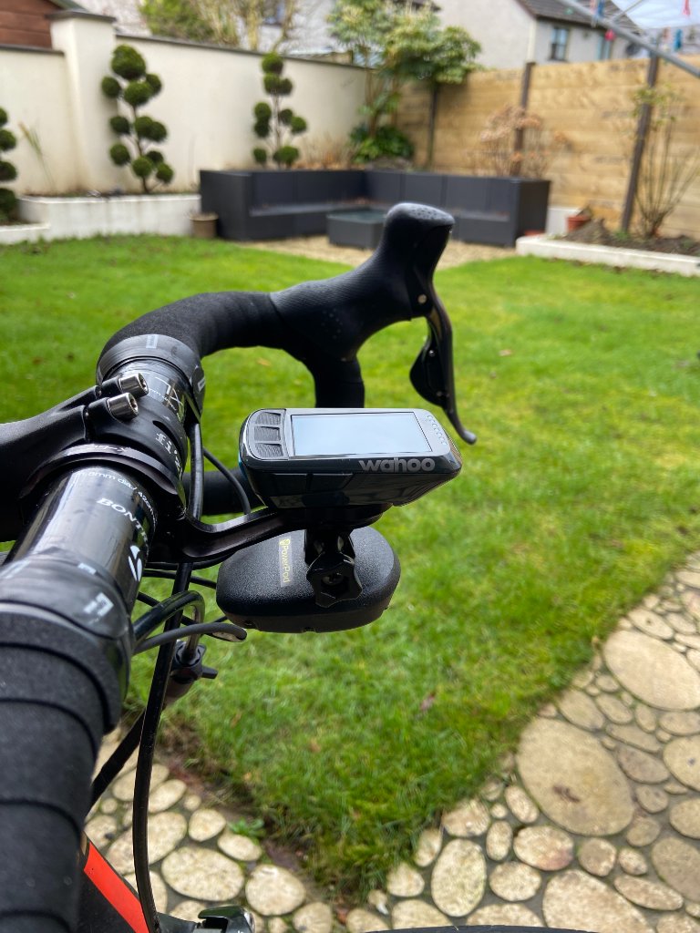

It appears that your wind port is blocked; the wind readings are close to zero...
Please post a photo showing how your PP is mounted on your bike. Side and front views will be fine.

I've attached 2 images. The PP is centrally positioned, with nothing in front of it. What's strange, is that it has worked well in the past. I got it in April/May 2020, and it worked well I think until about August. I've had no change in mounting since.
