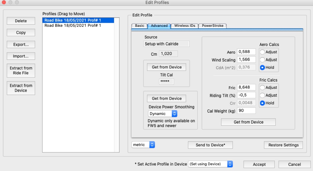

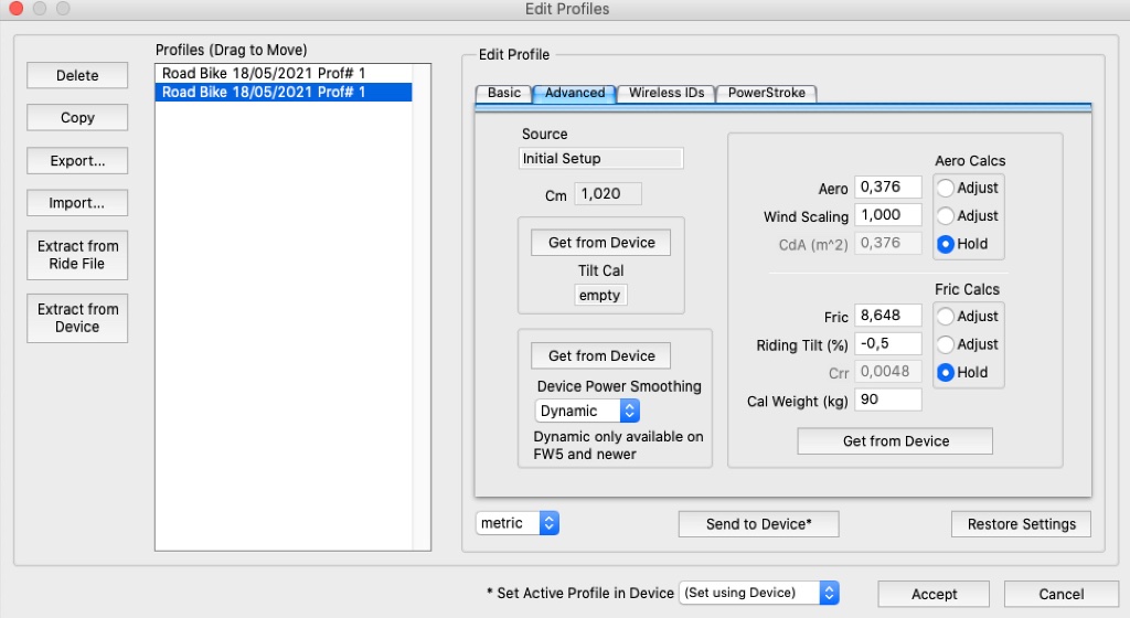

I have a PowerPod v4
I did my calibration ride (best accurac)
Now i see 2 profiles.
Is that normal?
CDA ans Crr are the same.
Aero and wind scaling are different.
Is this OK?
Kind regards ,
Xander

The profile with the 1.566 wind scaling is the post calibration profile. This is correct
The other profile you obtained prior to calibration. You can delete the profile with 1.000 wind scaling.
