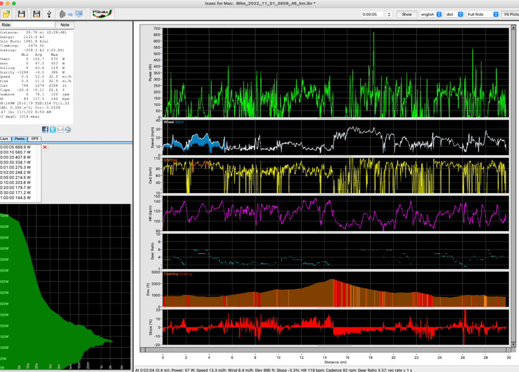

Your first ride looks OK, though your wind sensor calibration might be a bit low. I would do a new cal ride soon.
Your rain ride definitely showed a blocked wind sensor, starting around mile 5.
Screen Shot 2022-11-03 at 9.21.19 AM.png (344.74 KiB) Viewed 2329 times

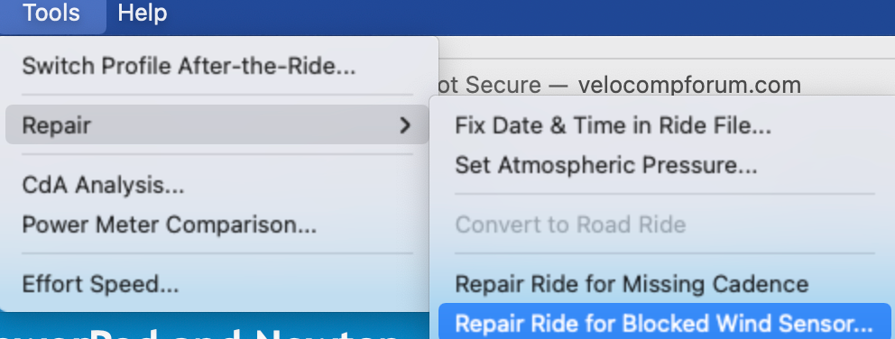

You can repair this problem in Isaac, using the command
Screen Shot 2022-11-03 at 9.20.24 AM.png (203.94 KiB) Viewed 2329 times

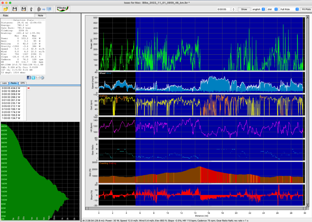

I highlighted from mile 5 to the end
Screen Shot 2022-11-03 at 9.22.18 AM.png (368.51 KiB) Viewed 2329 times
Corrected ride file is attached.
Screen Shot 2022-11-03 at 9.23.12 AM.png (340.13 KiB) Viewed 2329 times
