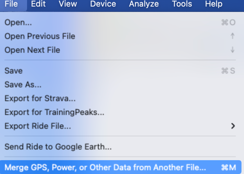

1) I merged your .tcx file into your PP file. This merges your Assioma data into your PP ride file
Screen Shot 2023-02-14 at 6.59.00 PM.png (205.58 KiB) Viewed 1660 times

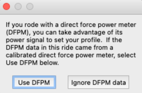

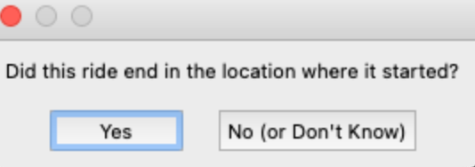

2) I used the command "Check Calibration" to check the DFPM data against your ride file
Screen Shot 2023-02-14 at 7.00.48 PM.png (41.83 KiB) Viewed 1660 times
Screen Shot 2023-02-14 at 7.02.34 PM.png (21.04 KiB) Viewed 1660 times

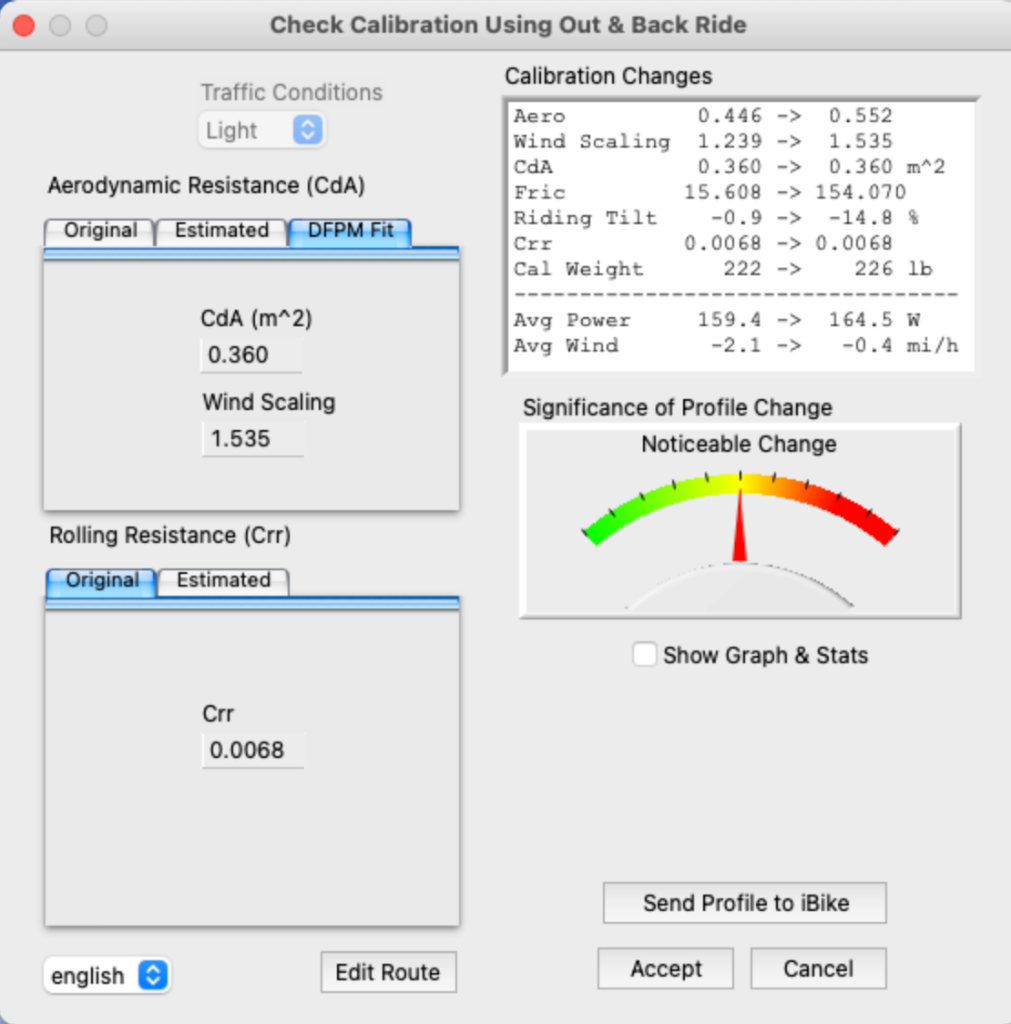

3) I used the DFPM data to adjust your profile
Screen Shot 2023-02-14 at 7.03.05 PM.png (53.29 KiB) Viewed 1660 times
4). This change improved your wind scaling and increased your watts
Screen Shot 2023-02-14 at 7.04.00 PM.png (229.77 KiB) Viewed 1660 times
Corrected ride file and profile are attached
