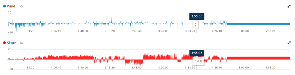

I noticed (as before) that slope and wind speed (as reported by the AeroPod CdA data field for Garmin) had stopped updating. But this time, power was still being reported. After finishing the ride, and uploading to garmin, I could see that the saved slope and wind speed had in fact frozen (from about 4:40 to the end of the ride):
The slope, and wind speed data in the .ibr file look right (attached). So presumably this was a crash in the AeroPod CdA data field.

markw65 wrote: Tue Jul 11, 2023 4:39 pm I initially thought it happened again, but this is something different.
Your ride file was fine, so this is some kind of error in the .FIT file

Velocomp wrote: Wed Jul 12, 2023 6:32 am Your ride file was fine, so this is some kind of error in the .FIT file
Well yes, in a way. But the Aeropod CdA data field froze during the ride. I had to reboot my Garmin Edge to get it working again.
Since its that data field providing the values to Garmin, when it froze, it stopped updating the fields, and so what got recorded in the .FIT file for the rest of the ride were the stale values from just before the time that the data field froze.
