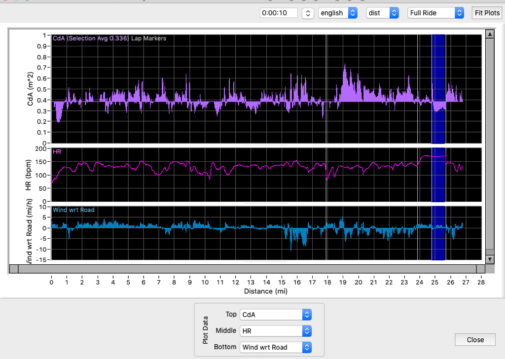

Your wind calibration was grossly incorrect (constant headwind).
Here is what I did, using the merged 43KM ride file:
1. I extracted your ride profile "Edit/Edit Profiles/Extract from Ride File"
2. I manually reduced the wind scaling factor (WSF) to about 1.2 (a guess), so that wind speed would be reduced.
3. I used the command "Tools/Switch Profile After the Ride" to see how the reduced WSF would affect overall wind speed. The goal is to get average wind speed to be about the same as average bike speed.
4. After looking at the result I adjusted WSF up a bit, to get wind speed closer to bike speed. The best number is WSF = 1.294. This makes average wind speed exactly the same as average bike speed
With this adjustment, your PP is very close to 4iii; 204W PP vs 207W 4iii.
What's also interesting is the end of your ride, where you go into TT position. PP watts are high, as expected. In fact, for the last portion of your ride, your PP watts were about 50W higher than your 4iii watts; what this means is that you effectively picked up 50W of free power by riding in your TT position!
The other thing you can do, with the Analyze CdA command, is quantify how much more aero you are in the TT position. Your average CdA for the second half of your TT ride is 0.336. This is much better than your default CdA of 0.384.
Screen Shot 2020-11-08 at 9.15.03 AM.png (219.22 KiB) Viewed 42629 times
Modified ride file and profile attached.

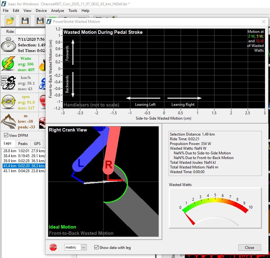

Here is a screenshot of my powerstroke error.
Powerstroke Error.jpg (129.42 KiB) Viewed 42586 times
Re: Pairing PowerPod with DFPM for cadence data
For PowerStroke you need a separate, crank-mounted cadence sensor.
Cadence data added after the ride won't work.

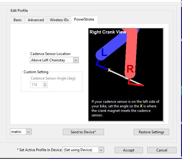

I was wondering what is the best setting to use in my profile for Candence sensor in Power Stroke?
Screenshot 2020-11-14 175252.jpg (44.06 KiB) Viewed 42522 times
I am using the Garmin magnetless candence sensor.
Candence Sensor
Candence Sensor
Screenshot 2020-11-14 175703.jpg (93.47 KiB) Viewed 42522 times
Your cadence sensor should work.
Use above the left chain stay.
