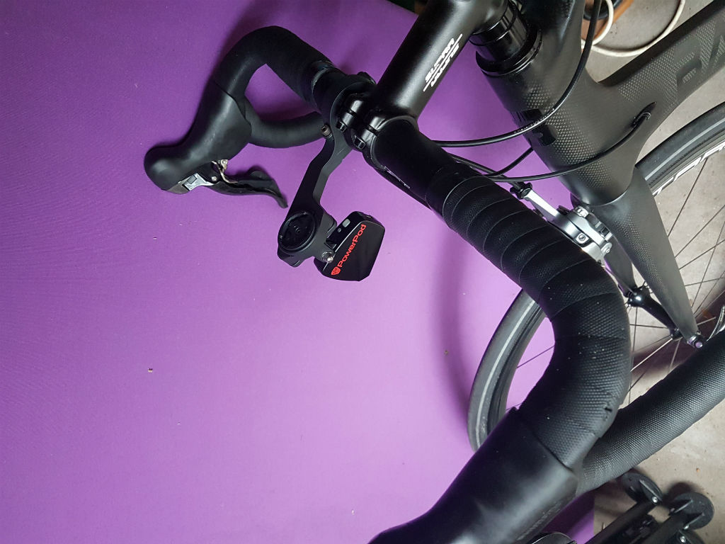

Re: cobble stones power 0
Please post an image showing your PowerPod mount and its placement on the bike. Also, please post your .ibr ride file.
You're riding with a mount that appears to be made of plastic. This will flex and vibrate in cobbles and cause the PowerPod to not function.
If you're going to ride on cobbles then you need to get one of our PowerPod combo mounts, which is made out of machined aluminum, is extremely stiff, and has been tested on rough roads.

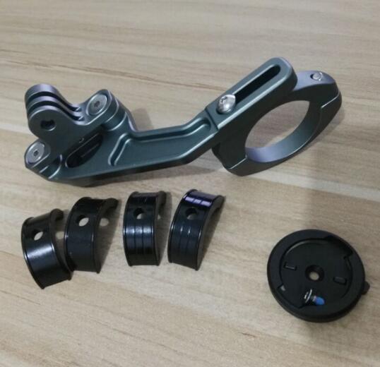

drashkum
Posts: 70
Joined: Fri Oct 14, 2016 9:40 am
Post by drashkum »
Sorry to barge into someone else thread
Would a similar mount (Non OEM) made of aluminium/ alloy be OK?
Alloy
Alloy
This one is a similar to the thread owners combi gopro/ garmin mount ( Upside down view) which mounts on handlebar and jutting on the front
Stem mount
Stem mount
This one is made of alloy and sits on top of the stem and mounts into the stem with the upper stem screws. Can house garmin above and gopro below
Just curious to know if they would be ok?
