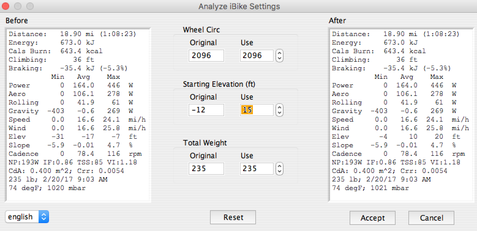

The elevation is showing a negative elevation, is there a way to correct that?
And do the calories used look correct?
Thanks for reviewing the ride!!
Re: Pairing BLE/Ant+ PowerPod

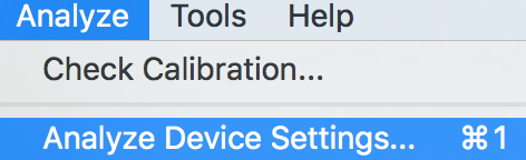

"Wrong" elevations are due to weather changes.
You can easily correct the starting elevation of the ride in Isaac using the "Analyze/Analyze Device Settings..." command
Calories are, by definition, power added up over time. So yes, your calories are quite correct (and infinitely more accurate than your PowerCal).
