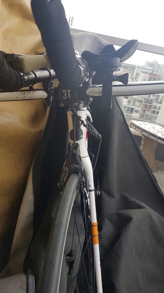

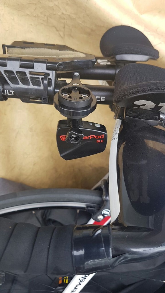

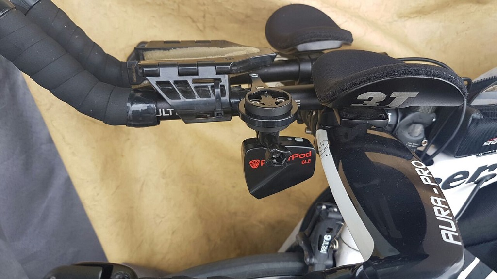

Hmm...your wind speed is low in that one section. Please post photos of your PowerPod mounted on your bike, top, side and front views
Re: new powerpod ble - is it ok?
john, here the pics! no cables or something.. very clear front view and solid attached.
thank you very much!
ale
Looks good!
Be aware that your left hand, when on the aero bars, is in the general vicinity of the PP wind port. This is NOT a problem, except if you inadvertently position your hand in a way that disturbs the wind flow. You had ZERO problems during your FTP test. It's possible you moved your hand around some in the section where wind was low, but this is just a guess.
I'd keep riding.
I'd keep riding.

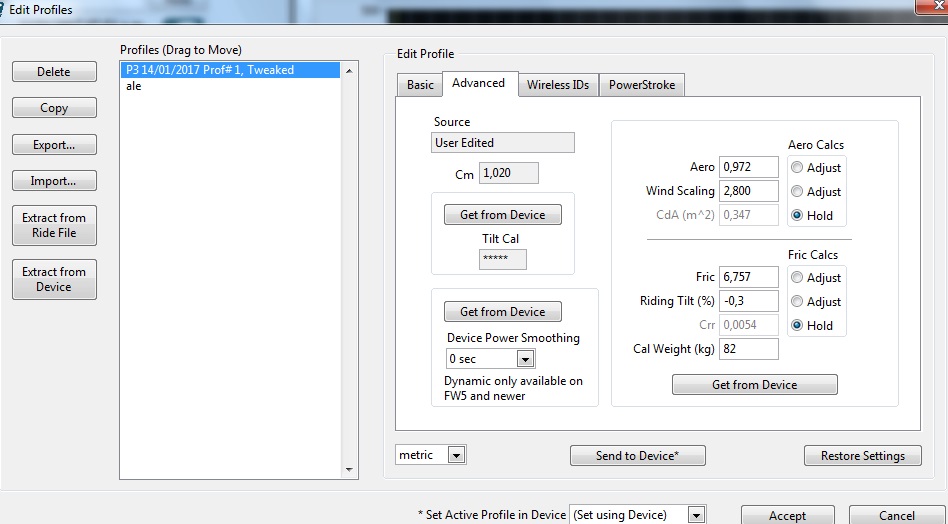

so, iam being close friends with the PP each day...! i have a question: is there a manual/documentation for the "advanced profile"? iam a good student and need to know how this numbers affects my rides.
ive just take a look to the numbers but dont know where am i. is it 0.972 in aero ok? is it a good number for my body / bike? wind scaling 2,80..the same... is it good? i dont know if 2.8 is ok or it must be 1.7 for example. Frics calcs ..the same way.. 6.757 is good?
this numbers (i think) are from the file you sent me "tweaked" and were sent to the pp. aim attaching a file for rerence.
the garmin sensor is actually in front hub and has new fresh batteries!!!
Consult Isaac instructions (available from the Help menu of Isaac) to learn more about how to manipulate the profile numbers.

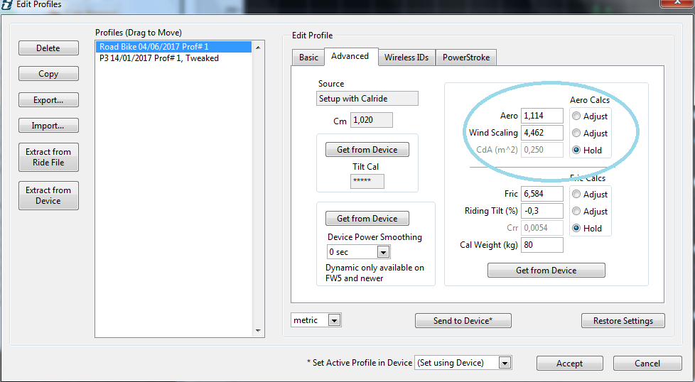

ive just did a "cal ride" since never been done.
Ive always use your data for the first time you sent and never touch them. I trained with the given numbers. Now, i finished my season and did the cal ride to see/check the numbers and soon ill be doing my new ftp.
So, the new numbers (cda, wind scalling and aero) are very different. (the PP, mount place, me , bike, etc etc are the same).
Are they ok? or i must keep the "old" numbers?
thank you very much,
ale
ale
Please post a regular ride file that you did after your calibration ride.
here is the relaxed today ride.
- iBike_06_04_2017_0806_23_km_HiDef.ibr
- (394.04 KiB) Downloaded 508 times
Just to confirm: you are riding a TT bike?
If so this calibration looks good.
Yes, the same TT as the pictures sent in the begining of this post.
So, the old numbers were wrong?
Is There a sustancial change in power numbers?
Thank you very much!
