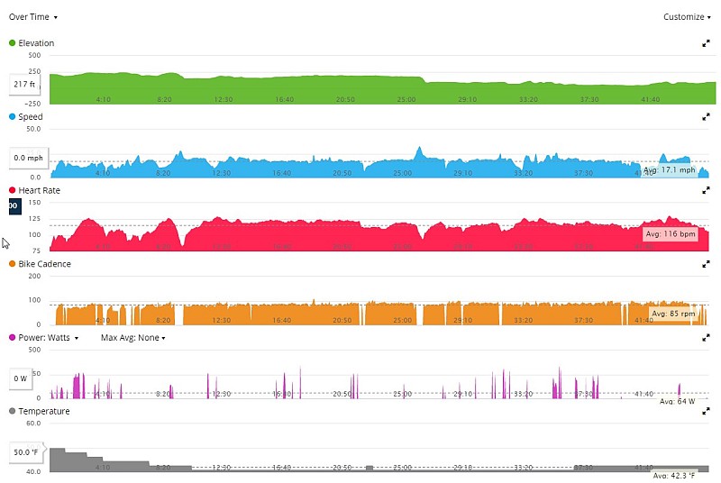

Not strictly a Powerpod issue, but one that I know that at least one other person has had it. I'm exploring it further in the Garmin forums, but I thought it might be useful to share it here too. https://forums.garmin.com/showthread.ph ... -820/page5
(John, your thoughts would be interesting although I'd understand an "it's not the Powerpod's fault" too. There appears to be a user level assertion that it's the Garmin 820's antenna (rather weak) that's the cause). However it only appears to be users of Stages power meters & Powerpods who seem to have complained.

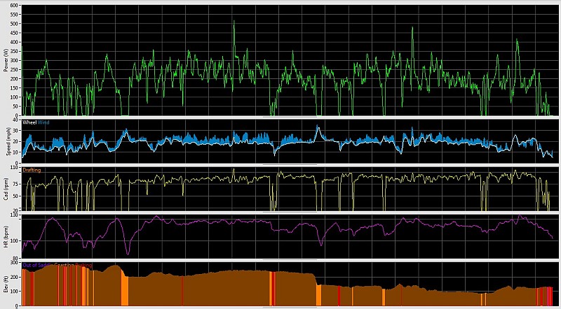

I have the Powerpod mounted under the Garmin, in an out-front mount. I get intermittent drops in the power reception, despite there being 2" between the 2 devices.
You can see the dropouts on the lowest trace (N.B. recording registration is not perfect).
Garmin 820 Powerpod power dropouts

Crank-based power meters have two challenges: 1) their antennas are rotating; 2) they are physically distant from the receiver (Garmin).
PowerPod has neither of these issues.
I notice that, as I look at your graph, the Garmin's cadence sensor data is dropping out, and these are the places where there are major deviations in watts. It might be that the Garmin forces power to zero when cadence is zero.
You might want to check your cadence sensor, to be certain it is functioning properly.

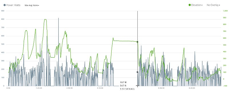

My Garmin is on 7.0 & dropped power from the whole of the first 20km ride of the 200k I did on Saturday. Rebooted the Garmin & everything seemed to go fine for the rest of the day.
It could be a random startup related Garmin error, but the thought did occur to me that when I begin to ride normally I will wake the sensors after I wake the garmin (hangover from my garmin 500, which was not exactly transparent about which sensors were detected unless you watched the pop up notifications).
When I rebooted the 820 midway through the ride the sensor & PP were already awake & broadcasting.
I've not ridden again since - & won't get a chance until the weekend - but this might just be an avenue worth considering.

Darkstar
Posts: 20
Joined: Mon Feb 06, 2017 7:58 pm
Re: Garmin 820 signal dropouts
Post by Darkstar »

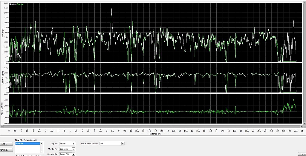

It's definitely an intermittent problem. Keep trying :)
Here's the first 13 mile stretch of my ride on Saturday.
You can see that the power recorded in the Garmin after the reboot is... more realistic than before (You can spot the feed stops & the disastrous puncture stop too)

After 4 hours of riding, I can say with 100% confidence that the PowerPod is working properly. I can also say that my 820 had ZERO dropouts from power signals received by the PowerPod.
What does this mean?
Well, there are 6 pages of complaints on the Garmin forum, regarding power dropout problems with the 820. 5 ½ of those pages concern products other than ours.
Folks, if there is a problem with the 820, it is not because of PowerPod.
