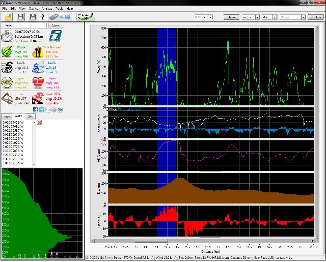

I posted the other day about how I felt the PP was overestimating my power output uphill due to a tail wind. Following positing it seemed that actually the numbers were correct, however I still was a bit surprised I was able to ride at ~450 W for 5-minutes, quite a bit higher than I thought I was capable of.
I looked again at the file and ran the ‘Analyse Route’ option and this had the effect of reducing my 5-minute by 53 W or 12% (from 444 W to 391 W), with the average gradient for that section changing from 10.5% to 9.1% (looking at mapping data the 9.1% figure is much more accurate, 115 m of altitude gain in 1.3 km). Also the 391 W value is much more believable based on other longer efforts of mine and comparing my time with other similar peoples time and their associated power on this hill; to be honest I really do not think I was riding at 450 W.
The ‘check calibration’ option for this ride suggest that the riding tilt should be -0.5%, whereas it was set to -0.4%, this doesn’t seem like much difference, plus I thought the PP was constantly ‘calibrating’ and I had been riding for over 20-minutes before this effort?
Is there a problem with my PP? It seems the PP was initially basing the power calc on a gradient which was too high. To be honest it’s a bit frustrating as I don’t have confidence that the reported numbers are accurate to within +/-10% :(
The relevant file is attached again.

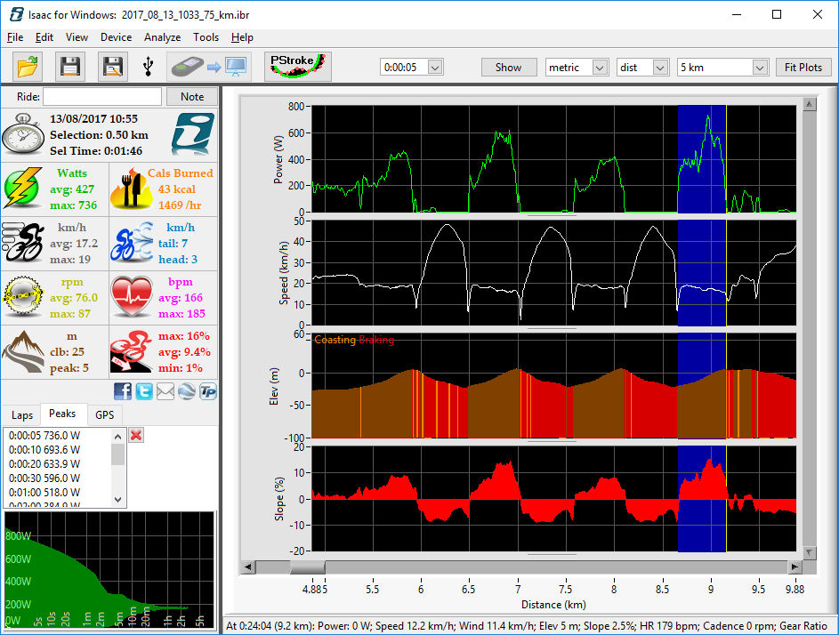

1. Around 15 km for 1 km, the PP average gradient says 13.2% but the actual altitude change is 107 m over 930 m i.e. 11.5%.
2. Around 25 km for 500 m, the PP average gradient says 16% but the actual altitude change is 67 m over 460 m i.e. 14.5%.
3. Around 34 km for 1.3 km, the PP average gradient says 10.9% but the actual altitude change is 127 m over 136 m i.e. 9.3%.
4. Around 37 km for 1.3 km, the PP average gradient says 10.2% but the actual altitude change is 128 m over 136 m i.e. 9.3%.
The ‘check calibration’ option for this ride suggest that the riding tilt should be -0.8%, whereas it was set to -0.4%.

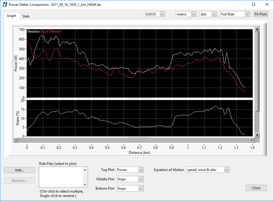

Based on the data above and doing a ‘simple calc’ (https://www.gribble.org/cycling/power_v_speed.html) my average power for the 5-minutes should be ~350 W (believable), of which 88% is overcoming gravity, whereas the reported/PP average reported power was 445 W (unbelievable); a significant 95 W/22% difference. However if the average gradient was 10.5% then the average power, based on the simple calc, would be ~435 W (only 10 W/2% off what PP said).
Could the reason for this be due to the fact on steep hills I am out of the saddle and there is more ‘side to side’ bike movement?
Edit: in fact in the image above (and file attached) you can see @1min53s where my power drops instantly by ~100 W, likely where I sat back down on a 'flatter' section, then @3min31s where my power jumps up by ~100W around when I would have got out the saddle again on a steeper section.

Bike calculator apps like Gribble use inputs such as speed, slope, rider weight, etc. to compute power.
To use these apps properly you have to be very careful to feed them data consistent with their assumptions. The critical assumption in these apps is that the numbers you input are unchanging.
On the interval you showed below, there is a significant decrease, then increase in the slope of the hill during the climb. Similarly, speed drops, then increases, then drops. These changing input parameters are inconsistent with the app's critical assumption, so the app's power analysis won't be correct.
What I did is use your interval, but selected just the portion of it, where slope and speed are relatively unchanging. Basically, this is the first slope "bump" of your interval. Your reported slope is a pretty constant 13.8%, and speed is a pretty constant 14.1KM/h. I also entered the appropriate values of weight and wind speed (note: at these low bike speeds, wind speed is pretty irrelevant).
Your bike speed is low, which as posted above, can create inaccuracies for bike acceleration measurements. However, because the section I selected has almost-constant bike speed, your bike acceleration in this section is nearly zero. This means that the accelerometer's measurement is driven almost completely from hill steepness. So, PowerPod slope measurement can be pretty accurate.
I used my favorite program, bikecalculator.com (it allows for CdA adjustment) but I'm sure gribble would produce similar numbers.
The result? bikecalculator.com: 502W. PowerPod: 495W
I am very confident that, if you had a DFPM on your bike, you'd get results nearly identical to your PowerPod.
I'm beginning to wonder if the "real" problem here is that you are a much stronger cyclist than you might think! :-)

I've just been out for a quick test ride which involved riding up a nearby hill (elevation gain of 39 m over 600 m, 6.5%) 5 times. The hill has a fairly constant gradient and I tried to ride it at the same speed (14.5 km/h) the entire way up for each effort.
1. Seated (14.6 km/h 258 W based on gradient vs 285 W based on PP - 10% difference)
2. Standing (14.2 km/h 250 W vs 337 W - 35% difference)
3. Seated (14.5 km/h 256 W vs 278 W - 8% difference)
4. Standing (14.0 km/h 246 W vs 324 W - 31% difference)
5. Seated trying to be very smooth (this was ridden slower in a lower gear, 13.2 km/h 231 W vs 240 W - 4% difference)
For both the seated and standing efforts the reported gradient, 7% and 9% respectively, is higher than the actual gradient, also the reported average power is also higher for the standing efforts by ~50 W despite been ridden at the same speed. I'll let you look at the data yourself though!
Looking at the PS data none of the efforts look particularly 'good', but I suspect the standing efforts are off the scale?! I'm also not fully clued up on this.
Is this movement of the bike the cause of higher power values than otherwise anticipated, looks like it is, but am I really 'wasting' 50 W when standing out of the saddle on this hill?
I need to do some more efforts, particularly of Bear Hill...

Posted: Sun Aug 13, 2017 6:01 pm
The data is really interesting, and helpful to understanding better what is going on:
1) In the saddle, your PowerStroke looks good: 3 cm side to side, 1 cm front-to-back, 8 wasted watts
In-the-saddle PowerStroke
Screen Shot 2017-08-13 at 2.51.25 PM.png (209.4 KiB) Viewed 27397 times
2) When out of the saddle you have a huge 14 cm side-to-side sway and 6 cm front-to-back sway; honestly, the largest sway I've ever seen in a ride file, by at least a factor of 3.
Hill 3
Hill 3
Screen Shot 2017-08-13 at 2.24.53 PM.png (362.01 KiB) Viewed 27397 times
The impact of such a large sway on accelerometer readings is something we have not previously studied, but obviously it is having a material effect. Such a large sway may also be having an adverse effect on your riding efficiency. PowerStroke is estimating 175W of wasted watts (I don't think it is really that much, but it is definitely something to look at)
3) When using PP for slope measurement comparisons, it is extremely important to pick locations where the slope is not changing, and where bike speed is constant. You have some good data available that satisfies both conditions. You can see a clear break (reduction) in watts near the top of the hill. This is where slope goes down slightly. However, for the prior 430 meters, slope is nearly constant, and you've done a great job of holding constant bike speed (no bike acceleration effect). So, this section of the hill is perfect for slope measurement comparisons. (The data in hill 1 is OK, but nearly perfect for hills 3 and 5). Of course, the out-of saddle data on hills 2 and 4 is not used... :-)
Out-of-saddle PowerStroke
Screen Shot 2017-08-13 at 2.09.13 PM.png (320.91 KiB) Viewed 27397 times
For your three, In-the-saddle efforts (hills 1,3 and 5), PP measures:
Hill 1: 30 m climb, a 7.57% slope (note there is some bumpiness in watts near the top of the climb).
Hill 3: 30 m climbed, over a distance of 430 m, or a 7.39%. Very smooth watts
Hill 5: 30 m climb, 7.38% slope. Very smooth watts
Hill 1 has some variation in watts near the end, but hill 3 and 5 are very, very smooth. So, for PP, I've used 30 m rise (from baro sensor), 430 m length (from speed sensor), and 7.385% slope (from accelerometer, hills 3 and 5)
Using the baro sensor and speed sensor data, you climbed 30 m over 430 m, which yields a slope of 7.0%, somewhat lower than the 7.385% slope measured by the accelerometer.
But here's the thing: if the distance climbed were measured to be 31.7 m, instead of 30 m, PP and baro slopes would be identical.
For baro elevation readings to be precise, the pressure inside PP case needs to be identical to the outside pressure. Under conditions of rapidly changing pressure (which happens on any steep climb), it takes about 5 seconds for internal and external pressures to equalize; consequently, the baro sensor elevation will lag behind actual elevation changes.
You climb 30 m in about 107 seconds. Each 5 seconds you climb about 1.4 meters. So, what may be happening here is that the baro elevation/slope readings are not updating fast enough to keep up with the accelerometer slope readings.
I think we agree that your out-of-saddle riding is causing high accelerometer readings. And my view is that the in-saddle accelerometer, slope and power readings are correct.

This evening I got out on a ride which included the Bear Road hill. I was a bit slower this time, but the result is essentially the same as previously. I have attached two ibr files, one for the whole ride and one for the Bear Road section only (which occurs at 24 km in the ride).
Interestingly I was looking around the software and found the 'Tools>Power Meter Comparison' feature and that within this you can select an equation of motion to compare it to. Selecting 'speed, wind & elev' option gives the following chart (it seems the elevation used to calculate power is based on the barometer data rather than the calculated slope). Usefully this shows the overestimation at the beginning when I am out of the saddle, the middle flatter section where the two are much more closely aligned when I am riding in the saddle before the final steeper section where they diverge again.
I also looked at this for the whole ride and generally the two align quite nicely, although the equation of motion tends to be always be a bit lower, particularly on hills of all gradients and whether I rode them sitting or standing, although the difference is always higher when standing.
