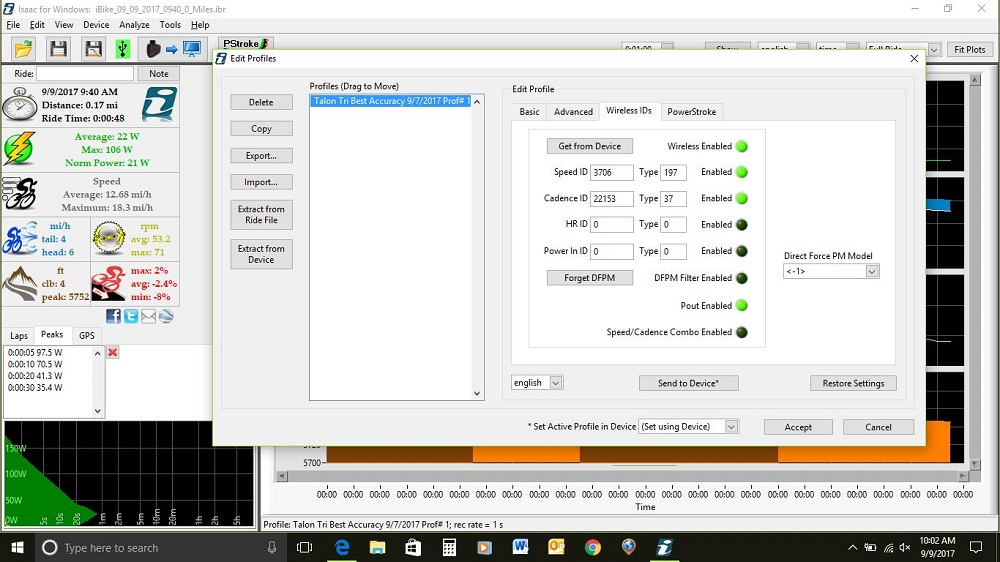

Thank you for the fast reply John. I did notice on the profile that my Garmin cadence sensor (separate from speed sensor) did not pair. I will work on that next.

Re: May have figured it out - Velcomp please read
DaleD wrote:Thank you for the fast reply John. I did notice on the profile that my Garmin cadence sensor (separate from speed sensor) did not pair. I will work on that next.
Thank you,
Dale
The Garmin cadence sensor takes a bit of time to wake up. Pedal your bike until you see cadence readings on your Garmin bike computer. Then, do a PP sensor pairing.
DaleD
Posts: 9
Joined: Wed Sep 06, 2017 12:10 am
Post by DaleD »
Yes, I thing I have found out about the Garmin Cadence sensor is that it like to have a little pressure applied to the pedals.
1. Just do a quick 15-30 second ride to wake it up. (Pedaling by hand did not work for me.)
2. Stop
3. Press and hold the PP button for 4 seconds to start the pairing for the Garmin Cadence sensor.
I am up and rolling once again.
Dale
