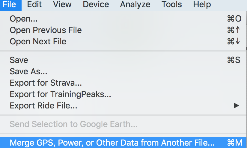

Can I import GPS data from my Garmin 1000 into Isaac ?

Yes; here is how:
1) Export your Garmin file in gpx format
2) Open the corresponding ride file in Isaac
3) Use the command "File/Merge GPS..."
4) Navigate to your Garmin file to merge

Velocomp wrote:Yes; here is how:
where do i find the "merge GPS" its not in the file menu
Re: Gps
Here
Screen Shot 2017-10-27 at 8.40.15 AM.png (116.62 KiB) Viewed 6275 times
