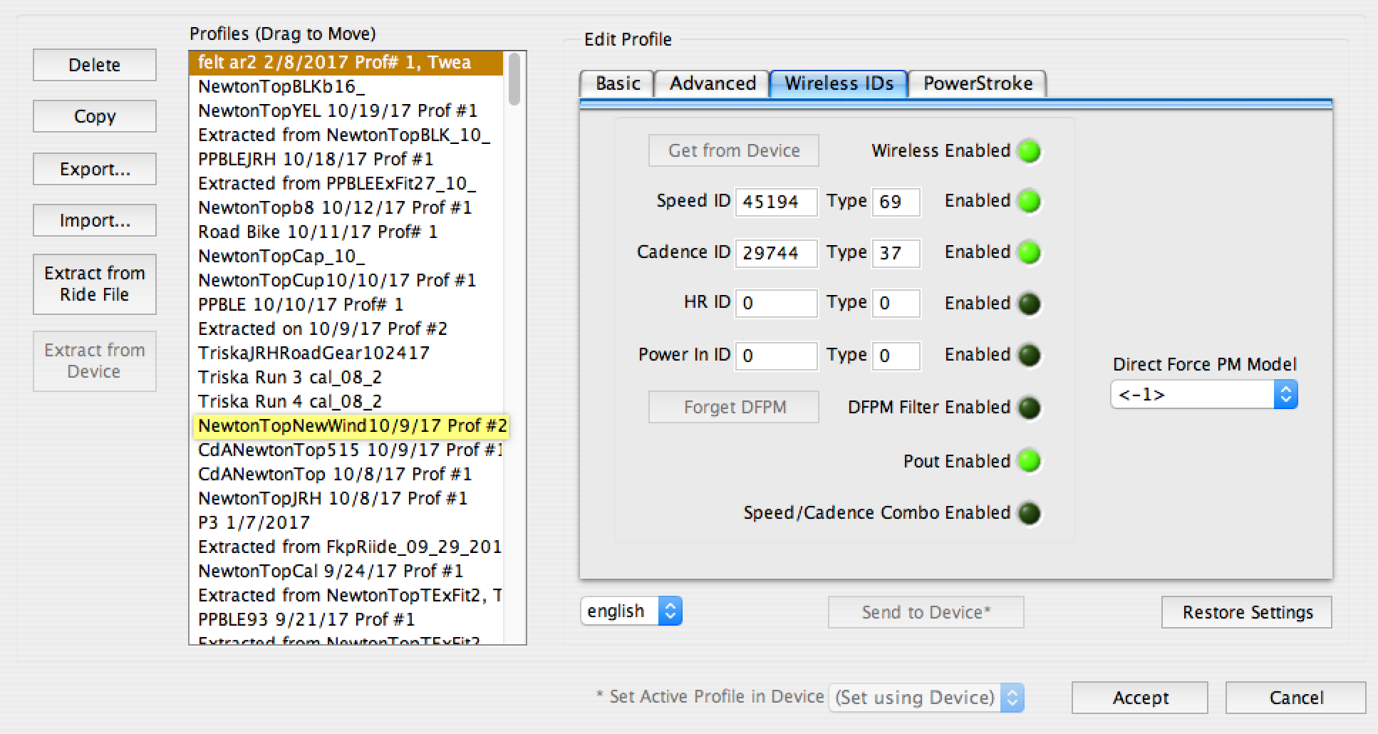

Re: Almost fixed my Cadence = 65335 issue
Attached are the sensor IDs of the ride file you sent.
Your cadence ID is 29744.
Something is not right with your Garmin's pairing or your Garmin's setup. I think you should contact Garmin support.
- Screen Shot 2017-10-26 at 12.52.47 PM.png (304.04 KiB) Viewed 10967 times

The problem was that my Garmin had the PowerPod twice. Once with an ID number and once with the word PowerPod.
I had a hypothesis that that was the issue so I deleted one from the Garmin (I chose the one with the word PowerPod). And deleting this from the Garmin worked! It was the root cause.
First, no overflow in the cadence display!
Second, after a couple miles, I started getting power readings in the 3s avg power display. I'm assuming it will start showing this instantaneously like it used to, correct?
Thanks for taking care of me.
