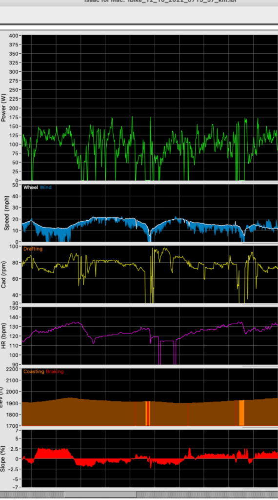

Re: PowerPod and ShockStop Stem by Redshift
I looked at your ride file. The only bothersome thing I see are periodic speed sensor dropouts, which will cause power dropouts. What kind of speed sensor are you using, and where is it mounted?
I don't see any evidence that your shock stem is causing problems. MTB with front suspensions are quite different and potentially can cause problems.
- Screen Shot 2022-12-26 at 5.16.44 PM.png (207.62 KiB) Viewed 33755 times

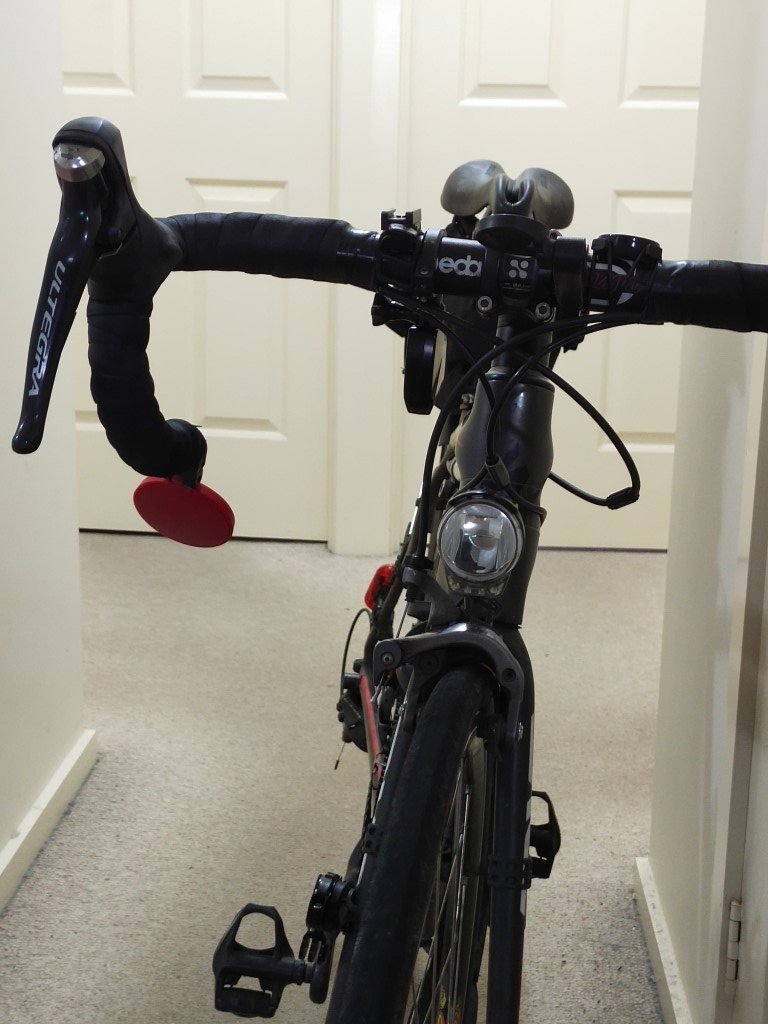

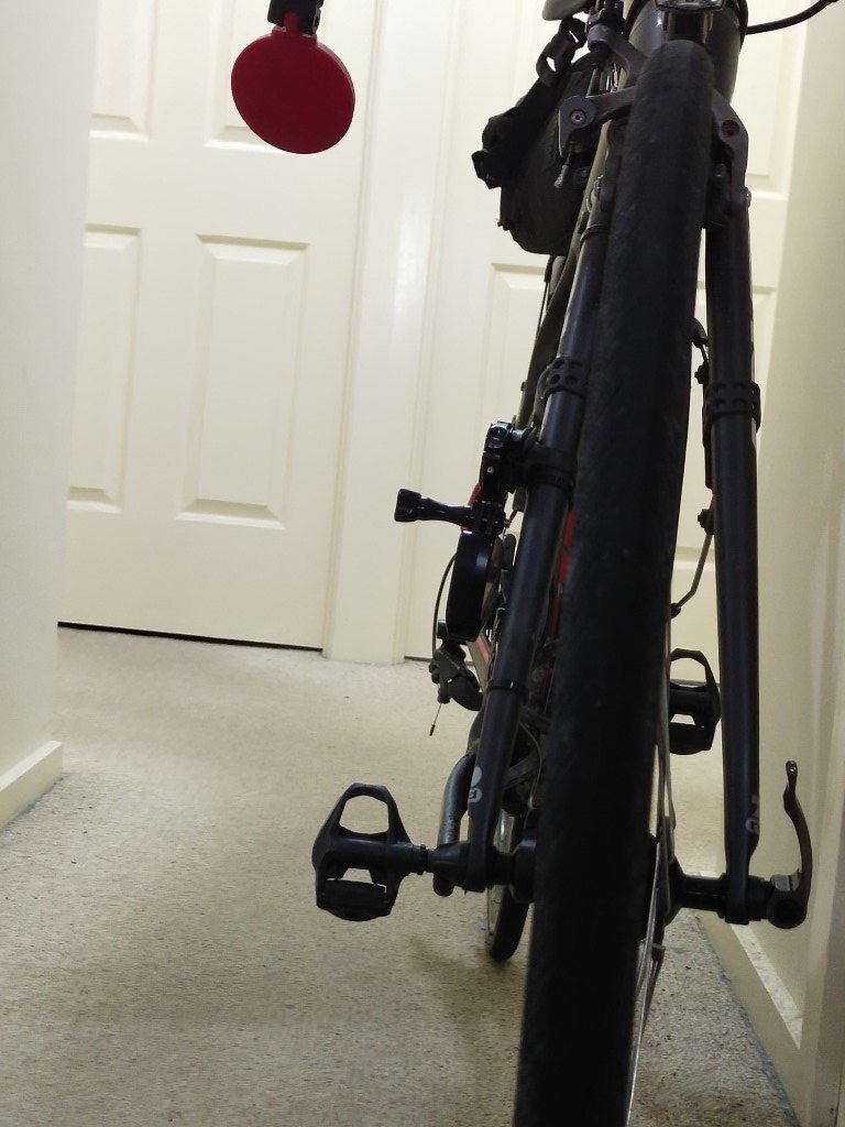

Please provide photos showing where your PP is mounted for each configuration. Make sure you say which one is fork, the other bar
Here are the photos. I took shots from the front and side for both configurations to illustrate that there are no obstructions in the bar mounted position and to show the gap between the PP and fork in the fork mounted position. It's not a big gap so I think the PP V5 would not work in a fork mount configuration with my existing attachment.
I hope this helps.
Lots of comments:
1) I looked at the slope correction data for your rides. This data shows the effect of mount rigidity. There is some difference between fork and bar mount rigidity. The fork is more rigid, but at only one point in the bar ride (around 50km) is there a significant shift in calibration correction. This is on a downhill and might be a result of stem flex. This affected watts for only about 40 seconds; after that the unit self-corrected. Overall, I don't think stem flex is a material issue for you and you can mount your PP on your bar.
2) What IS worrisome is that you have spikes in your speed sensor data, both in the bar and fork files
Fork
Bar
Speed spikes will cause power dropouts and also might affect calibration. What kind of speed sensor are you using and where is it located? I would change its battery...
3) The biggest factor affecting your watts is wind. On the 12/17 ride (fork) you had a net tail wind for the ride of -0.6 km
On your 1/28 ride (bar) you had a net tail wind of -2.9 km/h
Riding In a tail wind takes less power, and the stronger the tail wind, the less power is required. . You rode faster because the tail wind was helping you. You had lower watts because the tail wind was pushing you forward more than required to achieve the slightly higher bike speed.
I don't think the lower watts are attributable to the shock stem, and I don't think the shock stem is a material factor in your ride stats.
Fork
Bar

Your cal ride is fine.
You are getting some odd cadence readings, along with the occasional speed spike. You might want to find an older-generation magnet speed/cadence sensor for your rear wheel.
I really don't see any strong evidence of problems caused by your shock stem. There are a few places where, at the start of a downhill, you are traveling at high speed and pedaling, where watts are a bit high. But, this may be caused by changes in your ride position.
"Check Calibration" should be used only for short, out and back rides. I would not change your profile settings.
Your ride file looks fine. Speed spikes are gone!
At km 12.3 you stopped for about 20 seconds. I don't see any peculiar data there.
GPS elevation readings are unreliable. PP uses a baro sensor to directly measure changes in atmospheric pressure, which tie directly to elevation changes.
I don't believe the GPS elevation gain, and I do believe the PP elevation gain.
