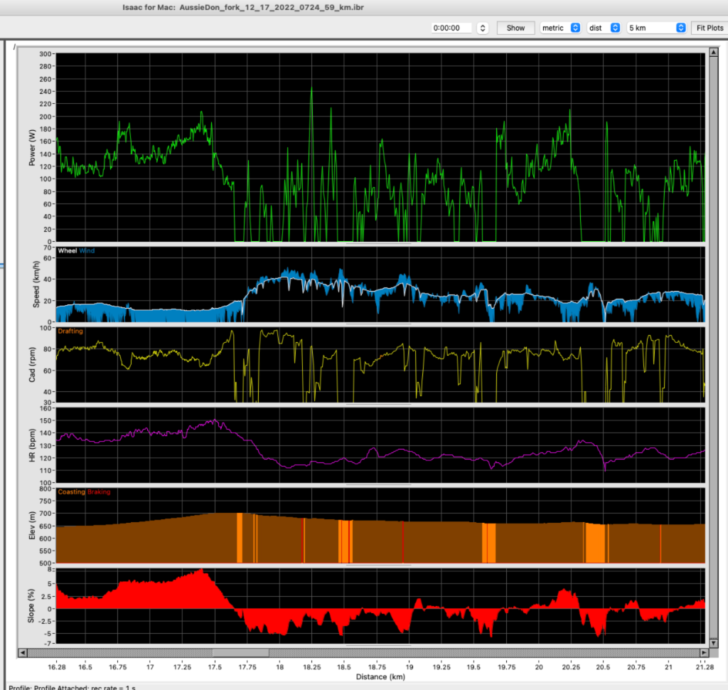

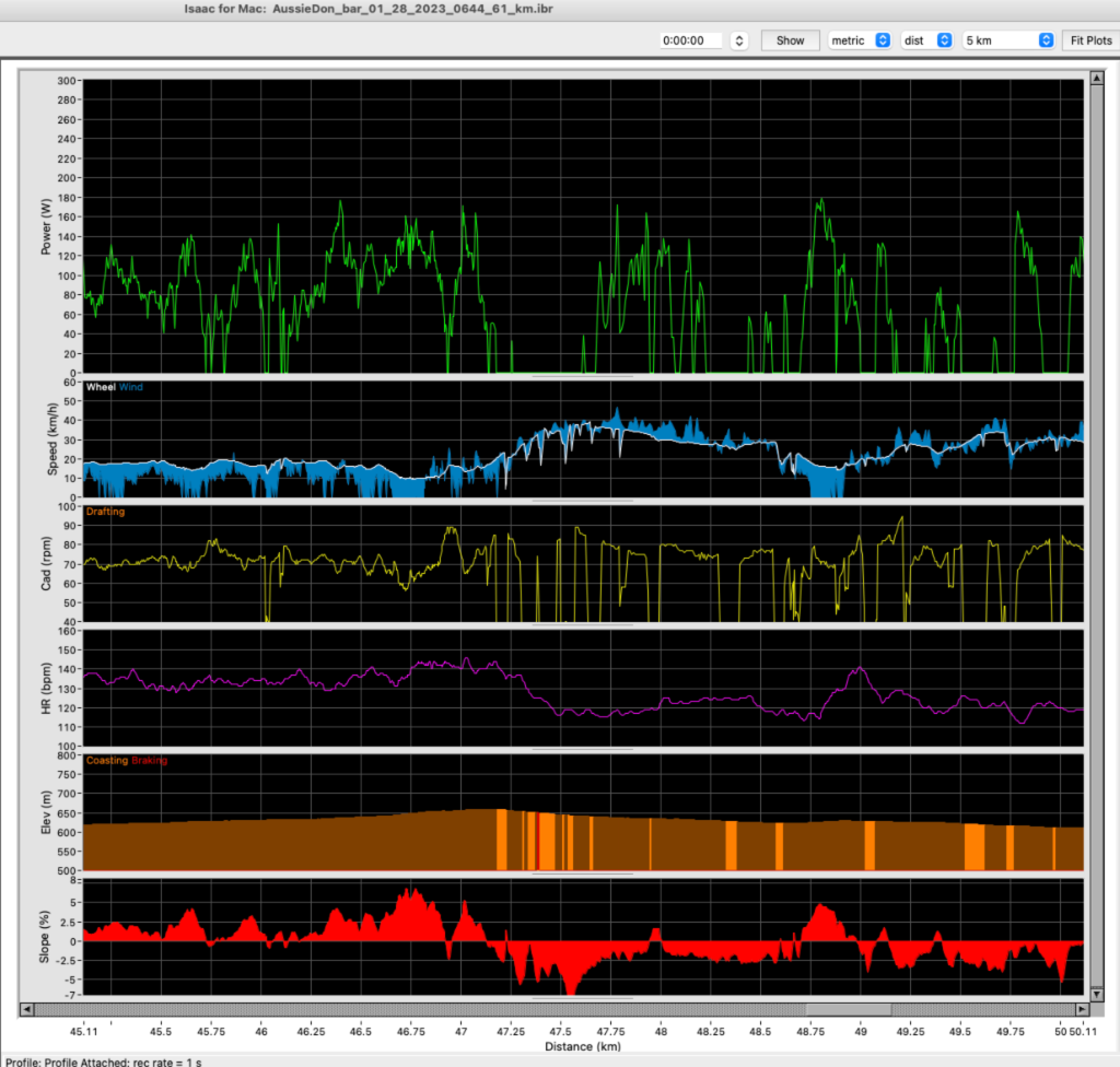

1) I looked at the slope correction data for your rides. This data shows the effect of mount rigidity. There is some difference between fork and bar mount rigidity. The fork is more rigid, but at only one point in the bar ride (around 50km) is there a significant shift in calibration correction. This is on a downhill and might be a result of stem flex. This affected watts for only about 40 seconds; after that the unit self-corrected. Overall, I don't think stem flex is a material issue for you and you can mount your PP on your bar.
2) What IS worrisome is that you have spikes in your speed sensor data, both in the bar and fork files
Fork
Bar
Speed spikes will cause power dropouts and also might affect calibration. What kind of speed sensor are you using and where is it located? I would change its battery...

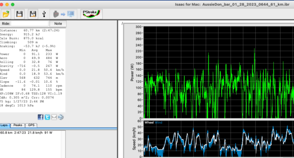

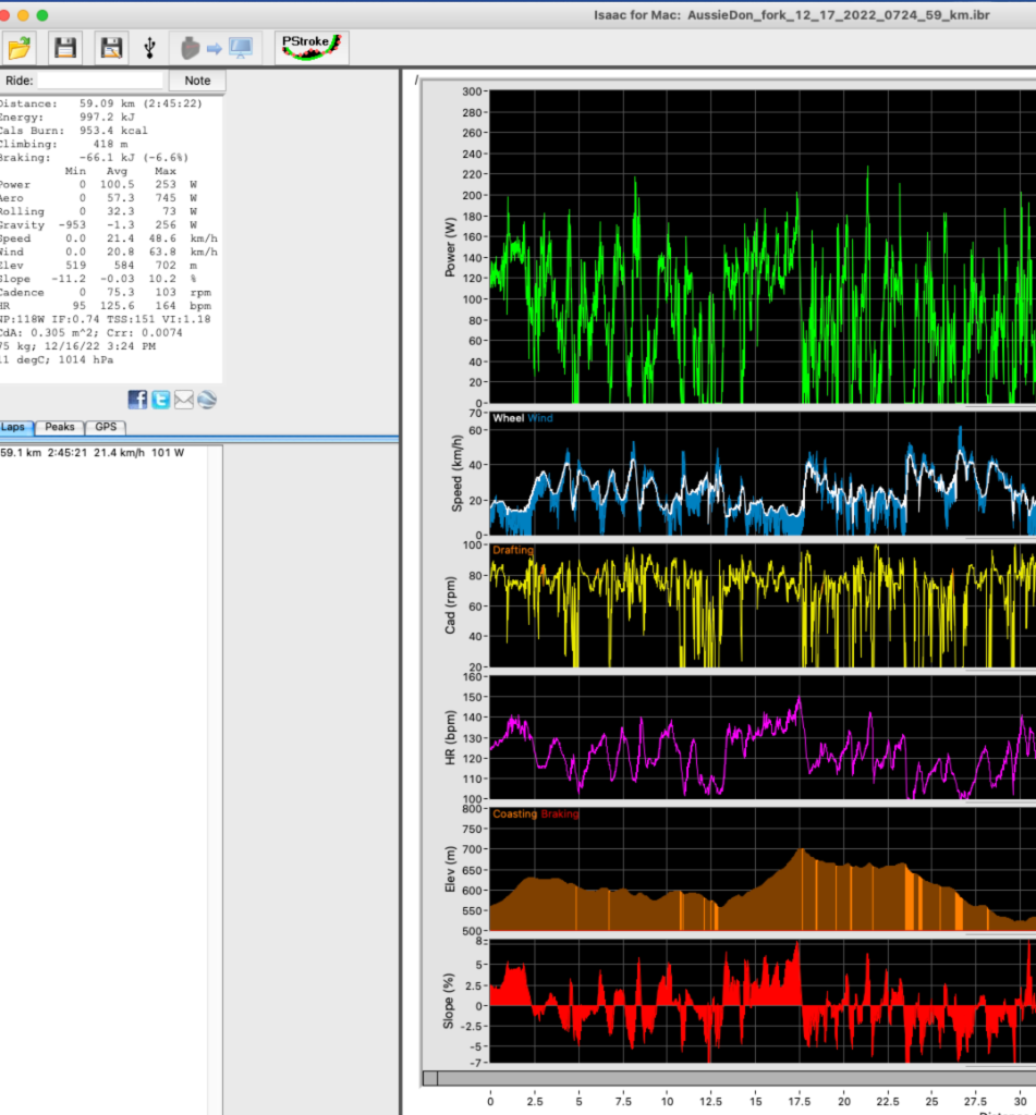

3) The biggest factor affecting your watts is wind. On the 12/17 ride (fork) you had a net tail wind for the ride of -0.6 km
Fork stats.png (409.9 KiB) Viewed 33258 times
On your 1/28 ride (bar) you had a net tail wind of -2.9 km/h
Bar stats.png (278.18 KiB) Viewed 33258 times
Riding In a tail wind takes less power, and the stronger the tail wind, the less power is required. . You rode faster because the tail wind was helping you. You had lower watts because the tail wind was pushing you forward more than required to achieve the slightly higher bike speed.
I don't think the lower watts are attributable to the shock stem, and I don't think the shock stem is a material factor in your ride stats.
