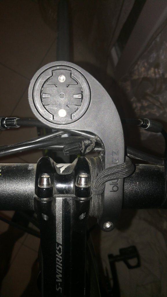

Please post an image showing how your PowerPod is mounted.
FedeSp
Posts: 23
Joined: Sun Jul 30, 2017 2:51 pm

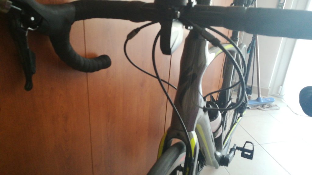

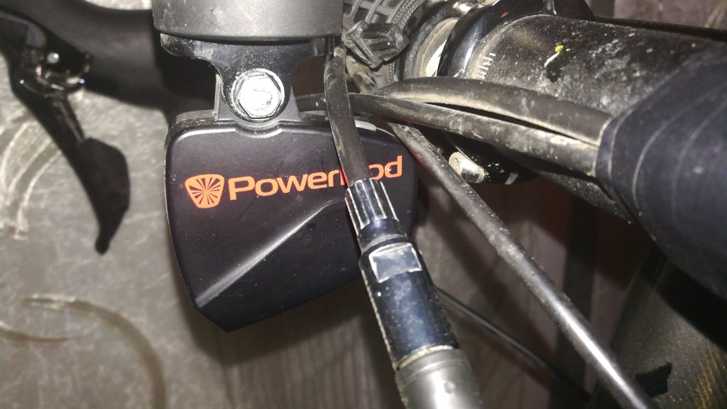

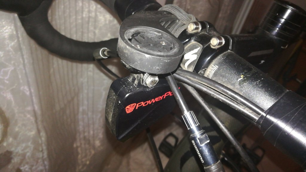

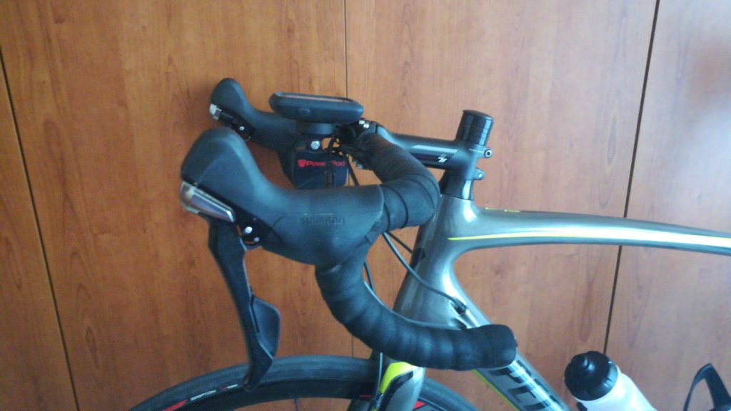

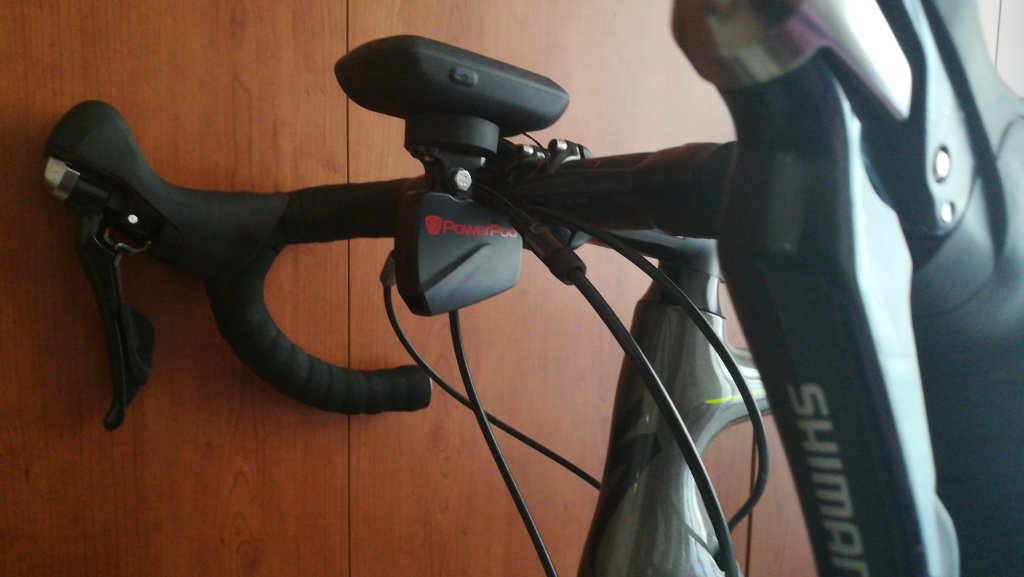

Re: problems revealing power downhill
Post by FedeSp »
could it be that it is still some degree positioned upward? let me know if the photos are ok. I look forward to hearing from you.
Federico.
Is your combo mount made from plastic? Who makes the mount? How is it attached to your bike?
Please post images of your mount, without the Garmin attached. I would like to get a precise idea of how it connects to the bike.

hi john the hard plastic thank you support and is firmly fixed to the handlebar to prevent it from moving. the lower part is made of metal and the screw is as tight as possible for the same reason. your Italian colleague some time ago told me to put the writing parallel to the ground. I noticed with a bubble that the writing is tending upwards, this could offset the slope downhill?
I am very concerned that this mount, even though made of hard plastic, has flex in it. If it vibrates during your ride, this will cause problems for PowerPod.
If, when you push down on the mount, it flexes AT ALL, then it is not stiff enough.

I confirm that the frame does not flex I did several tests. I noticed that the writing is not parallel to the ground. I could try to put it parallel, recalibrate and see what happens. what do you say?
Yes, please try that.
