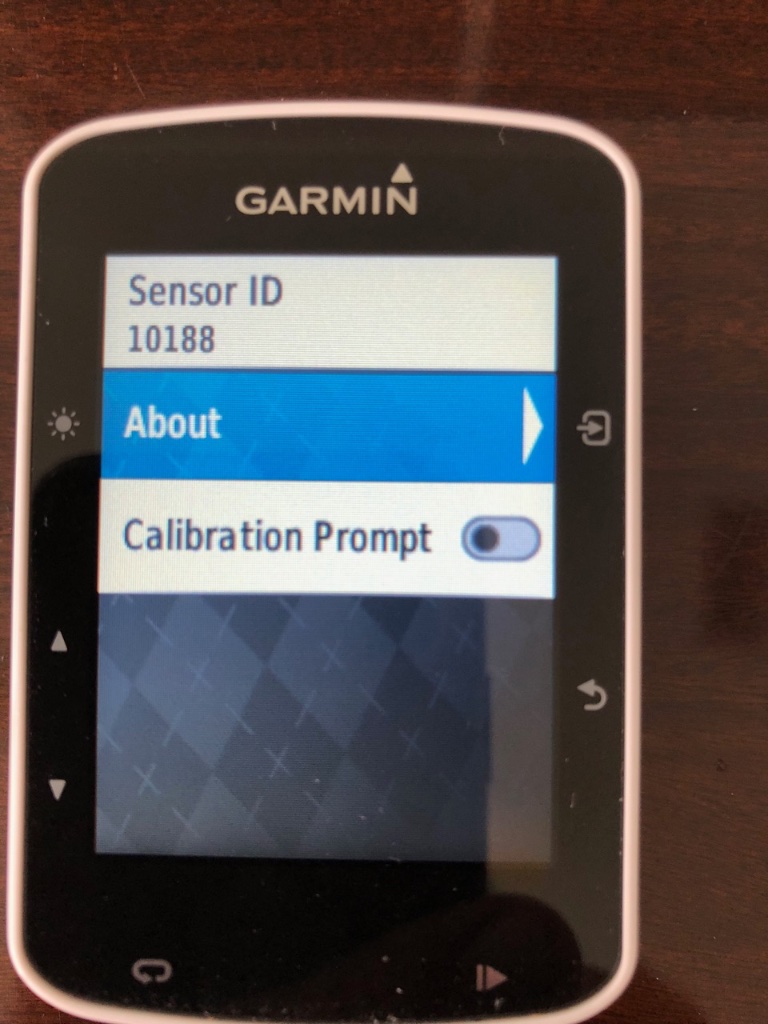

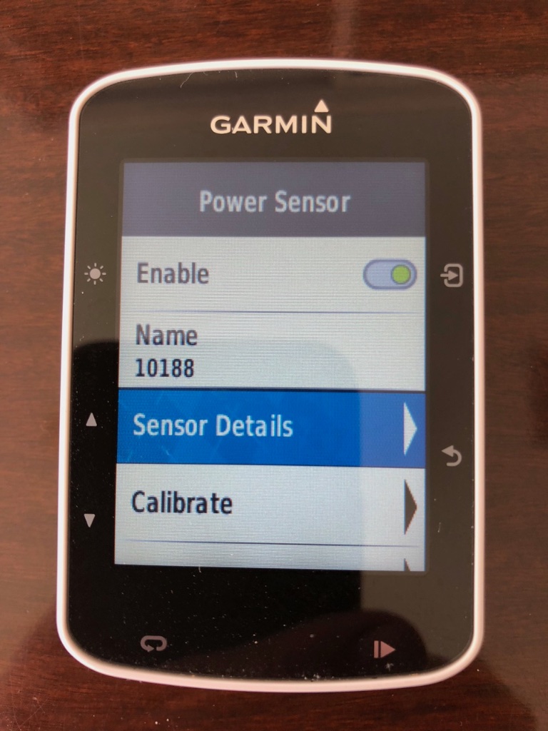

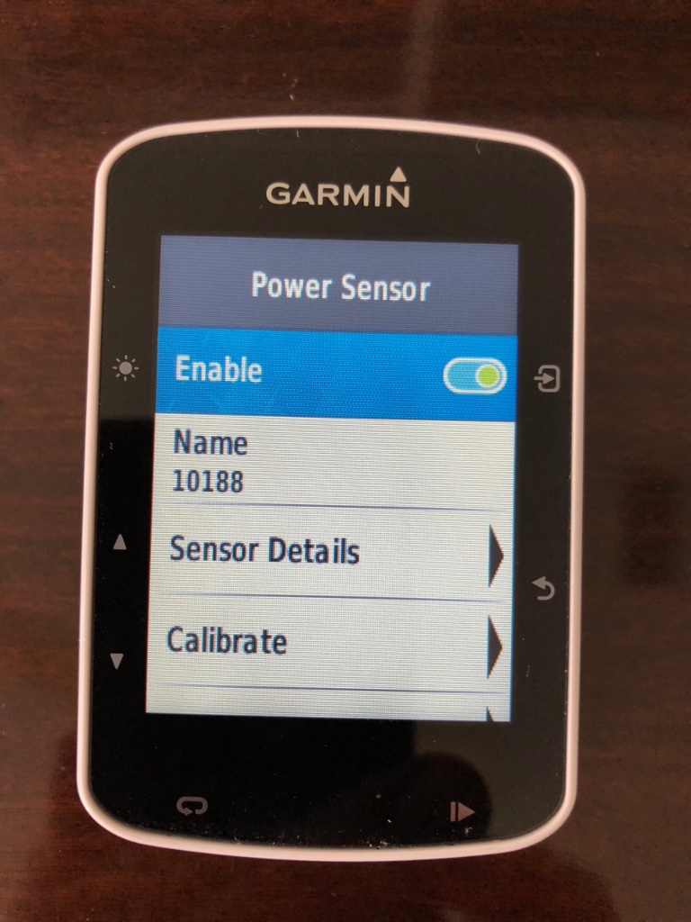

1) On your Garmin, select "Power Sensor". This will be your PowerPod
2) Select "Sensor Details"
3) Select "About"
4) You will see your current Battery Status at the top of the "About" menu
A. "New" is greater than 90% battery charge
B. "Good" is 70% to 89% charge
C. "OK" is 35% to 69%
D. "Low" is 20% to 34%
E. Critical is less than 20%

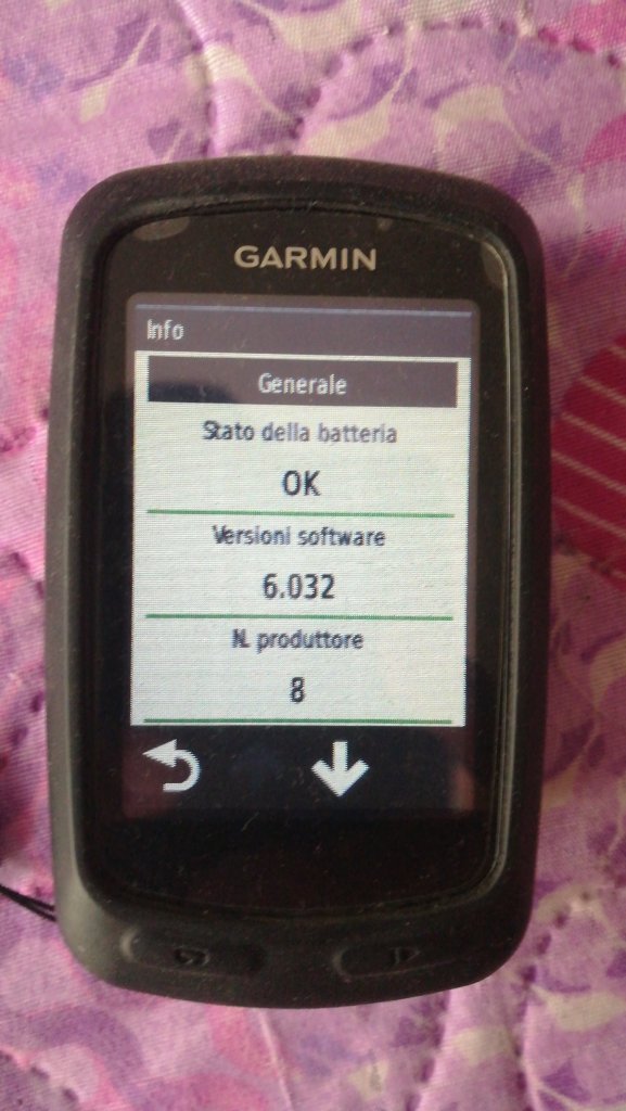

Posted: Thu May 03, 2018 3:41 am
by FedeSp
This is garmin 810
