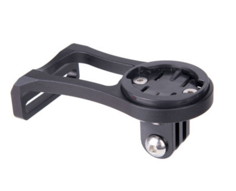

I use one of these on the TT bike without any issues.
Mounts on the front of the stem so no interference from hands or position.
- Screen Shot 2018-06-14 at 17.06.15.png (342.37 KiB) Viewed 5416 times
Re: Standard Mount with TT Bars?
It was bought here
https://www.ebay.co.uk/itm/ZTTO-Alloy-B ... 2749.l2649
It was a test to try it as i couldn't find a suitable mount for the bars.. only downside it doesn't have a stop so i have to make sure the powerpod logo is square to the ground each time, but it has worked just fine.

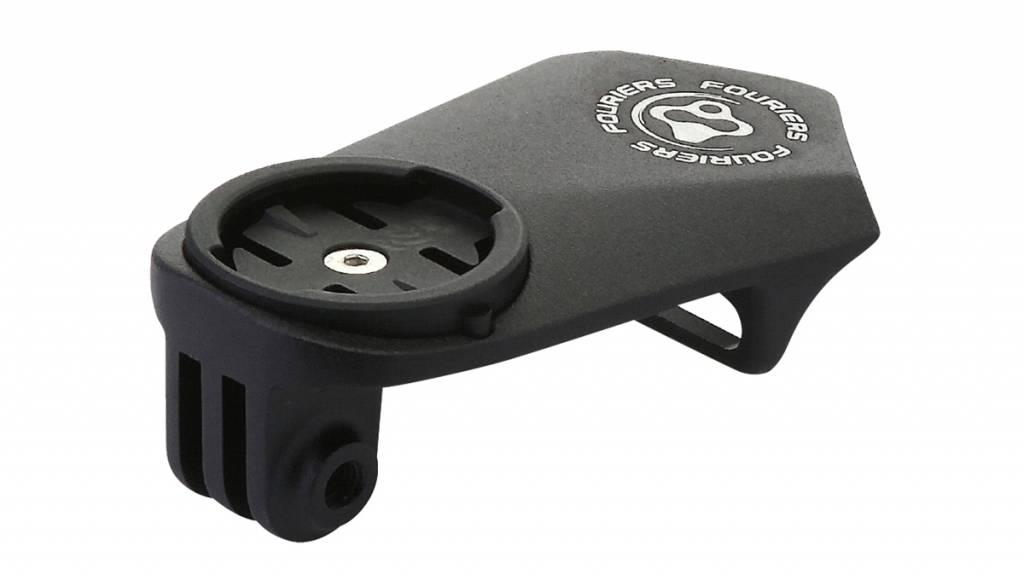

This is the stem mount I have. I will need to fit it on the top bolts of the stem rather than the bottom due to the pointed end of the mount. I think this may mean that the airflow into the wind-port will be disturbed by my hands on the aerobars. I might just set it up anyway and do a test ride at the weekend. I have a rough idea of what wattage I should be producing.

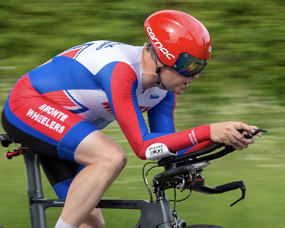

Can't see your hands causing an airflow problem unless they are below the Powerpod.. if so you have a fantastic aero position.
This is my setup with the stem mount.. no interference at all.
- 77016596-Adept+Cycling+T252-3_2018-6-9_14217.jpg (109.34 KiB) Viewed 5400 times
