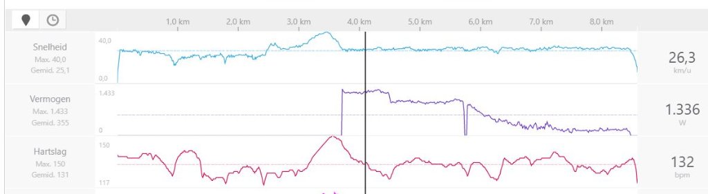

Most start of any ride (though having calibrated the device) the watt readings are far beyond I am able to produce. Sometimes up to 3300 watts.
Only after half an hour the readings drop to a more acceptable level or even 0 for minutes.
The variation in readings ( 3sec interval) is normally between 35 and 300 watts. Very hard to know what wattage my effort really is.
Just the slightest movement on the unit makes the readings utterly useless for minutes.
After pausing my ride it will take 5-10 minutes before the readings come up again.

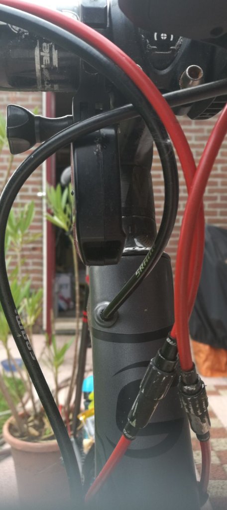

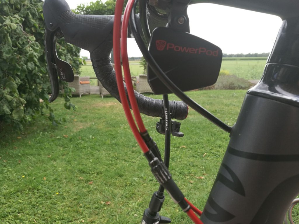

Also, please post photos showing how the unit is mounted on your bike: top, side and front views.
Is your PP solidly attached, such that it cannot rotate AT ALL when bumped?

- velocomp side.jpeg (129.92 KiB) Viewed 7033 times
- velocomp frontal.jpeg (69.43 KiB) Viewed 7033 times
Re: Weird readings
This looks OK. Does the PP rotate AT ALL if you push on it? If so, it is not tightly enough attached.
Please post the .ibr ride file from Isaac.

Any love from or comment from Velocomp here would be greatly appreciated. Here are the ride files where the PP went nuts and initially showed way too high numbers then ended up with numbers that were really really low for the effort I put in (should have been about a 140-145W average). And the date was set wrong - to 7/20/18. What's up with that??

Re: Weird readings
0545 ride:
1) your PP was bumped at the 14 minute mark.
2) it looks like your wind sensor was obstructed around the 1:45 mark. Were you riding in rain/mist, or did you draft?
0011 ride
1) PP recalibrafed itself during the first 90 seconds
2) the rest of the ride looks OK
If your date was 7/20 this means either you did a hard-reset of the unit, or your battery was dead. When either happens the date/time in PP is lost until you reconnect it to Isaac
0011 ride

Appreciate the response John. Actually the unit was totally charged (anxious about not being charged for the big ride) and no drafting and no obstruction. (Don't mean to sound like an orange haired political figure). But how do you explain the second bump to over a thousand watts? Seems really weird and gives the feeling that I can't trust the device. I bought it for the purpose of being able to use it on two bikes without having to buy a Power Meter for both.But if I can't trust it, it's a power meter for neither.

Re: Weird readings
Sorry, I meant to comment on that but forgot.
On the 0549 ride, at the 15 minute mark, your PP was knocked out of position. It was pushed up, skyward, causing watts to go crazy-high until the automatic tilt correction fixed things about 90 seconds later.
Make sure your PP is solidly attached and can't be rotated. That should fix things.
