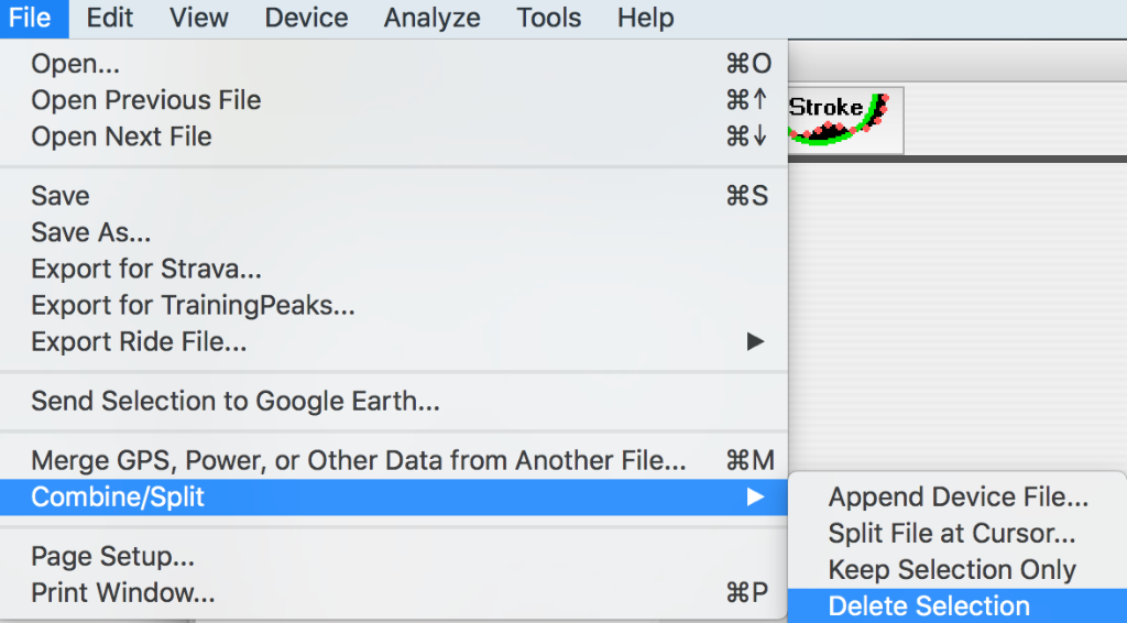

@John, when you say edit spikes out of your ride do you mean remove sections of the ride or is there a way to adjust cda / power just for a section? I also see that there is a repair for blocked windport function but even after reading the instructions I'm not sure how to use it, can it be used selectively? How would you know the wind speed?
If there is a section of the ride where you know you were pedaling downhill in a tuck, and that section is screwing up your ride stats, highlight that section in Isaac, then use the command below to delete it.
