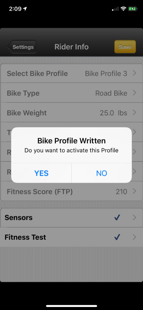

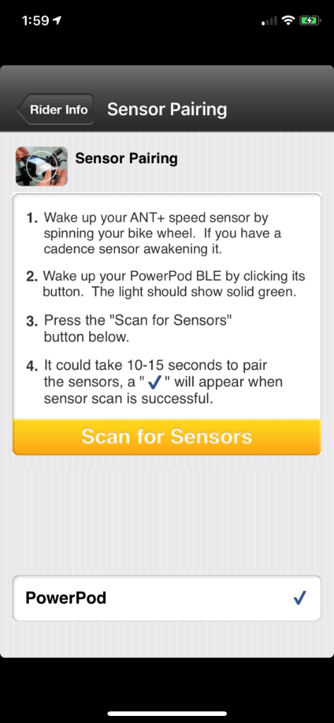

Believe it or not, your wishlist is already half-complete!
BLE owners can use the FREE PowerHouse Bike ["PH"] app (available both on iOS and Android) to update weight etc.
1) Open the PH app
2) Touch the settings (Gear) icon in the bottom right
3) Touch the "Rider, Bike and Sensor Setup" button at the top to access the "Rider Info" page.
4) Wait for a checkmark to appear next to "Sensors" at the bottom of the Rider Info page. NOTE: THIS WORKS BOTH WITH POWERPOD AND AEROPOD. When the checkmark appears, your BLE Device is talking to the app (note: ANT-only PowerPods, and first-generation BLE PowerPods from early 2016 [serial number includes "83"] won't work with the app)
5) Touch "Select Bike Profile" and select the profile you want to update
6) At the top right of the Bike Profile page, touch the "down" arrow to update each of your settings.
NOTE: If you have used Isaac previously to set up the profile, you'll need to enter in your bike, rider info again into the app. The app will "remember" these settings
7) Touch the down arrow to enter each of your settings
8) On the last page, (Rider FTP) the "down" arrow greys-out--there is no additional information for you to enter. Touch the "Rider Info" button at the top left of the screen
9) Touch the yellow "Save" button at the top right of the Rider Info screen. Your info is saved to the app and is transmitted to your device
10) You will get a screen asking if you want to activate the profile. If you do click "yes". Your device will switch to the profile you just entered.
Wireless sync: this is not a trivial change to make, but it is on our road-map for the future.
