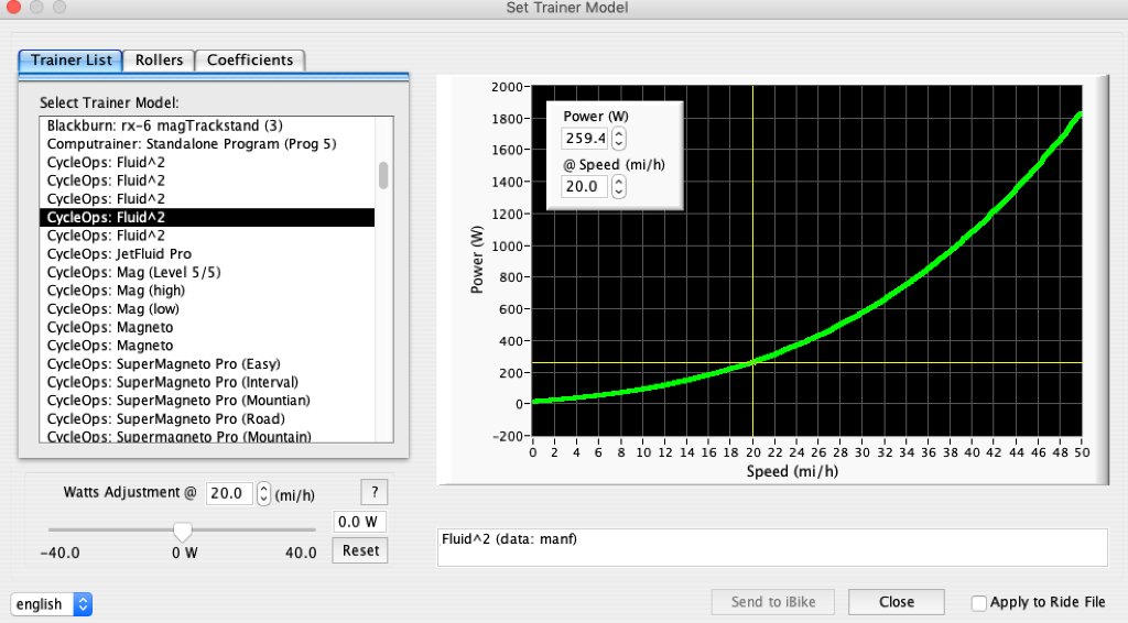

I have a cycleops fluid-2. How am I suppose to chose one of these profiles!?

OK, I did a ride with the first (lowest?) power curve for my cyclops. I also dragged the power adjustment slider all the way to the left (lowest setting) and applied in Isaac to try and lower the power but it is way too high for the perceived effort (and HR) vs what power I see with the same effort in real life on flats and moderate grades.

The different curves come from different people who tested it. You will see the name of the source below the graph.
I would use #4; this data came from the manufacturer.
Screen Shot 2018-11-11 at 5.56.39 AM.png (132.95 KiB) Viewed 5002 times

Velocomp wrote: Sun Nov 11, 2018 5:58 am
funkiestj wrote: Sat Nov 10, 2018 9:54 pm I have a cycleops fluid-2. How am I suppose to chose one of these profiles!?
I tried that one and with the slider all the way to the left
Image and my feeling is that the estimated power is 20-40 watts too high. How can I adjust this?
EDIT: nevermind ... I tried all the others and the first curve looks like the best fit (so far). I'll try that one out for a while.
I see that I can edit coefficients but I have no idea how to tweak these to get an appropriate curve so if it comes to that I'll be looking for help
