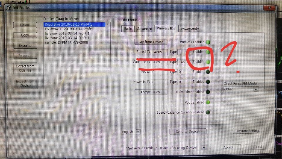

5. so, i connect pc and check isaac program
6. i check the profile1. there is speed sensor and cadence sensor both enable even serial name is correct!!!!
7. that mean pp already paired with speed&cadence sensors, i could cal riding??
8. but push pp botton, it's solid red light!, not solid yellow!!!!
9. and than, i tried more times.....sometimes flash green light;;;;that mean there is no paired cadence sensor.....huh?
10. for cal riding, i must check soild yellow light, but i never see that......

Sensors not paired with my powerpod
- sensors are enable on isaac, check serial name
- speed&cadence sonsor enable.jpg (157.8 KiB) Viewed 5102 times

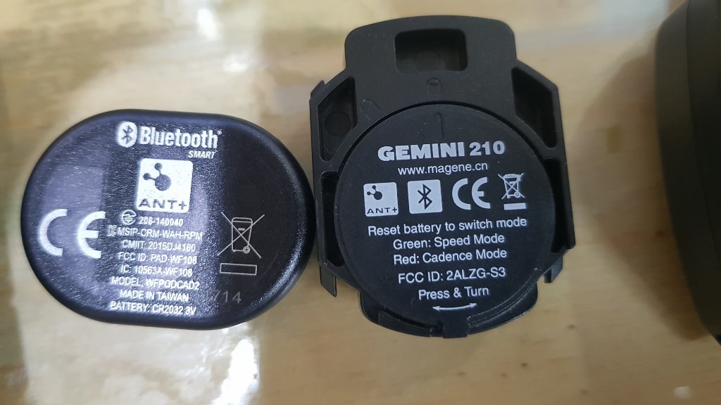

- ant+ sensor serial name
- ant+sensor serial name.jpg (55.71 KiB) Viewed 5102 times
- both seonsors are ant+ possible
- both sensors are ant+.jpg (85.8 KiB) Viewed 5102 times
Re: Sensors not paired with my powerpod
It looks to me like you have TWO speed sensors, both of which are "on" (speed sensor icon is shown in your smartphone app):
Wahoo "24605"
SCR "2069"
It looks to me like your Gemini sensor (ID 2069), which you say is a cadence sensor, is transmitting as a speed sensor. Make 100% sure the Gemini is set up as a cadence sensor (red).
You can also do the following:
0) Pair your speed and cadence sensors to your bike computer. Spin the wheel and crank, and confirm on your bike computer that the speed and cadence sensors are working properly.
1) Reset PP: press-hold the PP button for about 12 seconds. The light will start flashing after about 4 seconds. Continue to hold the button until the light goes out for a moment, then starts flashing again. Release the button. This does a hard-reset of the unit.
2) Remove the battery from your speed sensor. Put the battery, BACKWARDS, into the sensor for just a moment. This does a reset of the speed sensor. Remove the battery and replace the battery normally.
3) Make sure your cadence sensor is awake and is configured as a cadence sensor.
4) Pair your speed and cadence sensors to your bike computer. Then, spin the wheel and crank and confirm, on your bike computer, that you are seeing speed and cadence readings.
5) Do a new PP sensor pairing (press-hold button for 4 seconds, until light flashes, then release button). You should see red flash 3 times (cadence paired) then solid green (speed sensor paired).
Hopefully this will fix things. Let us know!
Wahoo "24605"
SCR "2069"
