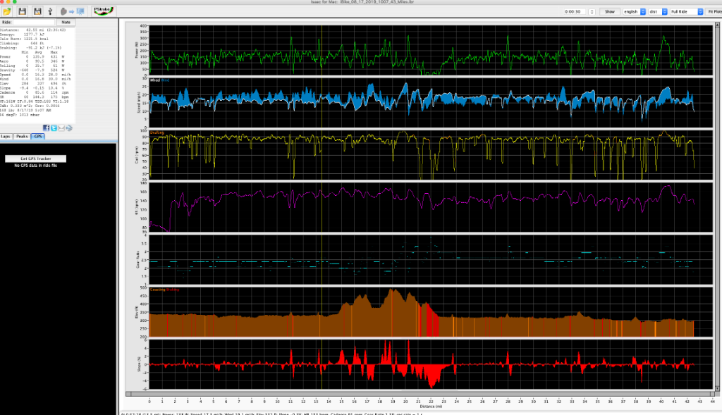

I decided to re-calibrate the PowerPod. Once this was done, I followed it with a solo ride, and I've uploaded that ride file for you to take a look at. The route I took was essentially an out and back (out predominantly into the wind and back predominately with a tail wind). I didn't start and finish in exactly the same place but I didn't draft at any time. I thought the power numbers displayed looked pretty good and tended to match my perceived effort, given my FTP. I did notice though that the power looked a little low at times with a strong tailwind (lower than my RPE) changing to more meaningful numbers after 30 seconds or so. What do you think?

This looks much better after re-doing your calibration.Dampman wrote: ↑Sat Aug 17, 2019 11:40 am Hi John,
However, your PP rotated in its mount at mile 22. It took 90 seconds to re-stabilize the reading; this is why your watts are low from mile 22 to 24.
To get a sense of the effects of wind I set averaging to 30 seconds. I think you are OK; on the return portion of the ride, where tail wind predominates, your watts are down a bit--but so is your heart rate.
