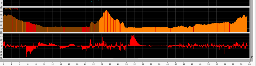

Your PP is not securely fastened to the mount and is rotating. This happened multiple times up until mile 34 of the ride (look at the slope plot).
Tighten PP so that it cannot rotate and you will be OK.
Screen Shot 2019-08-17 at 7.04.02 AM.png (40.86 KiB) Viewed 1780 times
