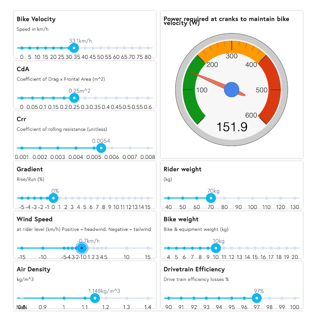

3) I used this website to check your readings.
The site calculates exactly the number same as your PP measurement! So, either your measurements (bike speed, slope ,wind) are wrong, or your perception is wrong.
4) I see headwinds and tailwinds at the end of your ride, just as you describe
Based on all the above I don't see any measurement basis for concluding your watts are low, unless you are not riding a TT bike.
I appreciate that you feel you are doing more...but the measurements say otherwise. Sorry
1) your unit seems to be well-calibrated. Wind speed and slope readings are completely normal
2) You have this set up as a TT bike. Is this correct?

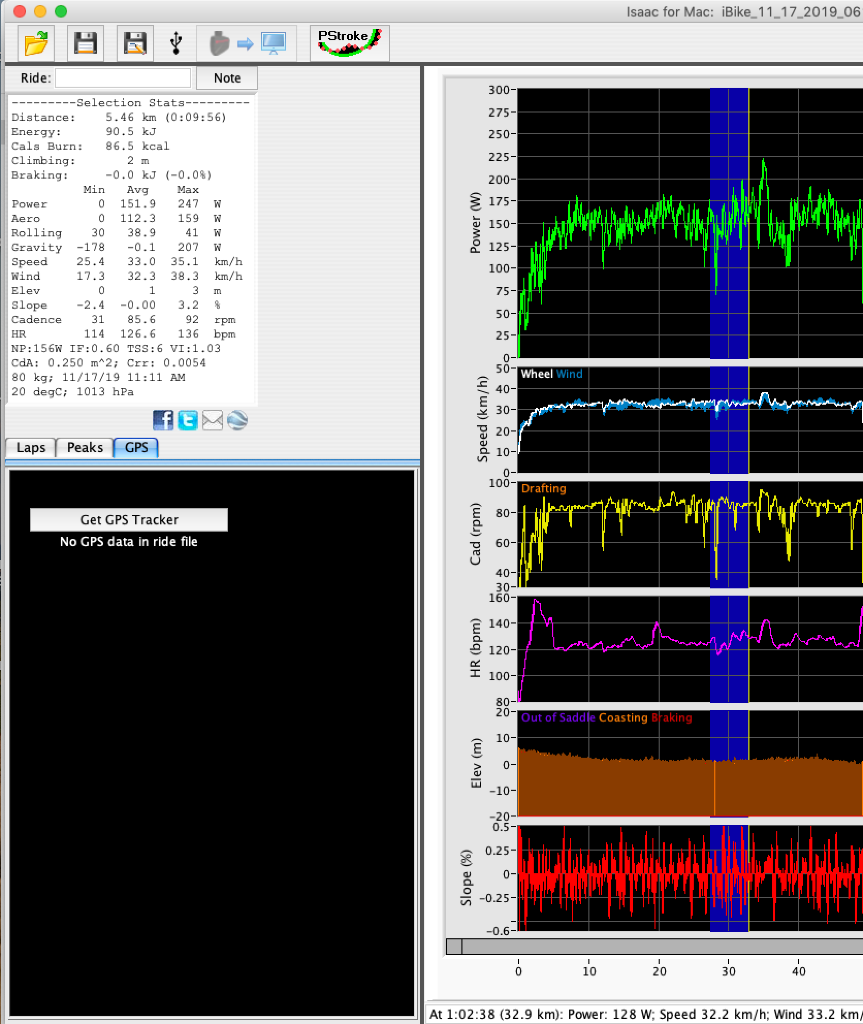

Re: PP V3 - frst calibration
I picked this section of the ride because conditions (slope and wind and speed) were constant. There was very little headwind early in the ride (blue wind speed is very close to white bike speed).
Your ride file shows headwinds towards the end of the ride (blue wind speed is above white bike speed). Your speed is lower but your watts are about the same (158W).
I think your ride file is totally accurate.
