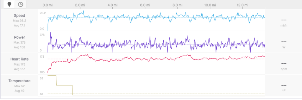

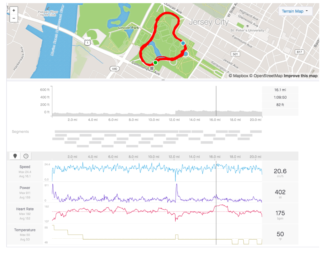

So I just got a new power pod. I was super excited but have had a few hopefully minor setbacks. I will list them below. Hopefully you guys can help.

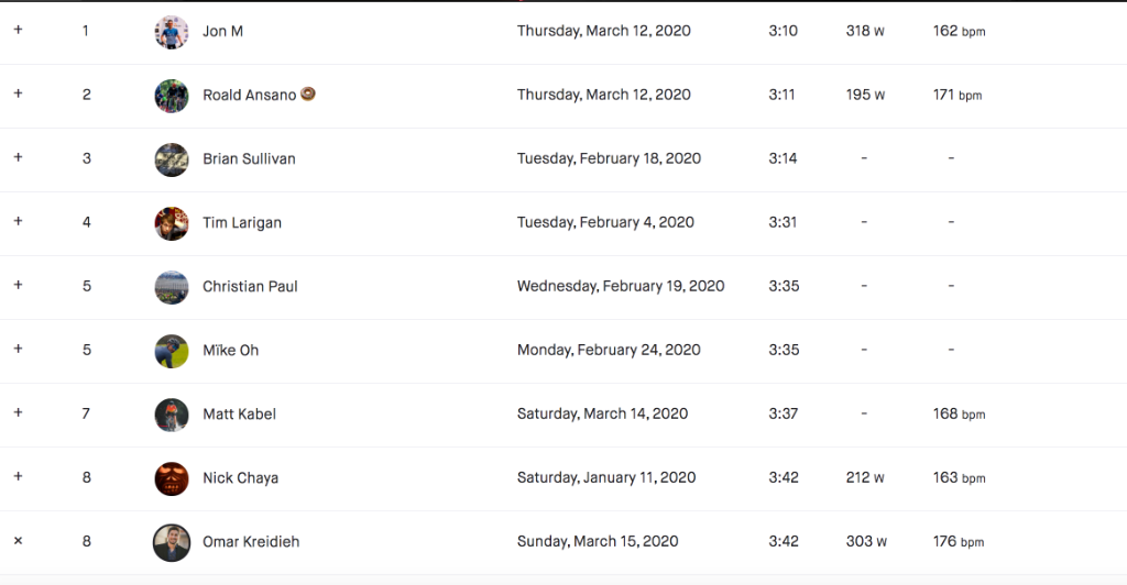

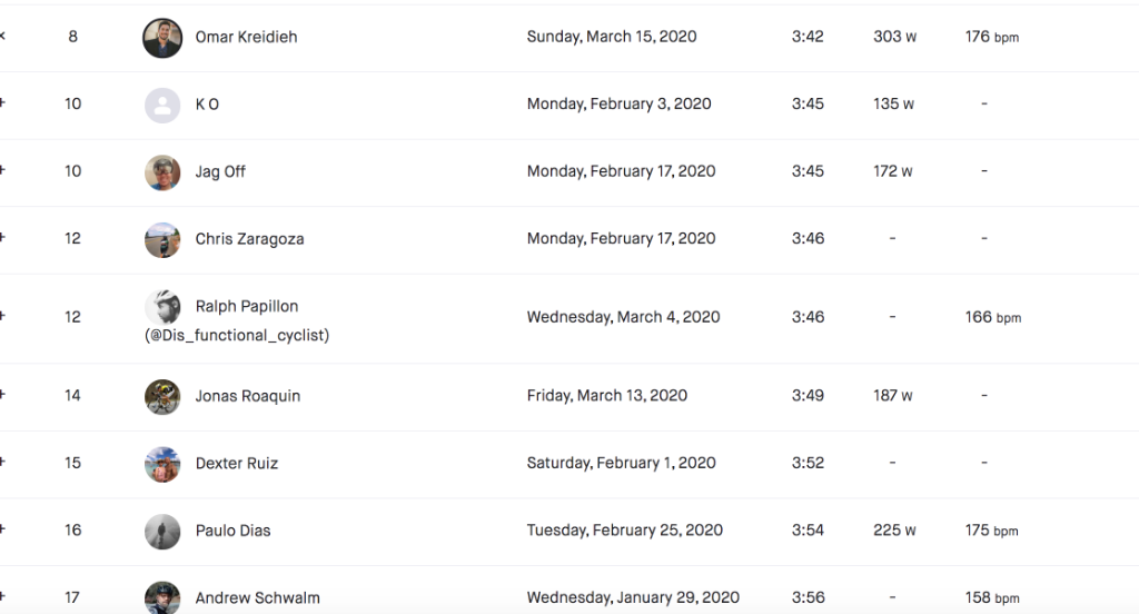

1- For some reason my Isaac software says my device is not enabled to allow downloads to Isaac. It caught me off-guard that important software isn't functional out of the box for the device and I may have to pay for it. But even trying to bypass that and access the data files for analysis on strava doesn't work because powerpod isn't showing as a USB/ disc on my mac. There is no way to see the files on the powerpod other than the fact that the files show up on a list when I open Isaac and click on download data ( it just doesn't let me download it).
2- The numbers I get may be too high? This is my first power meter so i am obviously not sure about this one but lets just say I am awfully suspicious something is off about the numbers. I gained access to the data through my cycling computer. I uploaded them to strava form my cycling computer and I was able to compare the values to both strava's estimate when the ride is uploaded without the powermeter data ( from my phone), and comparisons to other riders who rode the same track on the same day or during winter. ( wind conditions were average for the area/ winter).
Screen Shot 2020-03-16 at 7.40.58 PM.png (129.4 KiB) Viewed 19270 times
Screen Shot 2020-03-16 at 7.41.08 PM.png (141.89 KiB) Viewed 19270 times
You can see from the above attachments that riders much faster than me did the time with far less wattage. In-fact, even though i am average in weight ( 163 pounds), and the conditions were average for this year, very few racers either faster or slower did power values close to what powerpod thinks I did. You could come up with other theories like maybe I just expended wattage in the wrong parts of the track etc. I don't think thats the reason because I am relatively new to the sport and not as strong/ fast as others. Also it is unlikely that I would both produce higher powers and that I would be so inefficient so as to waste a third of my power to come up with the same race time as people with 200 watts ( mine was 300).

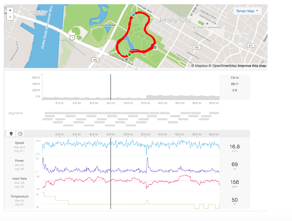

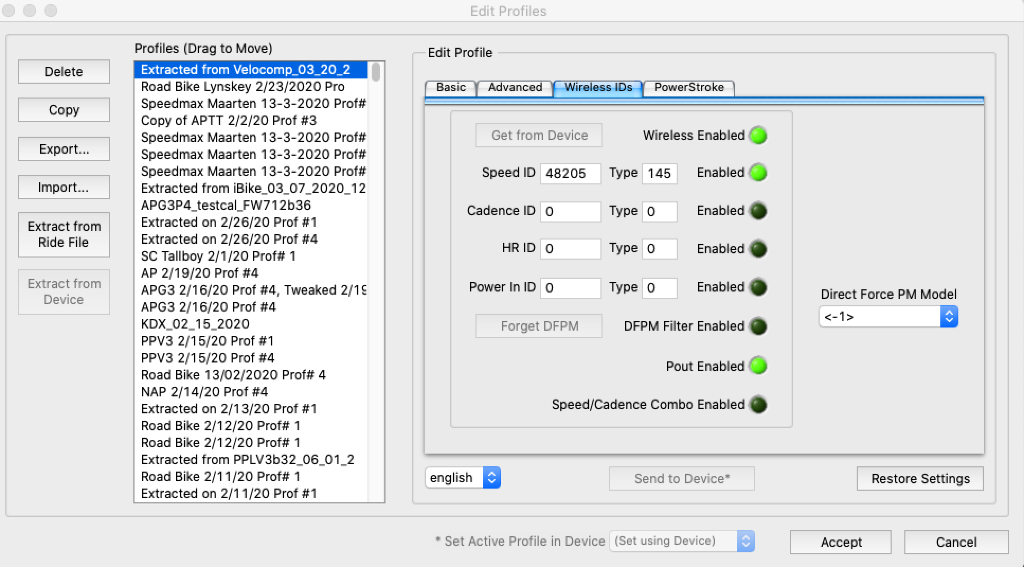

Now to figure out the issue I had hoped to see the Powerpod data. My computer ( data below) shows speed and altitude IT sees so its not helpful. I needed the powerpod data to compare to my computer data to figure out ... is the speed Powerpod is seeing off ( maybe my speedometer is wrong). Is the wind measurement off? Is the altitude off? But i can't access that data due to issue number 1.
Screen Shot 2020-03-16 at 8.03.33 PM.png (51.11 KiB) Viewed 19270 times
3. This is more related to the website. I kept going back and forth about getting this product. I ended up getting the refurbished unit on a budget. I had seen the BLE upgrade key online and thought that if mine didn't work with my smartphone I would just upgrade then. I think my misunderstanding came about from seeing you mention specifically that powerpodlight was excluded. I did not imagine why my powerpod would not work since as far as i could tell it would be a regular powerpod just refurbished. Now after getting it I find out it doesn't work because you guys blocked refurbished units. I think it would be helpful for you guys to add a note specifying powerpod refurbished as well as light so that others don't fall into the same trap like me. I emailed you guys'/ tech support to help me figure out if there is a way to bypass bluetooth and still get it to connect to my smartphone as that is an essential feature for me :(
Re: New User with Issues
1) Please email technicalsupport@velocomp.com for next steps.
2) We don't transfer files as a USB drive.
3) Which rider is you?
4) It's impossible to tell from your data what is going on in enough detail to reply to your questions.

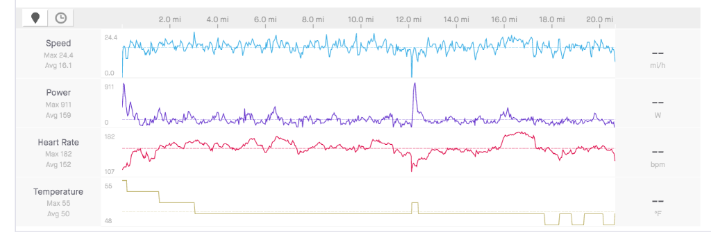

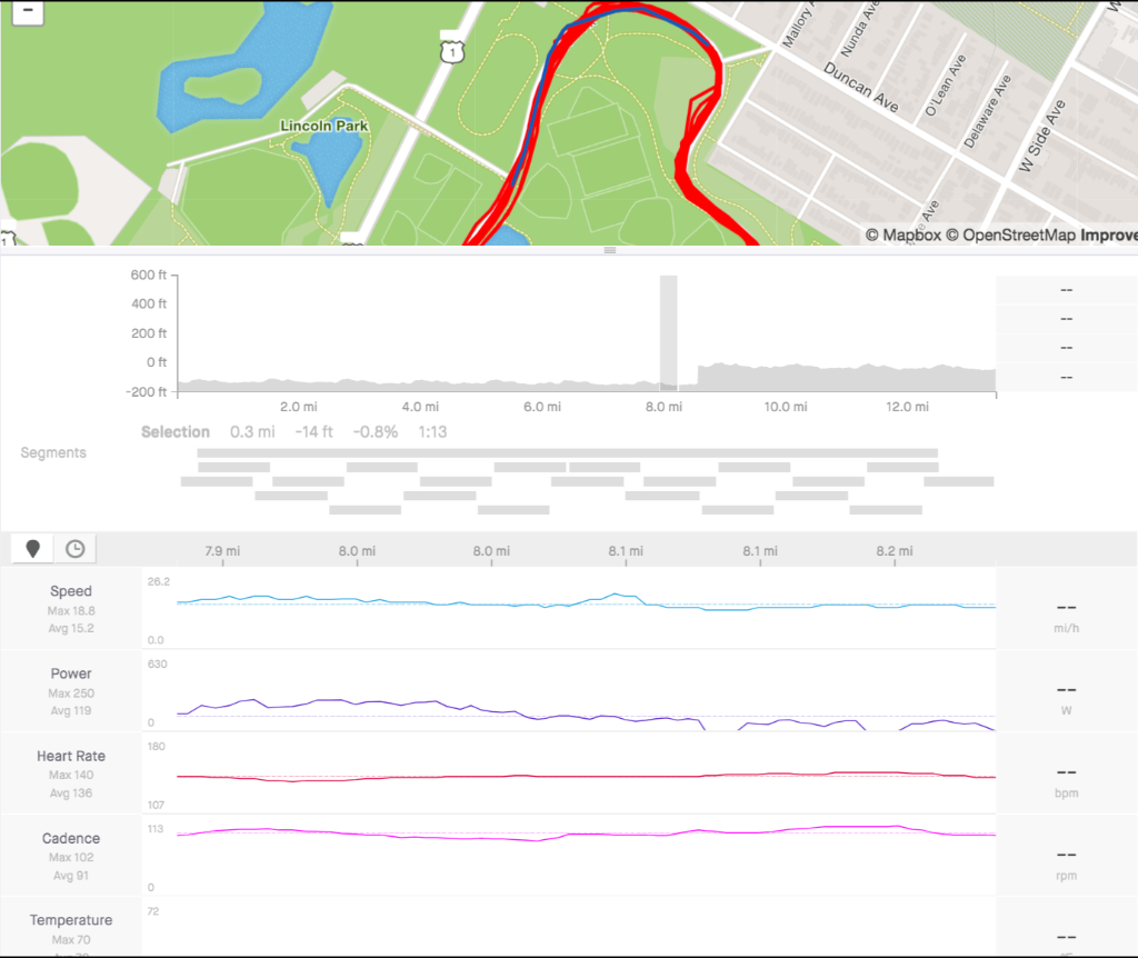

There were 2 obvious issues that came out though.
Issue 1: In one area which was a slight decent with a strong cross-wind the power seemed very overestimated. See this image to see the location.
Screen Shot 2020-03-17 at 8.30.29 PM.png (399.25 KiB) Viewed 19211 times
In another region opposite this one on the way back, the power seemed very under-estimated:
Screen Shot 2020-03-17 at 8.51.39 PM.png (355.97 KiB) Viewed 19211 times
In both areas the wind felt like a strong cross wind. I had no issues in the parts where there was mainly a headwind or tailwind. Because it was mostly at cross wind areas I stopped in the middle thinking maybe the device was angled so that it was facing the cross wind more than me in area 1 and less than me in area 2. On inspection it seemed very close to parallel to my bike but I tried to optimize it as much as possible anyway. The numbers maybe got better in one part or it was a placebo effect. But I was definitely still getting the low values on the way back despite the steady effort.

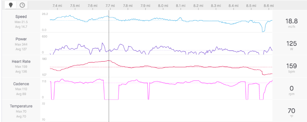

Issue 2: When I would stop for a bit and start again, the power readings being transmitted were ridiculous. Like 900 watts, 800 watts. you can clearly see the stand-out spikes on the full file.
Screen Shot 2020-03-17 at 8.48.13 PM.png (91.45 KiB) Viewed 19211 times

Also in retrospect, my powerpod sits slanted a bit vertically ... do you think this may have something to do w the issues? ( Not sure how this would come into play in only some of the segments though)
This is your problem...the instructions say that PP should be approximately level to the ground. Yours is pointed way up in the air; this will cause calibration failures!
1) Reattach PP so that the word "PowerPod" is approximately level to the ground beneath it (it does not need to be exactly level).
2) Press-hold PP button for about 12 seconds, until light goes out temporarily, then turns back on. Release the button. This does a hard-reset of the device
3) Pair PP to your speed sensor.
4) Do a new calibration ride and all should be well.

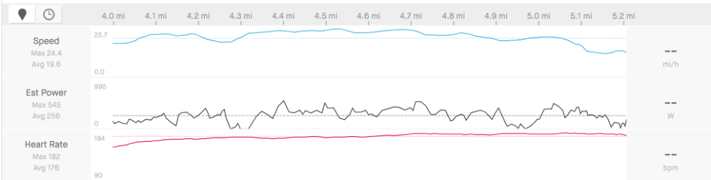

I adjuste the position as advised and recalibrated. The first ride yesterday went well ( average winds 2 mph). Im not experienced with powermeters so can't claim to be 100% sure though.
The second ride was in windy atmosphere again and the same issues resurfaced. In the same spot I was having much higher reads than expected and then the opposite area was getting much lower reads. In fact in the decent with the strong wind and high reads, I went several times without pedaling ( had a cadence meter on this time), and was still shown power readings sometimes up to the 150s w/ 0 cadence. I have attached the two rides below and a picture of the powerpod now. Please advise.
Windy ride. Notice power values up to 150 during the short decent with wind and 0 cadence, dropping HR.
Screen Shot 2020-03-20 at 8.30.31 PM.png (88.74 KiB) Viewed 19096 times
In other areas my power registers low numbers, down to 0 at times despite constant effort, similar cadence, and HR that is similar to average for this ride:
Screen Shot 2020-03-20 at 8.55.18 PM.png (307.41 KiB) Viewed 19094 times
Non windy ride which seemed ok:
Screen Shot 2020-03-20 at 8.28.46 PM.png (103.68 KiB) Viewed 19096 times
Trying to diagnose your detailed questions with the graphs you've provided is nearly impossible.
There is only one obvious problem: it appears that your cadence sensor is not paired to PP. I say this because, at mile 7.7 of your first graph, cadence is zero but power is not. If the cadence sensor is paired then power would be forced to zero.
In order to provide the kind of answers you're seeking, you'll need to download and install Isaac software. This will allow you to see wind and slope data along with power data.
1) Your cadence and HR sensors are not paired. I can see this because their signals are not shown in your ride file. Also, their sensor IDs don't appear in your profile Edit/Edit Profiles/Extract from Ride file
2) If weather changes then you will see the elevation drift. This is in your ride file
3) Power spikes are happening because your mounting position is changing between rides. You can leave your PP attached to your bike between rides (this is what I do) or you will need to be very careful that you reattach PP in the SAME angle. This is nearly impossible, so you may see watts spikes at the beginning of your ride
4) Do a new sensor pairing and then cal ride. This will add cadence/HR sensors to your ride file and make downhills better when you're not pedaling.
5) Your 3/20 ride shows huge headwinds/tailwinds. Your power responds accordingly.
