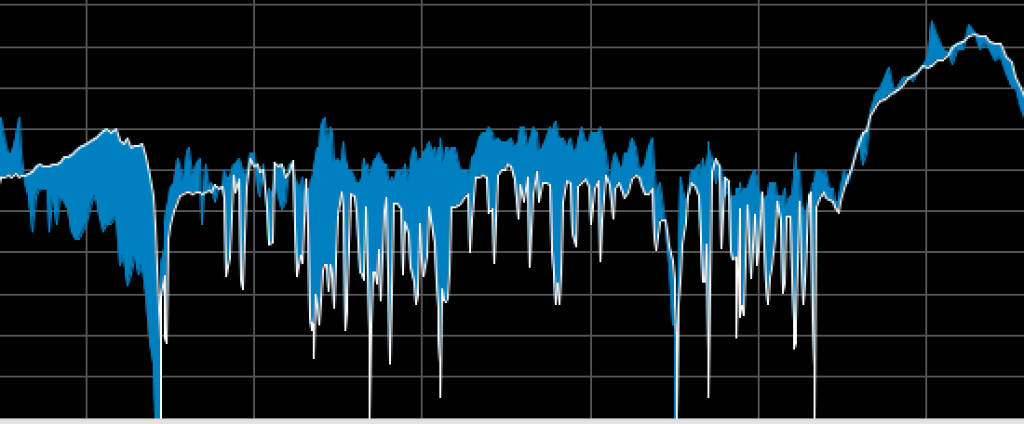

Your calibration is fine but your speed sensor is misbehaving (dropouts).
What kind of sensor do you have? If it's a hub sensor please put it on the front hub.
Also, it looks like your PP is rotating in its mount. Make sure it is tightened so that it cannot rotate in the mount.
Screen Shot 2020-06-26 at 7.46.42 AM.png (144.43 KiB) Viewed 7455 times

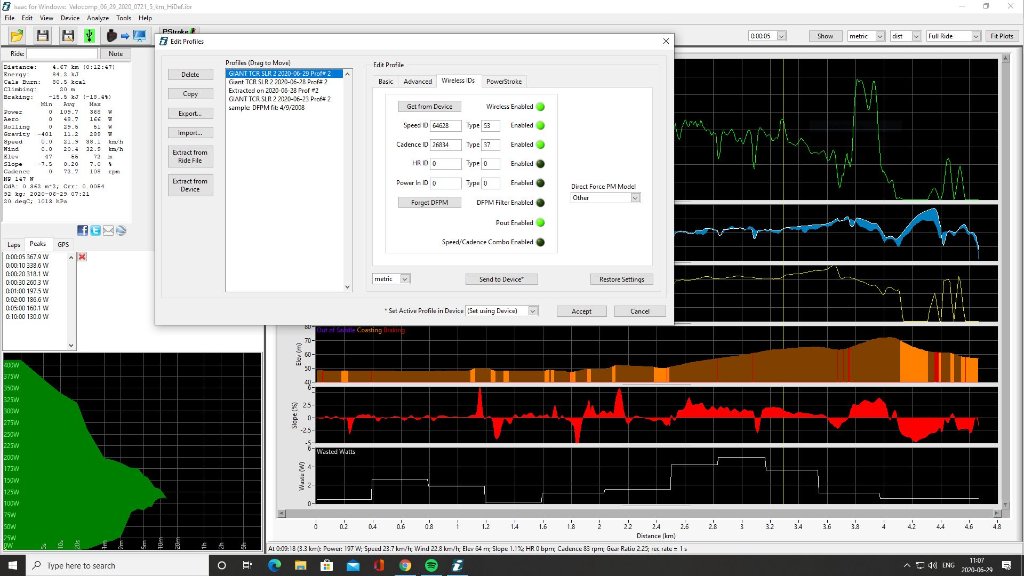

Re: Calibration check, please
Speed data looks good now, and it looks like your PP is tightly attached to its mount.
There is no cadence sensor ID in your profile. For PowerStroke you need a crank-mounted cadence sensor. If you do have a cadence sensor on your bike, then you'll need to do a new pairing and, likely, a cal ride.

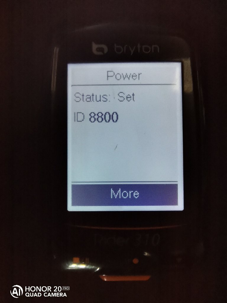

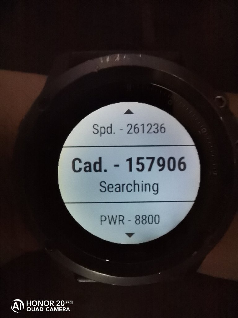

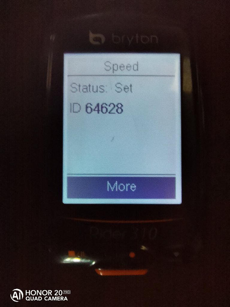

My bad, after going thru both Garmin watch and Bryton Computer unit. Found that the PP pick up the cadence and speed sensor via Bryton unit. I myself find it pretty weird. Attached are photos of Isaac, Garmin and Bryton cadence, speed and power sensor ID.

Oops! the photo is too big.... sorry. Here is the Bryton sensor id.
Latest ride file looks good. Cadence sensor is paired to PP.
