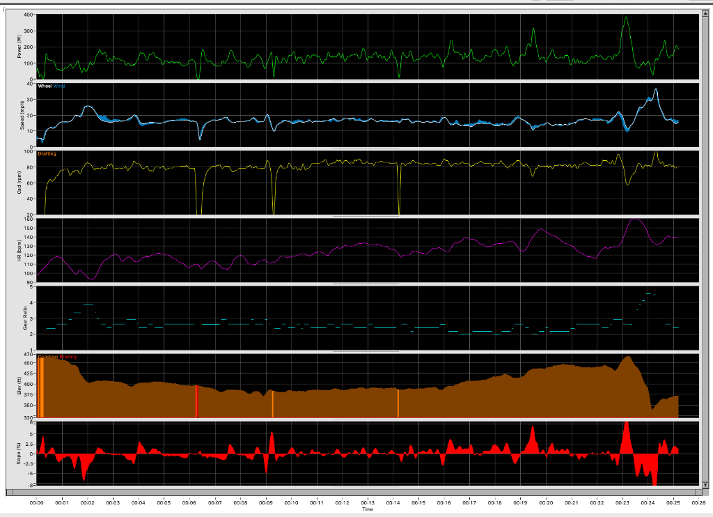

Here you go:
- Velocomp_07_03_2020_0612_0_km.ibr
- (77.48 KiB) Downloaded 354 times
Re: Did high humidity temporarily kill my PP?
Hmm...the ride file looks perfect, and there is no blockage of the wind sensor. There is nothing to suggest there was any water/humidity problem with your PP.
If you saw condensation on your Garmin screen then the problem might be with the Garmin.
- Screen Shot 2020-07-03 at 5.31.32 PM.png (139.54 KiB) Viewed 7040 times
