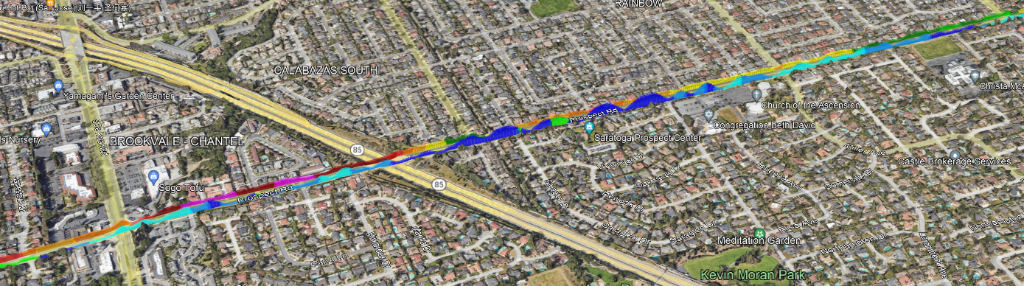

- between about 17 and 18.5 miles, it was mostly flat with a following wind. If I did any significant pedaling, power easily went up to over 600W. Here's a picture, power is vertical, hr is color.
- power-hr.png (790.35 KiB) Viewed 14886 times
Out was right to left, into a head wind (with power mostly between 150 and 250, and relatively high heart rate), and back was left to right with a following wind. But the sections where I pedaled on the return show huge surges of power (~600), with low heartrate.
I think both of these point to CdA being too high - but the fact that coasting always returned power to zero suggests (to me) that its probably not *much* too high.
Any suggestions?
[edit: Answering my own question: I went back to the 31 mile ride where I had concluded I needed to bump CdA up to 6.5 on the basis of a long descent that I had coasted down. But as I said in my original post, I *did* have to come to a complete halt part way down due to road works. And all the braking *except* for that short section goes away with a CdA of around 5.75. So changing it to 5.75 works well for that ride; and it also works very well for this one. We'll see what happens tomorrow, but I think 5.75 is looking good]

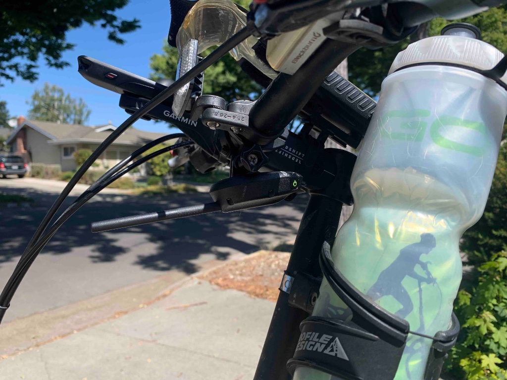

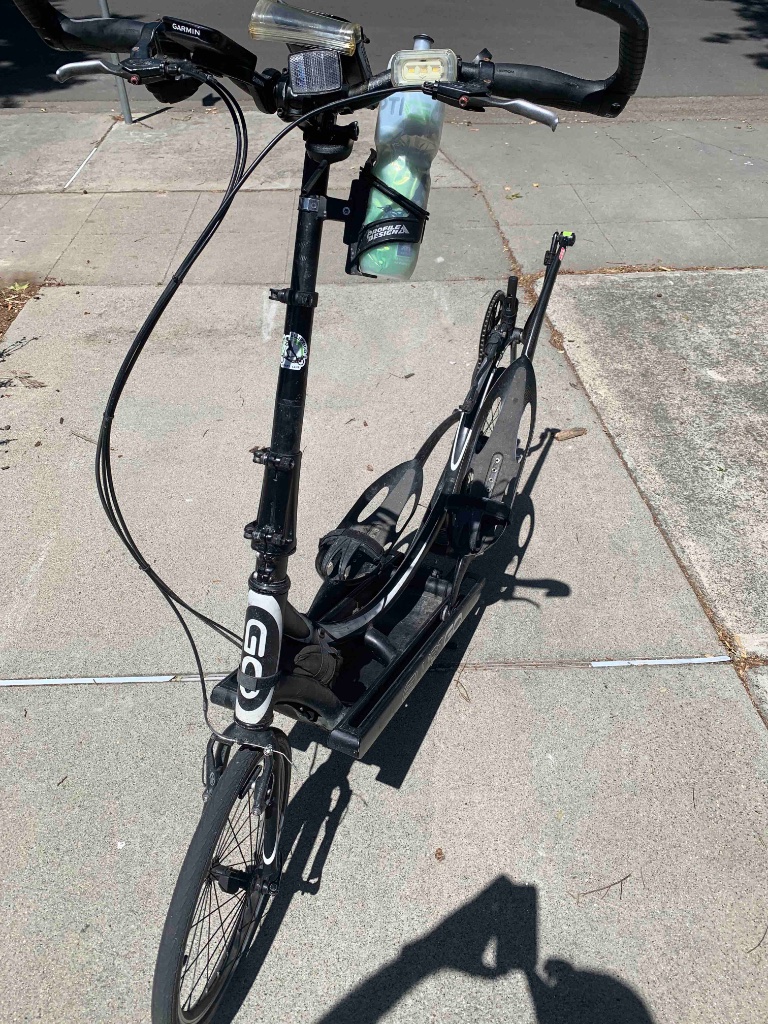

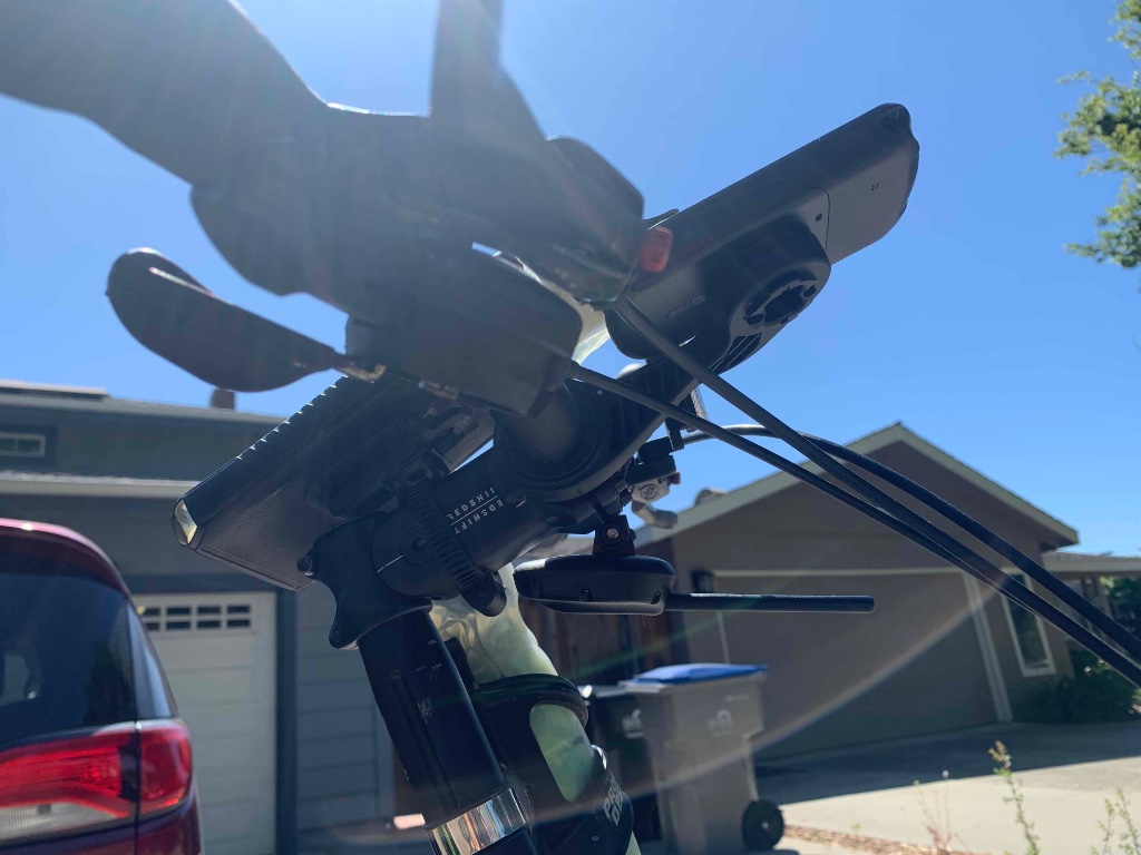

Anyway, thanks for all the help. You asked for pictures, so:
- IMG_3612 2.jpg (445.03 KiB) Viewed 14828 times
- IMG_3611 2.jpg (255.92 KiB) Viewed 14828 times
- IMG_3610 2.jpg (170.97 KiB) Viewed 14828 times
Re: PowerPod w/ ElliptiGo long-stride bike
Posted: Wed Jun 21, 2023 8:19 pm
I like it! Tell Elliptigo that you are using a power meter on their bike...and which one
