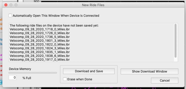

I've been having ongoing issues with my PowerPod since receiving it in the middle of August. I feel like I have more rides with issues than not. The past couple weeks I've been more focused on checking the connection on my Wahoo Bolt opposed to assuming I know what's happening based on a display of 0 watts for a period of time mid-ride, or what appears to be the PowerPod shutting off after taking a less than 5 minute break, or the LED doing weird things. I've had to do several recalibration rides after my attempts at re-waking the PowerPod mid-ride set it into recalibration mode and produces a new calibration profile. Last evening's ride is a good example of some recent experiences where everything seems good at the start:
Everything started off great - I woke up my cadence and speed sensors, pressed button on PowerPod, it went solid green light (great!). Then booted up Wahoo Bolt, everything connected, started ride, watts being properly displayed. Several minutes into the ride, even though everything was displaying properly I decided to check LED on PowerPod and realized it was flashing red/green, which it did for the rest of the ride. Multiple times throughout the ride I checked the connection status on my Wahoo Bolt and all was good, and it was still displaying watts so I ignored the flashing lights. . . At some point later in the ride I did attempt to press the button again to get it out of the flashing, but it just kept on flashing. End of ride, came home, hooked PowerPid up to my computer and downloaded NINE ride files from the single ride.
What is going on? I've read a little about the units that have problems with the button - could this be my issue as well?
- AE2ACF02-86CE-4CA5-84D3-03857F41E229_4_5005_c.jpeg (68.41 KiB) Viewed 52311 times

Re: PowerPod v3 Issues - Is It The Button Issue?
Any more ideas on this?
Why was the ride file terminating and starting a new ride file while in the middle of a ride?
Why did the PowerPod create 9 ride files for one ride?
Why is the PowerPod flashing red/green during the entire ride even though connected properly?
I've done multiple hard resets to this unit over the past several weeks and continue to have the issues above with many of my rides.
HELP!
HELP!

1) Make sure your PP is charged. It will automatically terminate ride files when battery is low (this prevents possible loss of the entire ride file)macrophotog wrote: ↑Fri Oct 02, 2020 1:25 pm Any more ideas on this?
HELP!
2) Flashing red/green means the device needs a cal ride. See instructions
3) If you release the button prior to press-hold for full 12 seconds, you will put PP into calibration mode. This would cause flashing red/green light.
4) Hard resets are not recommended unless your unit is fully non-functional in the field.

John - would love to hear your thoughts on what has been going on with the unit and why it might be working now. I have not done anything different. I just want to make sure it continues to work and that I don't have a defective unit. Not sure if you read my detailed message above like you asked for. . .

Well, I have over 1,000 rides with no issues...macrophotog wrote: ↑Mon Oct 19, 2020 8:53 pm
Wow - 2 rides in a row with NO issues. That is a record so far. Let's hope it keeps going.
Believe me, when users report problems it gives us LOTS of heartaches...but we can't fix problem until we can reproduce it.
Hard-reset is a MAJOR intervention; it's like applying "paddles" to your heart if it skips a beat. The fix works, but it is hard-core.
I would keep going, trying to avoid hard resets. Make sure your sensors are awake. Everything should just work, just as you are reporting!
